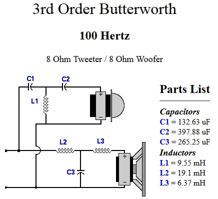

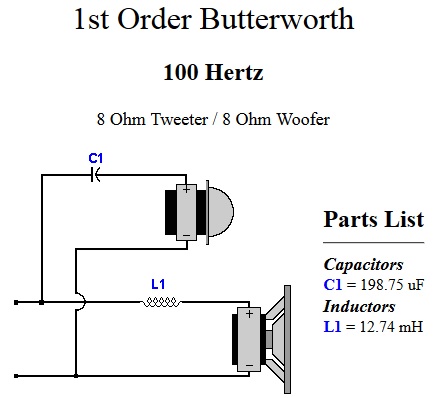

1) I don't really understand the benefits of and logic behind the various "Butterworth" designs. Based on two drivers which effectively approximates to what I want to have, I have worked out that a 1st order Butterworth uses just an inductor to stop high frequencies reaching the bass driver and a capacitor to stop low frequencies reaching the mid/tweeter.

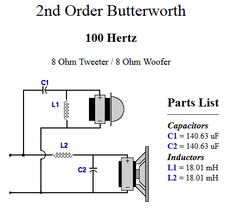

A 2nd order Butterworth uses just an inductor in series with the bass driver and a capacitor in parallel with it and in order to stop low frequencies reaching the mid/tweeter it uses a capacitoir in series and an inductor in parallel.

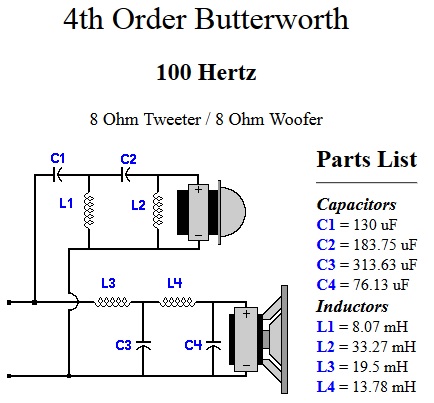

I have also looked at 3rd and 4th order Butterworths and they use greater numbers of capacitors and inductors configured in much the same way. I have included below some sample designs taken from the DIyaudioandvideo website.
1st order 100 Hz.jpg 2nd order 100 Hz.jpg 3rd order 100 Hz.jpg 4th order 100 Hz.jpg
I would be really grateful if someone could explain in Noobie's terms how the various Butterworth filters work and what the effective benefits are of the different "orders"?
2) taking the 2nd order Butterworth design as a basis I get the following values for the Capacitors and Inductors:
100Hz - C1 & C2 = 140.63 uF and L1 & L2 = 18.01 mH
150Hz - C1 & C2 = 93.75 uF and L1 & L2 = 12.01 mH
200Hz - C1 & C2 = 70.31 uF and L1 & L2 = 9 mH
300Hz - C1 & C2 = 46.88 uF and L1 & L2 = 6 mH
Do the fractional parts make any significant difference? In the first instance would 140 uF and 18 mH be satisfactory?
Are Inductors of these values actually available? I believe that on can achieve the correct value by combining components but I am not sure whether it should be in series or in parallel?
Finally, will my plan actually work? Does it make sense?

The first order is the only "sum to unity" type of crossover, which gives better waveforms, but requires drivers
with wider bandwidths, because of the slower slopes. The fourth order is considered the best type overall by most.
You want reasonably close tolerances on the parts, as well as good channel to channel matching. Examples of parts:

.....................1) I don't really understand the benefits of and logic behind the various "Butterworth" designs. Based on two drivers which effectively approximates to what I want to have, I have worked out that a 1st order Butterworth uses just an inductor to stop high frequencies reaching the bass driver and a capacitor to stop low frequencies reaching the mid/tweeter.
View attachment 483225 View attachment 483226 View attachment 483227 View attachment 483228...............
passive first order crossovers are very tolerant of small errors in component values (tolerances).
As you increase the order of the filters from 2nd to 4th, the errors multiply and the resultant filter+driver is very intolerant of typical component errors.
High quality manufacturers will measure every driver and every critical component in their inventory. Then use a computer to select the components to the drivers to get good "pairs" that match each other AND get an overall performance that meets their tolerances.
This difficulty with using normal components limits us to first and second order passive filters, unless we are able to measure and adjust each drivers output to match "OUR" specification.
Forget passive 3rd & 4th order filters.
A filter has a few quite onerous conditions to work as predicted/expected.
The Source impedance should be near zero ohms, quite easy to meet with SS amplifiers.
The load impedance should be infinitely large. This is impossible to meet with normal 4ohms and 8ohms drivers.
Instead we adjust the filter to match the actual load impedance and that brings in a further condition. The driver impedance must be constant over a wide range of frequency around the filter turn over frequency.
This requires a lot of skill on the part of the filter designer to meet. There are tricks that help get the first or second order filter to work as expected/required. It is not easy for the high pass filter, it is a little bit easier for the low pass filter.
Using an active filter for the bass only driver's low pass and another active filter for the satellite's high pass filter is a much easier solution.
