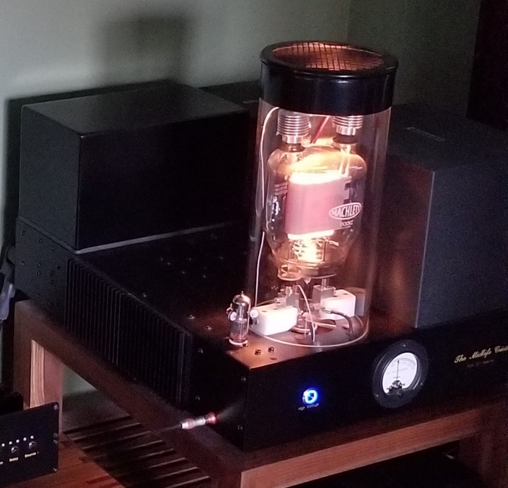

The 833C transmitter tube makes a great set of SET mono amps. Took me a year to complete and $10K+ about 10 years ago. Still making beautiful music. Plate voltage 2300V, plate current 160mA, power about 200WPC, The first 40W in Class A1, the rest in A2.

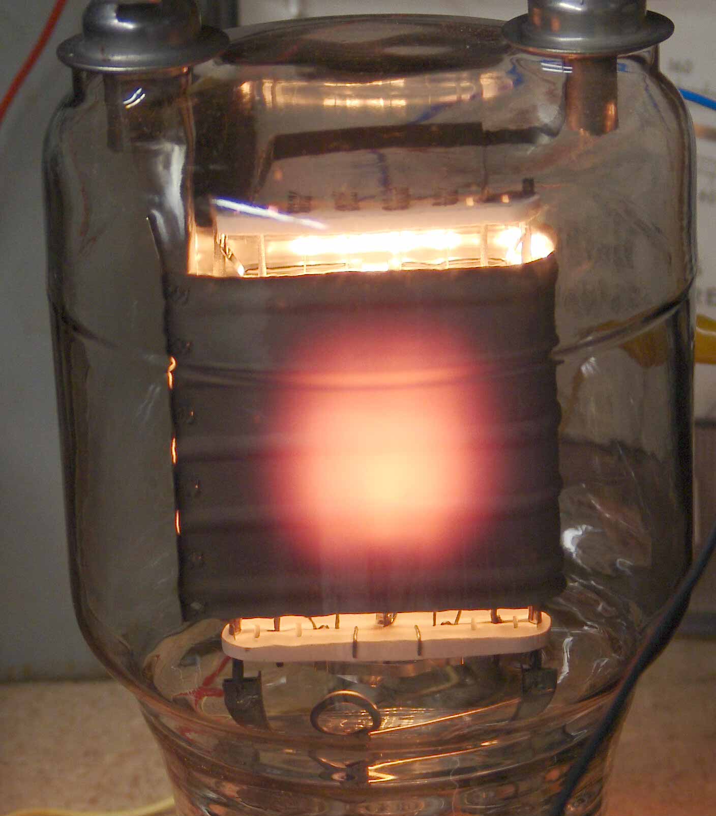

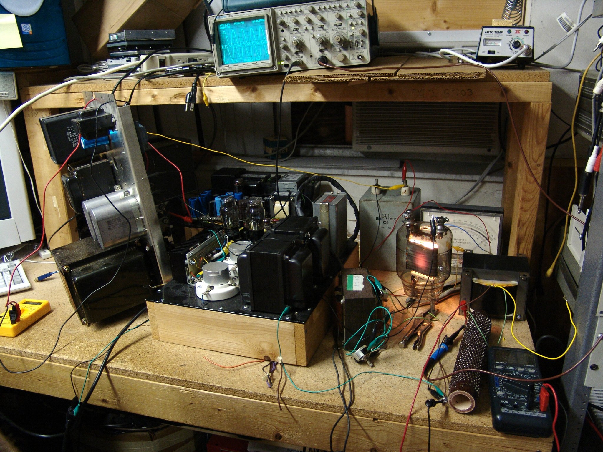

Here's the DUMM BLONDE's clip lead version of an 833A SE, it did do about 200 watts on 1500 volts at 270 mA, and survived several days of my lousy guitar playing. NO, DON'T TRY THIS AT HOME. Note the 1/4 inch thick Lexan blast shield between me and the "test circuit." This "rest" only existed for one week back in 2003.
The metal cased 3CX1500A7 poses more mechanical mounting and cooling challenges since the case of the tube is the heat sink for the plate and is electrically connected to it. It also requires a considerable amount of forced air cooling, though that can be reduced considerably if operated at power levels similar to the 833A, which was 400 watts of idle dissipation in my test amp. More current did not produce any more power, and I didn't have any more voltage to apply.
The 3CX1500A7 has a Mu of 200 which will impart a pretty high plate resistance, requiring a pretty high impedance OPT. The real purpose of my clip lead monster was to test a one off custom OPT that was built for me by Transcendar. The OPT as received would have needed a bit of feedback to get HiFi like specs, so the project died 20 years ago and the tubes, OPT and power transformer still sleep in a box on the shelf. The Mu of the 833A is 35, quite a bit lower than the 3CX1500A7. I would say that a HiFi spec OPT for the 3CX1500A7 at a sane (around 250 watts) power level would either be impossible, or cost as much as a Corvette!

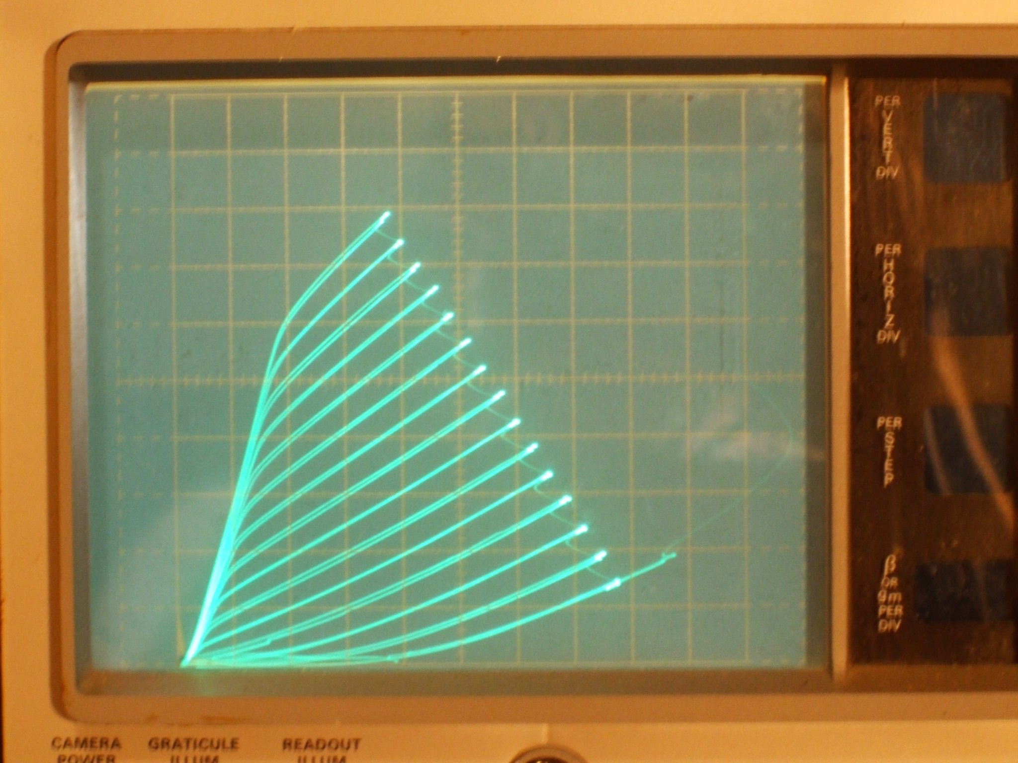

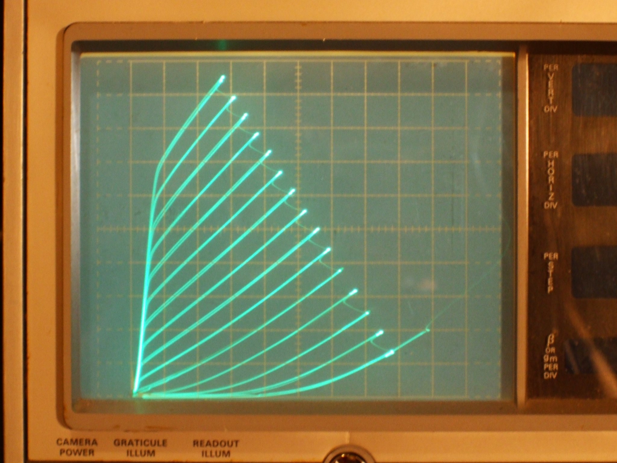

6HZ5 Beam triode, like George mentioned. 100V/div. Horiz., 20 mA/div Vert., 0.5 V steps, 4th curve from bottom is 0 Vg1, about 5000 Ohm Zout.
gm 55000, mu 300.
The curve tracer has a string of ferrite beads on the grid1 lead to trace this. Could use paralleled tubes in P-P with an 8K OT. This tube (1st tracer pic) is one of the uncommon beam triodes with actual flat plates. 2nd pic is the more usual beam triode type with the Barkhausen type plate (vertical box in plate edge, it's actually missing the Barkhausen plate inside the vertical box.) Needs more plate V.

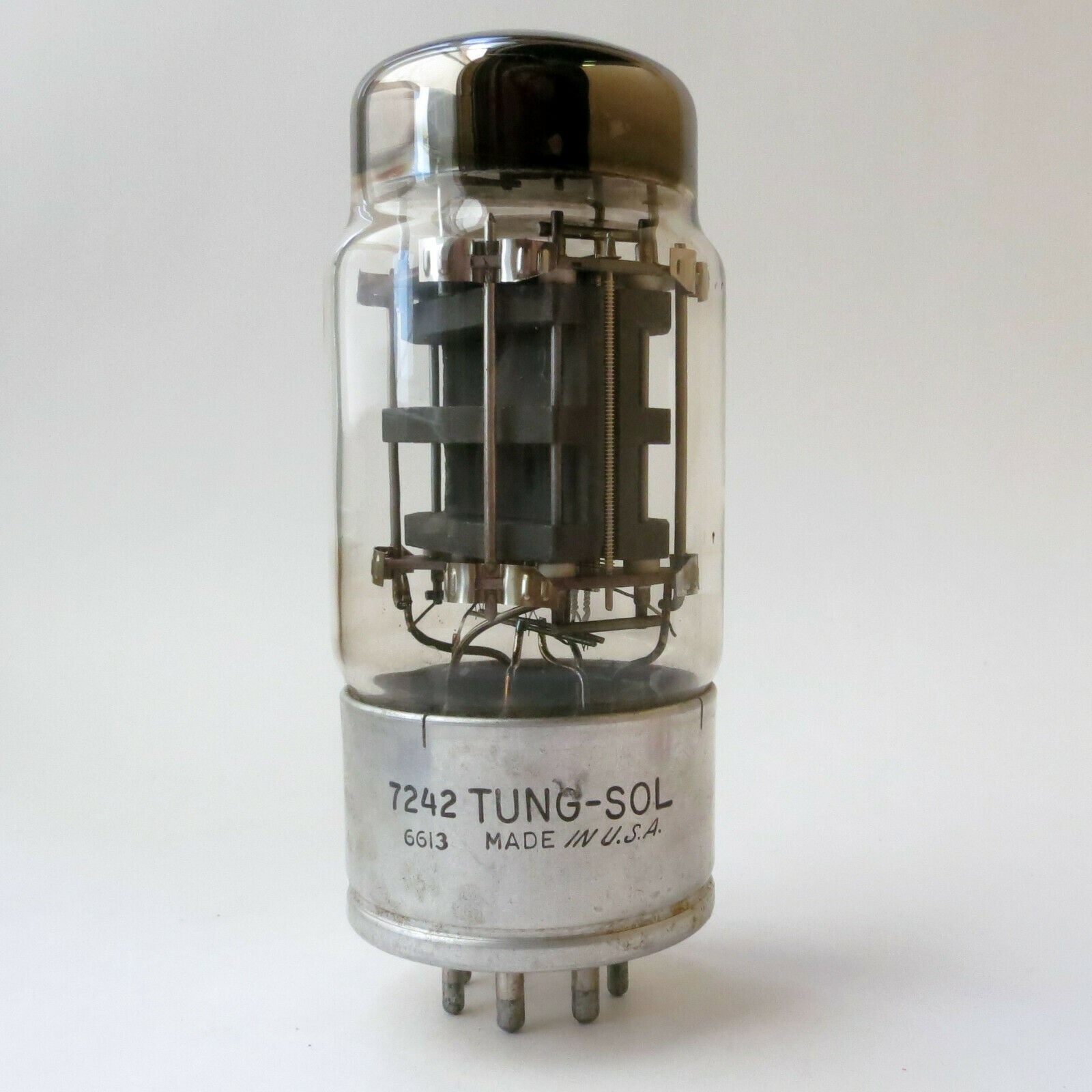

3rd pic. My kind of output triode tube. 7241/7242 Zout 67/82 Ohms !!! Low plate V, Amperes output. Kinda expensive compared to the big sweep tubes though.

I have a 7241 here, off of Ebay, $50. (next one up was $950, guess I won't find another one for P-P soon ) My 36V, 12 Amp bench supply, for difficult heaters, can't get this monster heated up, The clip leads get smoking hot and it needs more than 12 Amps to get it up over the initial surge current. Can just make out the filaments starting to glow. I do have a 0-7.5V 130 Amp 1000 W bench supply in the basement, have to dig it out now, with some heavy wires and battery clips.
