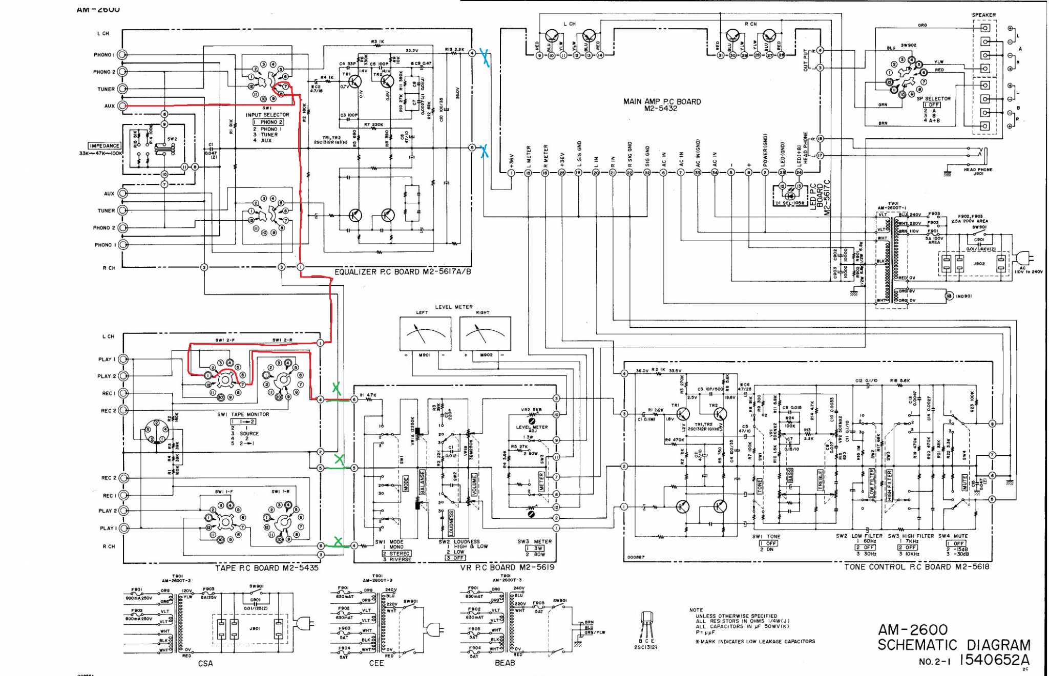

I've been trying to fix this Akai AM2600 for a while, but I just can't seem to figure out the issue.
The thing is, the amp was run with blown fuses for a while (by inexperienced people), so all the power going to the speakers came from the preamplfification/volume control circuitry.
Ever since then the amp has been humming at 50hz
I can turn down the volume using the volume knob. With the knob all the way to the left (off) the humming is gone.
I've drawn the path the audio takes from the aux input, to the volume knob PCB in red.
The lines marked with a green 'X' are lines that I have disconnected. Whenever these lines are disconnected, the humming is completely gone. Meaning it has to come from either the Equalizer PC Board (weird name, it doesn't equalize?) or the Tape PC Board.
The audio signal doesn't pass through any active circuitry on these PCB's however, so I've been left wondering where the hum could come from
I've also disconnected the lines with the blue 'X', this didn't change anything however.
Does anyone have ANY clue as to wat might be going on here?

The 2 main 5A fuses were blown (bottom of the schematic, CEE part). These supply the + and - 50V rails for the main output. Meaning the main transistors could't output anything.The thing is, the amp was run with blown fuses for a while (by inexperienced people), so all the power going to the speakers came from the preamplfification/volume control circuitry.

The 2 630mA fuses weren't blown however, meaning the preamp circuit still had power
The very little power that did go to the speakers, must've come from the preamp circuit. To be fair, it wasn't much power, and the sound quality was VERY bad. But there was some sound, which was supplied by the preamp circuit, because the main transistors didn't have any power supply.

Do I surmise correctly that the power amps now operate correctly?
Do you get working audio from AUX input but with hum in background? If audio path passes signal, how severe is hum?
Same hum problem from any input? Same hum in both channels?
Does the ground path at pin 5 "X" have to severed to stop the hum?
I don't really know how or why, but I ended up desoldering and testing some stuff, and after a while the hum went away.

Let me guess that next time you power on (wait until tomorrow) that hum is back again. So it could well be time to replace all the 40+ year old electrolytic type caps because electrical faults in components don't fix themselves. Plastic film caps may "self-heal" to some degree and sick electrolytic caps may work better when warmed up but that isn't the same as restoring or making them like new. Replace them with equivalent grades and types. Note that there are a number of only 10V rated solid aluminium caps in the signal path - these are easily damaged by tinkering about with testing them. Test out of circuit.
