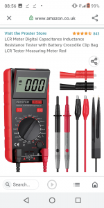

I never had a case were I really needed absolute precise values. Usually you compare some values for matching or coarse identification.
Even these component tester without a real enclosure work quite well.
With these you can match LCR to less than 1%. For HIFI this should be fine.
