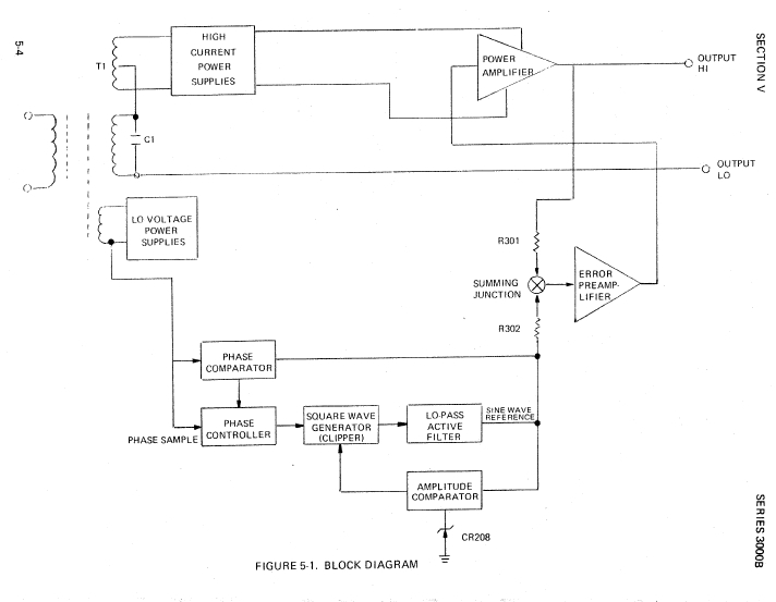

Here's a picture of the Elgar topology. As you can see, a buck-boost amplifier sits atop the 120VAC transformer output. The capacitors bypass the supply electrolytics for this amplifier.
Here's a question. Why wouldn't the spike appearing in the pictures be removed by the reference sine feedback?
In any event, the amplitude of the spike is decreasing, which is the salient point for this discussion.
Kevin, I would suspect capacitor burn-in relates very probably to quantum changes in the dielectric. Alternatively, could be a neutralization of static charges on the surface of the dielectric.

Now had you talked about parameter shifts in the error amplifier, or a reduction in cross-over distortion in the floating amplifier due to dropping vbe as the devices warmed up that would have added something to the discussion. (I bet class B output stage, its what I would probably do too.)

One of the ways to verify whether or not that spike is cross-over distortion in the output amplifier is to shut it off for a day, allow it to completely cool to room temperature and then repeat the experiment, if indeed the capacitor experienced a break in related parameter shift the spike should not reappear when the conditioner is repowered.

Kevin, neither the existence of the spike nor its amplitude and shape is a product of warmup: the spike appears as soon as the unit is powered up, with the same amplitude as when the unit was last shut off. For instance, I ran the unit for several hours after first installing the capacitors, during which time the amplitude of the spike decreased about 50%. During this time I had turned the unit off then on, briefly a few times. It always restarted with the same spike amplitude, or thereabouts, as when last turned off. I then turned the unit off during the evening after the first day of running it with the new capacitors, and left it off overnight. When I turned the unit back on the next morning, the spike was the same shape and amplitude as when I turned the unit off the previous night.
The reduction in amplitude seems therefore permanent (ie, chemical, or something).
