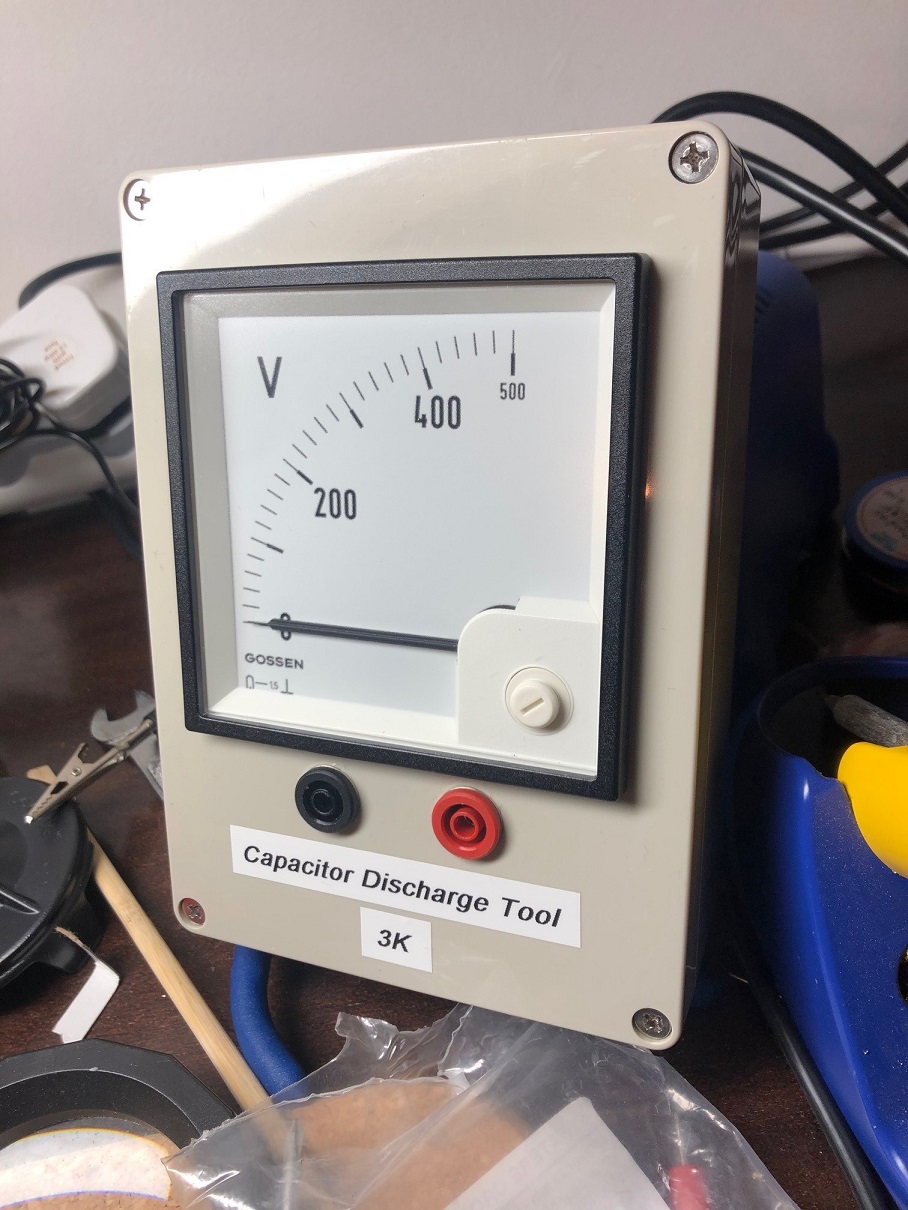

What do you guys think of my handsome new capacitor discharging tool? 😀
Nicely done. The meter is a very useful addition.
FWIW, I don't like using wire-wound resistors for this application. It's better to use a big carbon-comp resistor (or a "carborundum" resistor). They're less likely to go open.
I never trust bleeder resistors. You always want to add them in your designs, but trusting the system to discharge itself is foolish at best.
Even with a discharge tool, I like to verify with a multimeter, just to play it safe. With lower voltage caps it's less of an issue, but with caps charged to 800V, take no chances.

But we need another useful tool for low voltage, high capacitance caps as 3k is gonna take hours to discharge 100mF @100v. And screwdrivers don't last very long. Waiting for a group buy with bated breath.

Hi. I did use 3 1K wirewound resistors in series, but they are 10W each. The meter is in parallel with the resistors so if one of them goes open, you will see the voltage accross the cap not moving.
All of this might feel like an overkill (you obviously don't need big resistors for a very transient current) but it will lower the risk of one part failing on you and leaving your cap dangerously charged. A single bare resistor handled by hand or an incandescent light may both fail without notice and you may have no way of knowing it before it's too late.
