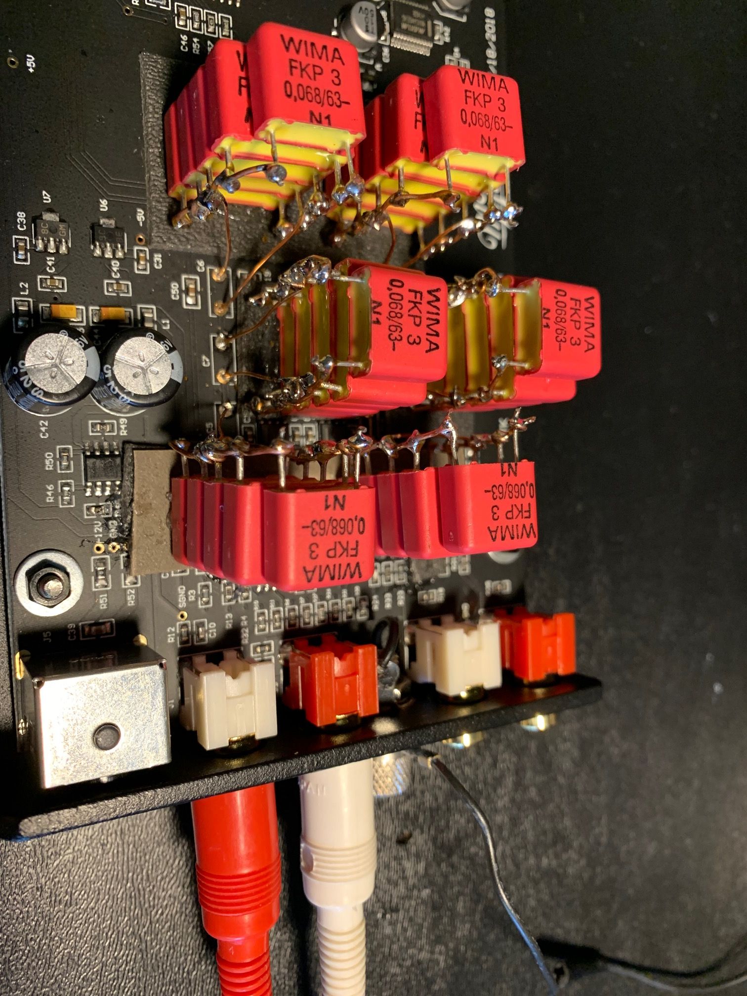

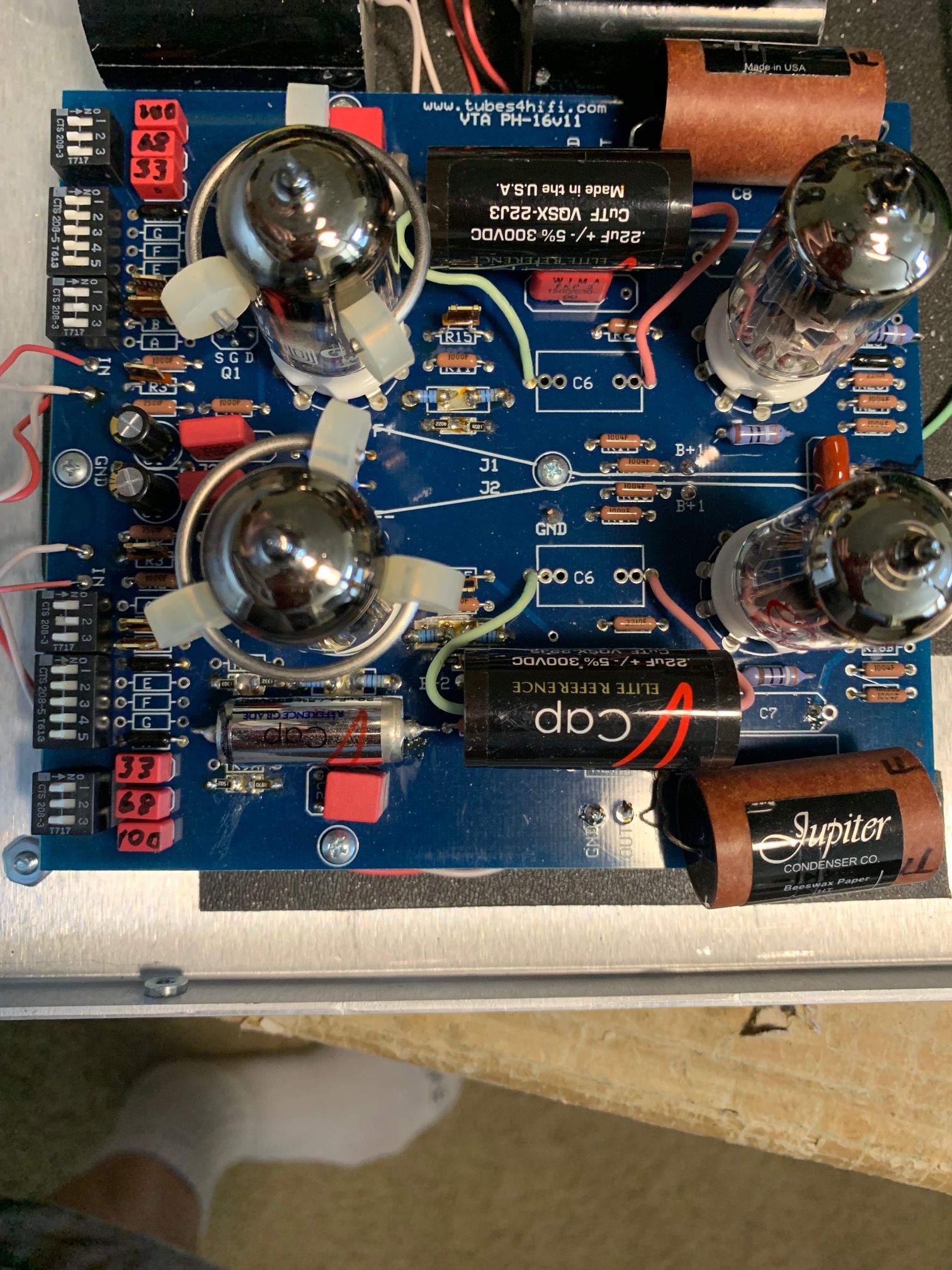

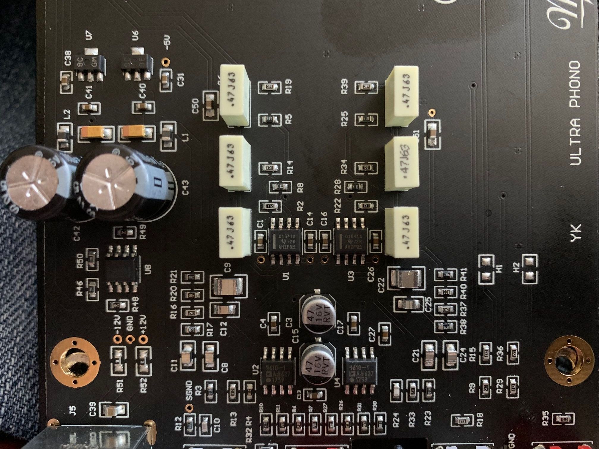

The best sounding inexpensive and small coupling/feedback caps I have used are WIMA FKP series film and foil caps. I recently upgraded a MoFi Ultraphono preamp by replacing the polyester caps with WIMA FKP3 caps which I had to stack to get the right value. After break-in, it sounded as musically pleasing as my Tubes 4 Hifi PH16 phono preamp with Odam's, V-Cap CuTF's, and Jupiter copper foil's in the 3 RIAA/coupling positions.
The V-Cap Odam film caps are my favorite not-too-crazy-expensive caps. These are also smaller than other boutique caps.

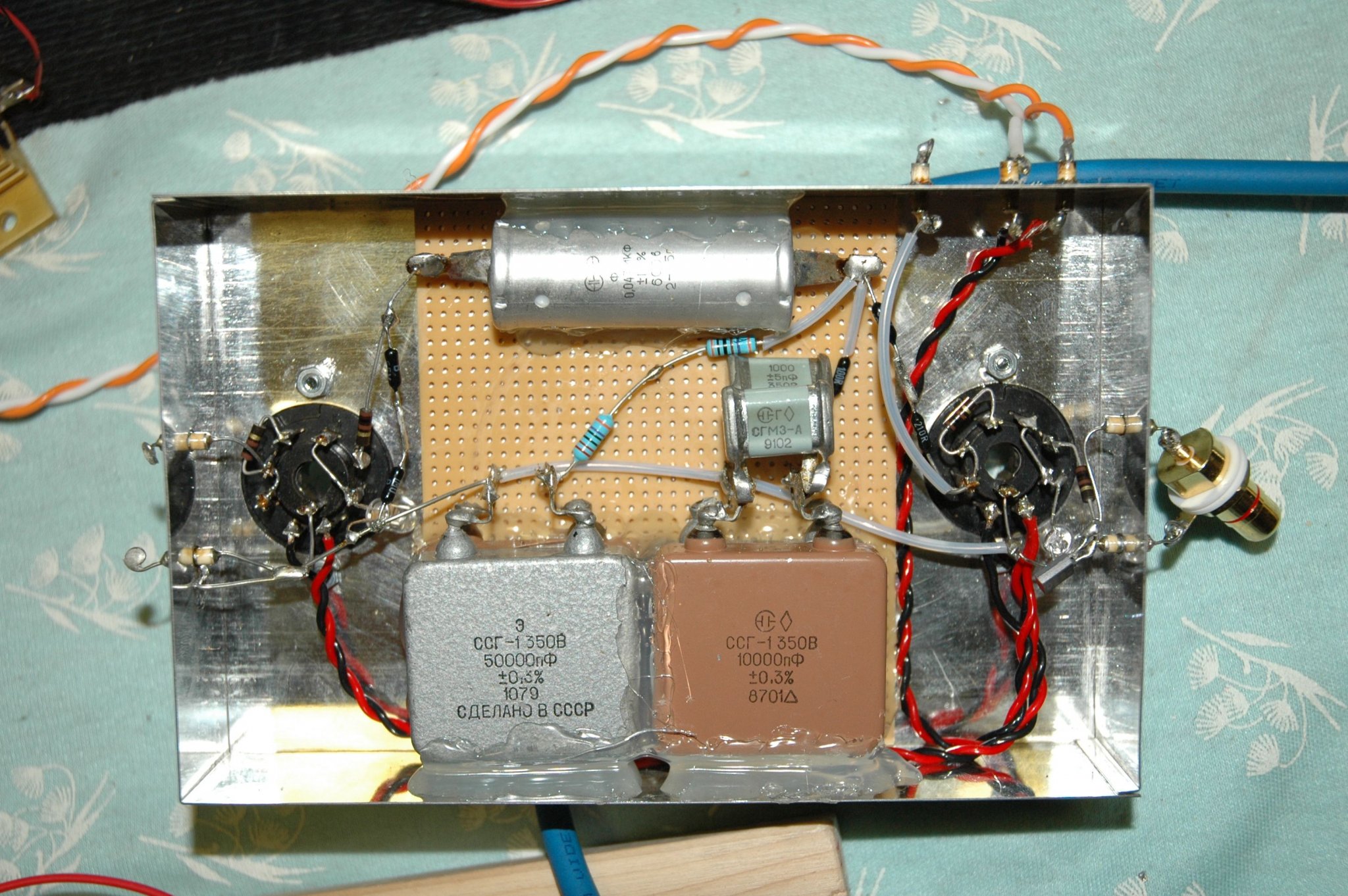

If you have enough -large- buildable area the old soviet silver mica (SSG series) anf FT teflon capacitors also a feasibility.
Sample: RIIA parts of C3g phono (SSG-1 silver mica, FT-2, FT-3 teflon capacitors, RC55Y resistors). The PSU capacitors are Philips (now Vishay) BC series.
Sadly nowadays the silver mica capacitor price is horrible.
