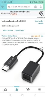

Hi Mark, sorry I'm back again! I tried that lead I posted above from Amazon but it cuts out intermittently. I'm therefore still thinking of getting the Q11 (even though I won't be using its DAC) but how would I connect between Toslink on the DSP to the Digital Out on that Q11? Everything I'm looking at online seems to refer to optical out on the 3.5mm jack but even with a Mini Toslink connector that won't work/fit into a 3.5mm jack will it?You could use the SPDIF output on the Q11, but why use Q11 at all? The dac for AP-F8.9-bit will always have to be in the one inside it. There is no way to use a different dac to make it sound better.
There are optical adapters that plug into the 3.5mm phone jack. The end of the adapter that sticks out has a TOSLINK connector. If you need SPDIF then there are little wall wart powered TOSLINK to SPDIF boxes that accept TOSLINK input and output coaxial SPDIF.

Many Thanks Mark really appreciate it.
Problem I have is a lot of the ones I'm looking at appear to be for home use and not car use, as this one for example comes with a Multi Country Plug.......
https://www.lindy.co.uk/audio-video...55-QlywT-_23VwbVt_Sj8bMaUnDUZoDhoCfjIQAvD_BwE
I've purchased that other one further above that I posted off of Amazon and returning it as it's cutting out and crackling, and therefore would rather get a branded one from a good company from the likes of FIIO etc in the form of a DAC Dongle if there is anything like that available?
At the moment the only option I can see would be to spend out £130.00 on the Audison C20........?
https://www.cen.uk/audison-bit-c20-...D8bJ_4fGHaQsnCTioQ3BmI-ePHy2mZoxoCEfYQAvD_BwE
