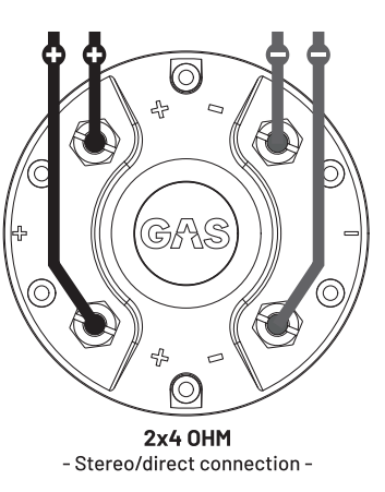

Finally, to return to the sub, I found one that interests me strongly in view of its price, but especially that in the manual there is an instruction (screenshot support) to connect it in stereo (which I did not find in the manual of its lower version the B1 210):
Sub in question: GAS Mad B2 210
It is therefore a 600W RMS, or 2x300W RMS.

Your wiring options for it's two 4ohm coils are series (8 ohms) parallel (2 ohms) or two 4ohm coils to two separate amp channels as depicted in the "stereo/direct" connection.Sub in question: GAS Mad B2 210
If the input of the two separate amp channels are stereo, the coils "fight" each other with any stereo information.
There actually is quite a bit of stereo low frequency information in most recordings, so not a good idea to combine stereo LF in one driver.
The TN4 900D amp does not support 2ohm bridged (two 4ohm coils in parallel) operation, which would be equivalent to a 1ohm load on each channel.Amp: TN4 900D

You are right, but the GAS Mad B2 210 has two separate drivers, thus "stereo" connection won't be a problem and TN4 900D can power it fine in 2 bridged channels config.so not a good idea to combine stereo LF in one driver.
The GAS Mad B2 210 has two separate voice coils, which if connected to a stereo source may fight each other if connected like Ozo suggested

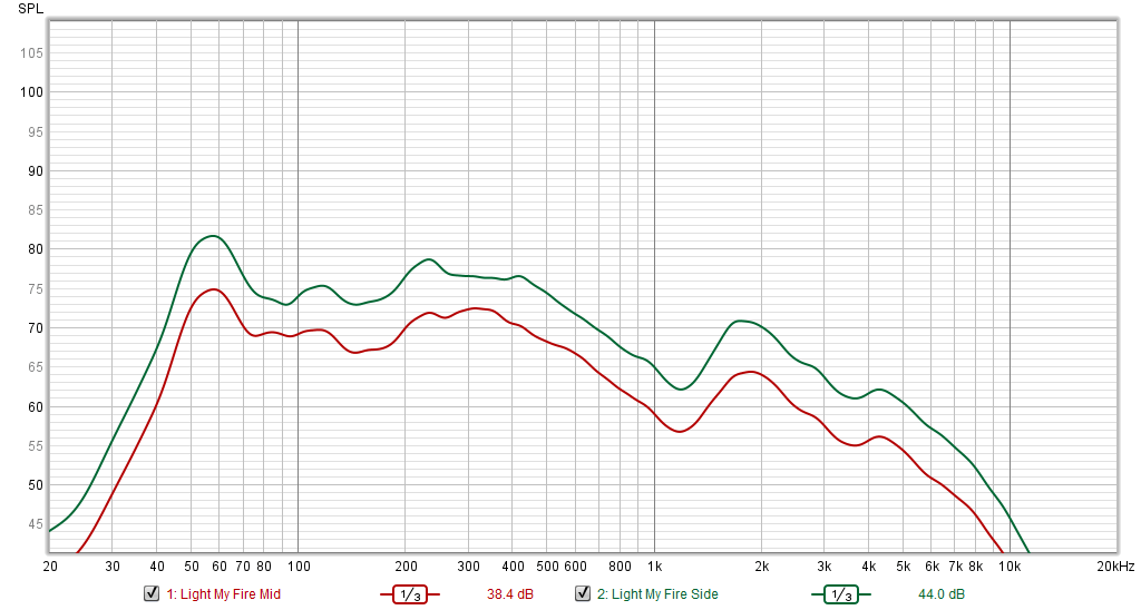

when stereo information is presented, as it often is, as can be seen in this thread:
In the above example, half of the ~6dB difference in bass between channels would be converted to heat, and the bass that should have been heard from one side would be ~3dB less due to the other voice coil resisting the movement.
Here is my take on Light My Fire. It's a very stereophonic mix. You can see that it's consistently about 5.5dB more side than mid, all the way across.I played a bit with Light My fire,

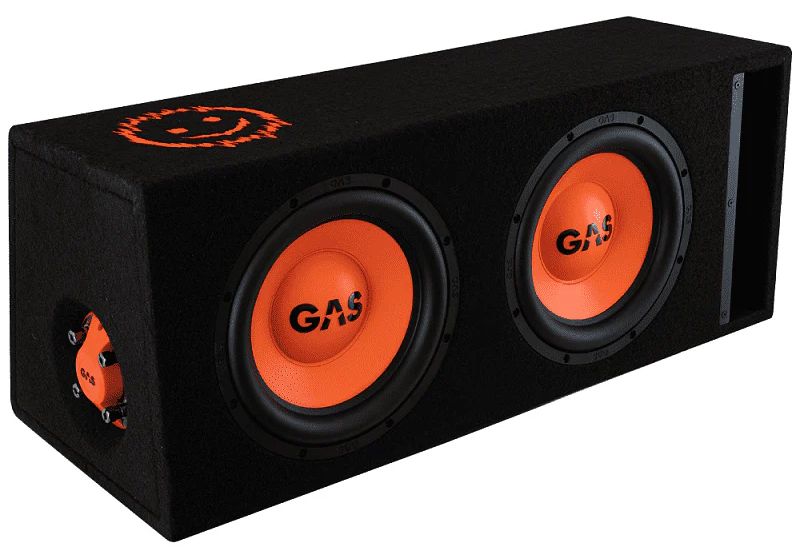

If two separate drivers are used for stereo bass the difference information is not a problem, both drivers are free to follow the electrical input.the GAS Mad B2 210 has two separate drivers
This is what google offers me for the query GAS Mad B2 210 - box with two drivers)
In bridged 2ch mode TN4.900D will deliver same R+L signal to both drivers - "mono bass".
If (for some reason) owner wants a "stereo bass" it's still possible with this amp.
Put it in 4ch mode and use two Y-type RCA cables, right channel to front LR and left channel to rear LR - with same driver's wiring as for 2-ch.
