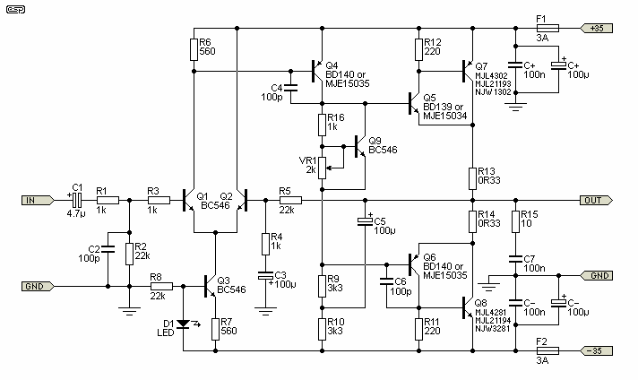

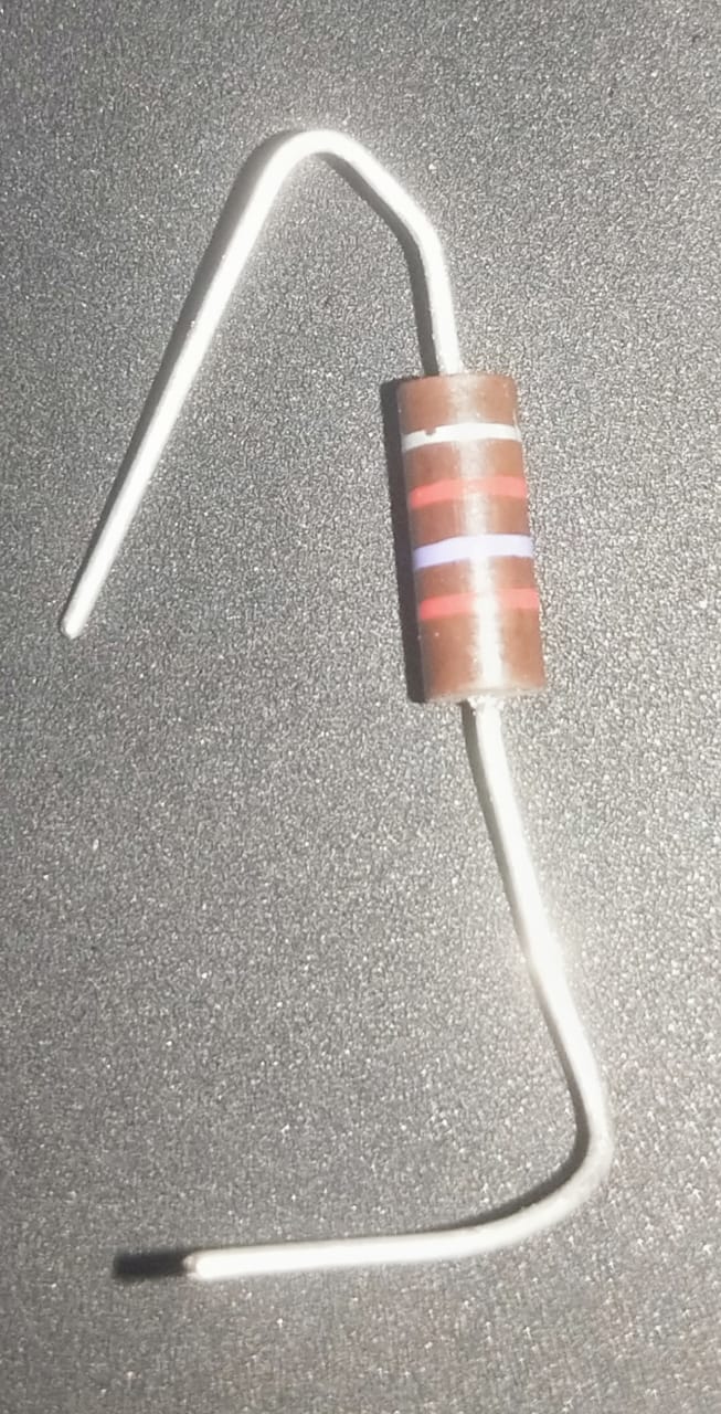

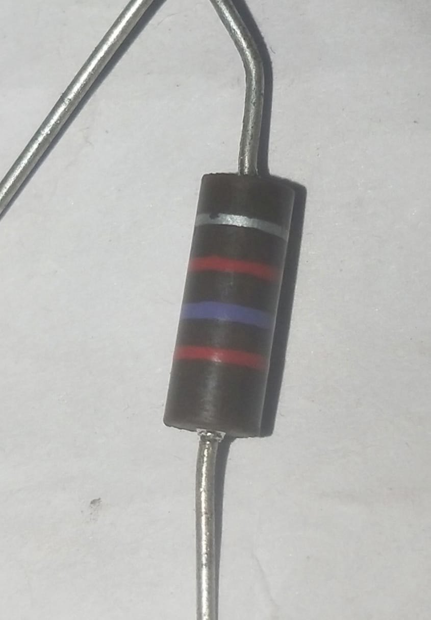

Recently I happened to find some Carbon comp resistors 1/2W rated, I wanted to use them in P3A amplifier circuit from Rod Elliott
Here is the schematic of P3A, R9 and R10 ( which are part of bootstrap)are the resistors I have questions about, will there be any problem with using these resistors,like noise and stability.

I mean, you could use them, but modern resistors would be better and are cheap.

There are ceramic composition resistors on Mouser now which could replace carbon comp if you want something closer to carbon comp but more stable. Expensive though.
