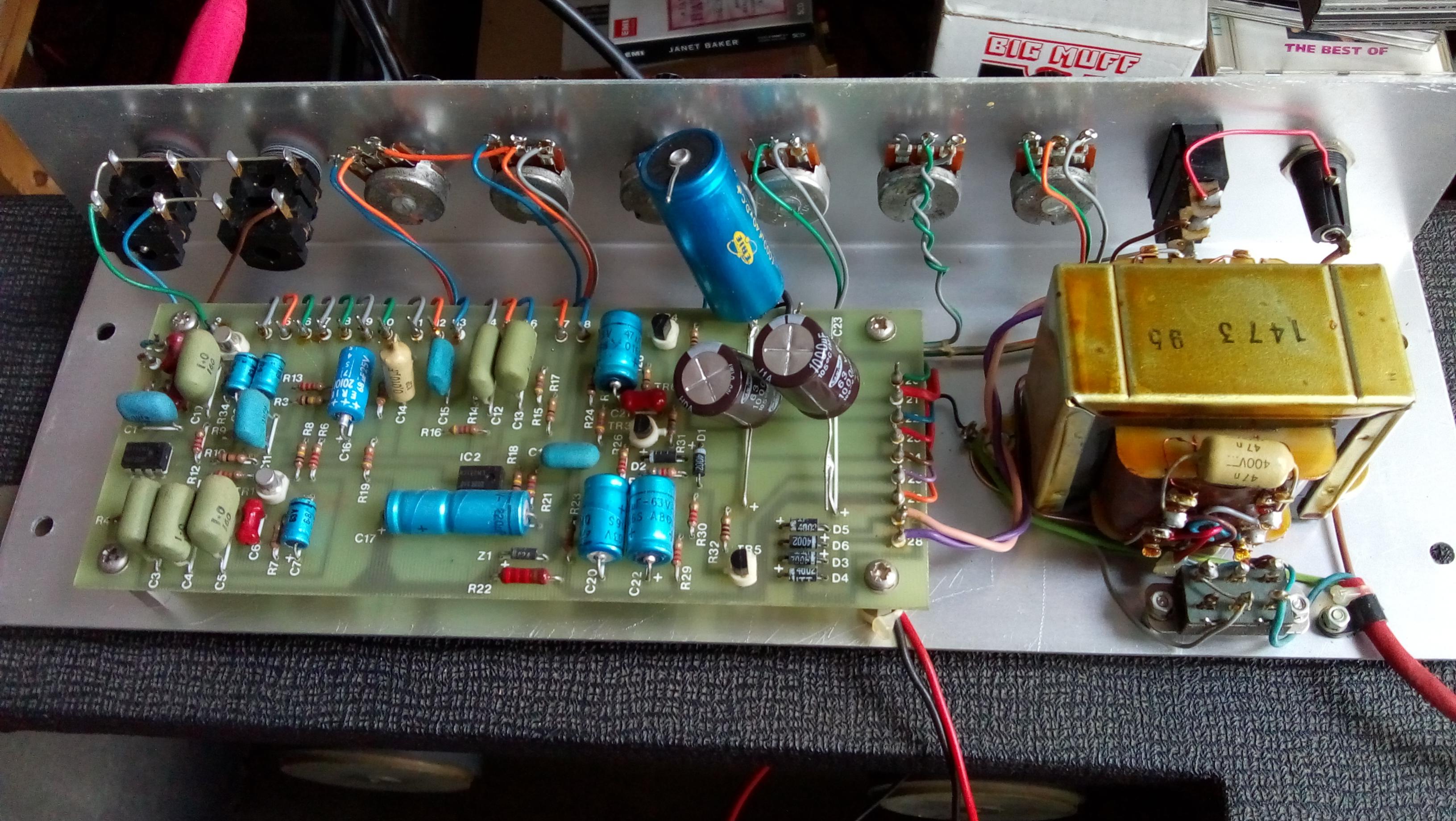

I have a Carlsbro Scorpion amp in a Hornet combo ( I swapped out as they seem to be exactly same amp unit..and I am using the 2 x 12 combo now with Hornet sounding nice). The problem I thought was just caps ..there are 2 big Erie blue ones 1000uF 63 v DC .. one looked 'blown' and I replaced with new of same value for both although other is still working ok. However .. the 'fix' only lasts for 30 seconds approx then original fault comes back which is no sound and when rotating VOL knob a loudish noise. If I turn off amp for about 10 minutes it works again initially for 30 seconds then ....as above....
If anyone knows what fault might be and guide me what else to replace be much appreciated... there are other smaller caps in circuit but all look visually good.
*note the Hornet amp I swapped out had 3 x 1000uf 63v caps instead of the 2 in this one... just sharing this incase it has bearing

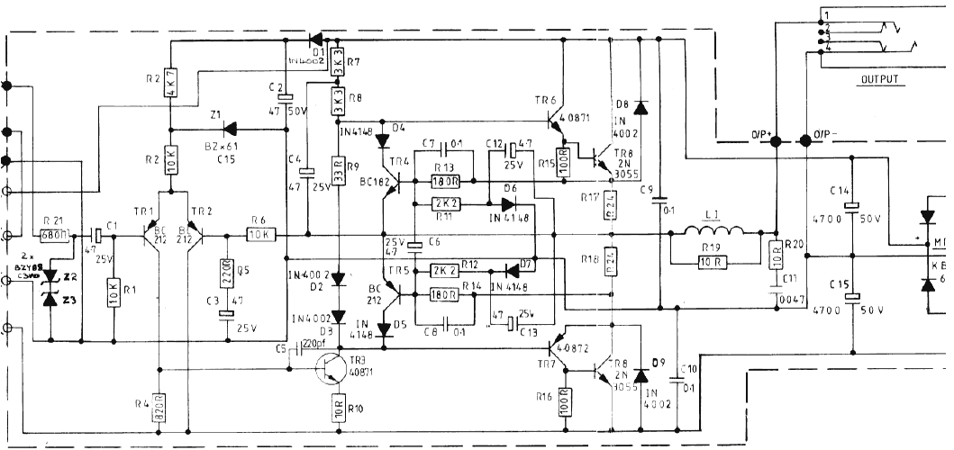

It helps a LOT to have some clue about the amp. There's many ways to skin a cap.

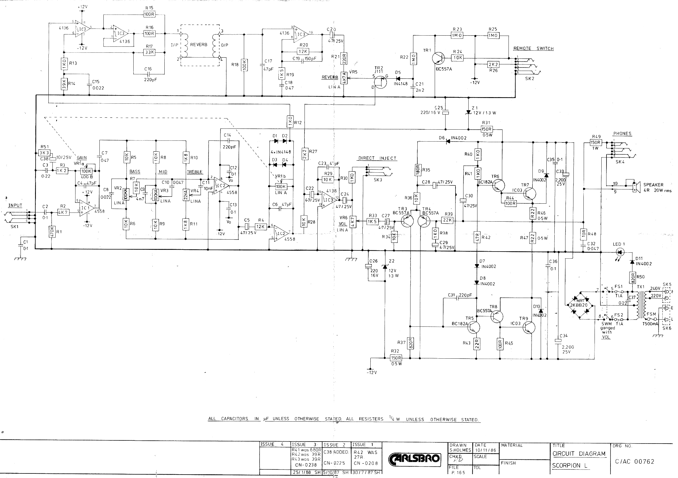

I have found a "Scorpion" with different knobs and maybe power but very similar parts. I've pasted the images and will attach.

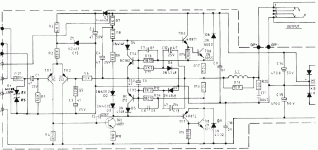

I also find in my scrap-folder a "Carlsbro" transistor amp which is a later/bigger model, only the poweramp.
Differences noted:

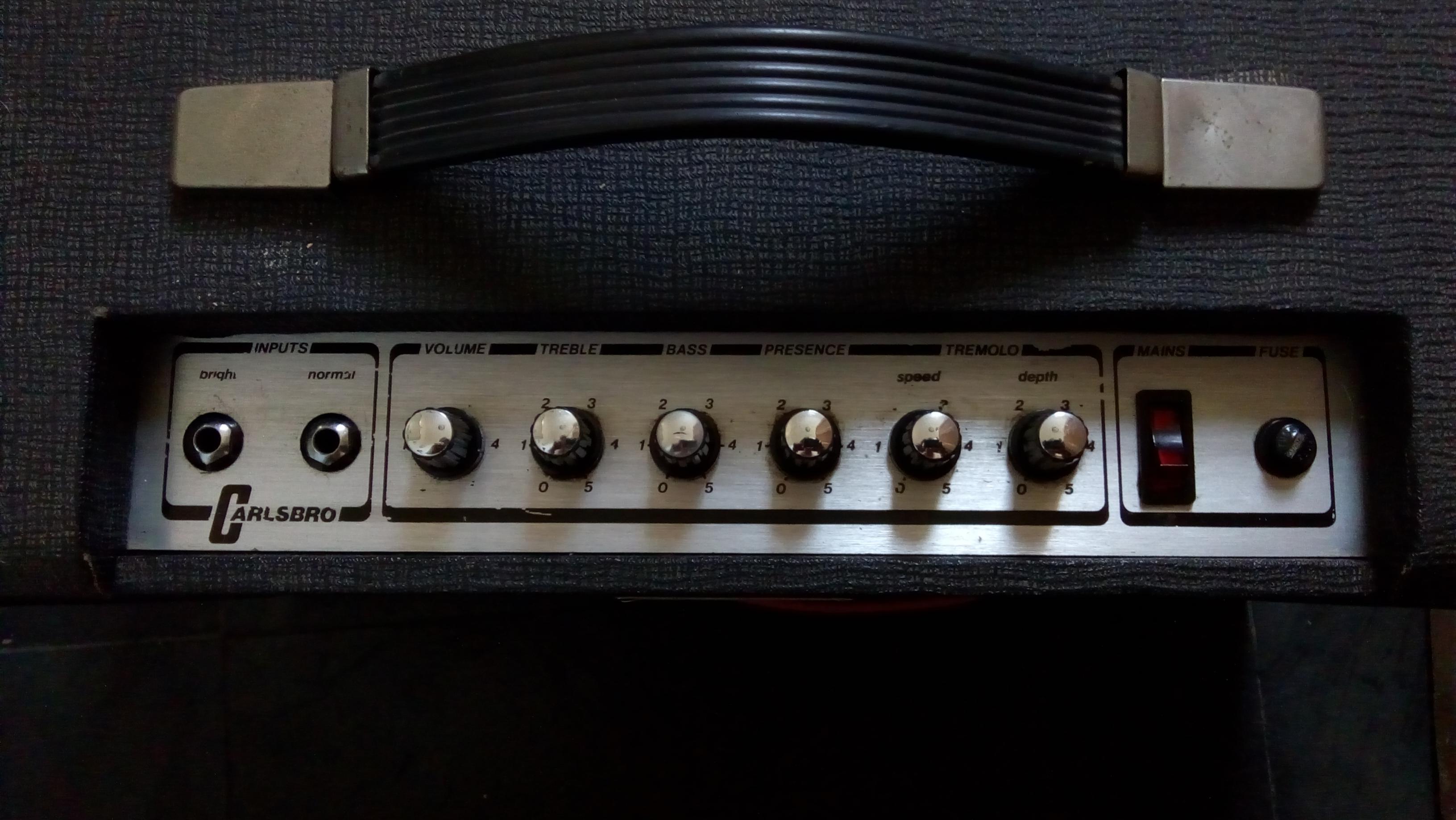

Yours - Treb, Bass, Pres, TRsp, TRde, Vol --- 1000u 40V
His --- Gain, Treb, Mid, Bass, Revb, Vol --- 2200u 25V
There does not appear to be a record of the schematics. The model described is not what it actually is.
Basic fault finding comes to mind here; Does DC appear on the speaker terminals? Does it get hot? Is the power supply to the 741s OK? Does any offset appear on the 741 chips, pin 6?
Could it be a Hornet 45?

Not sure why you left the old dead capacitor hanging in the air with *one* leg soldered ??????
Start with amp OFF, turn it ON with meter set to 200V scale, across speaker terminals ... do you measure any DC voltage there, specially after it starts humming?
Do this test before any other, we don´t want your speaker burst in flames while you measure something else.

To answer JMFahey about leaving capacitor attached by one leg... because that cap is OK and is now fully attached again... to remove without cutting leg meant a hassle unsoldering the circuit board to get soldring iron to that leg.

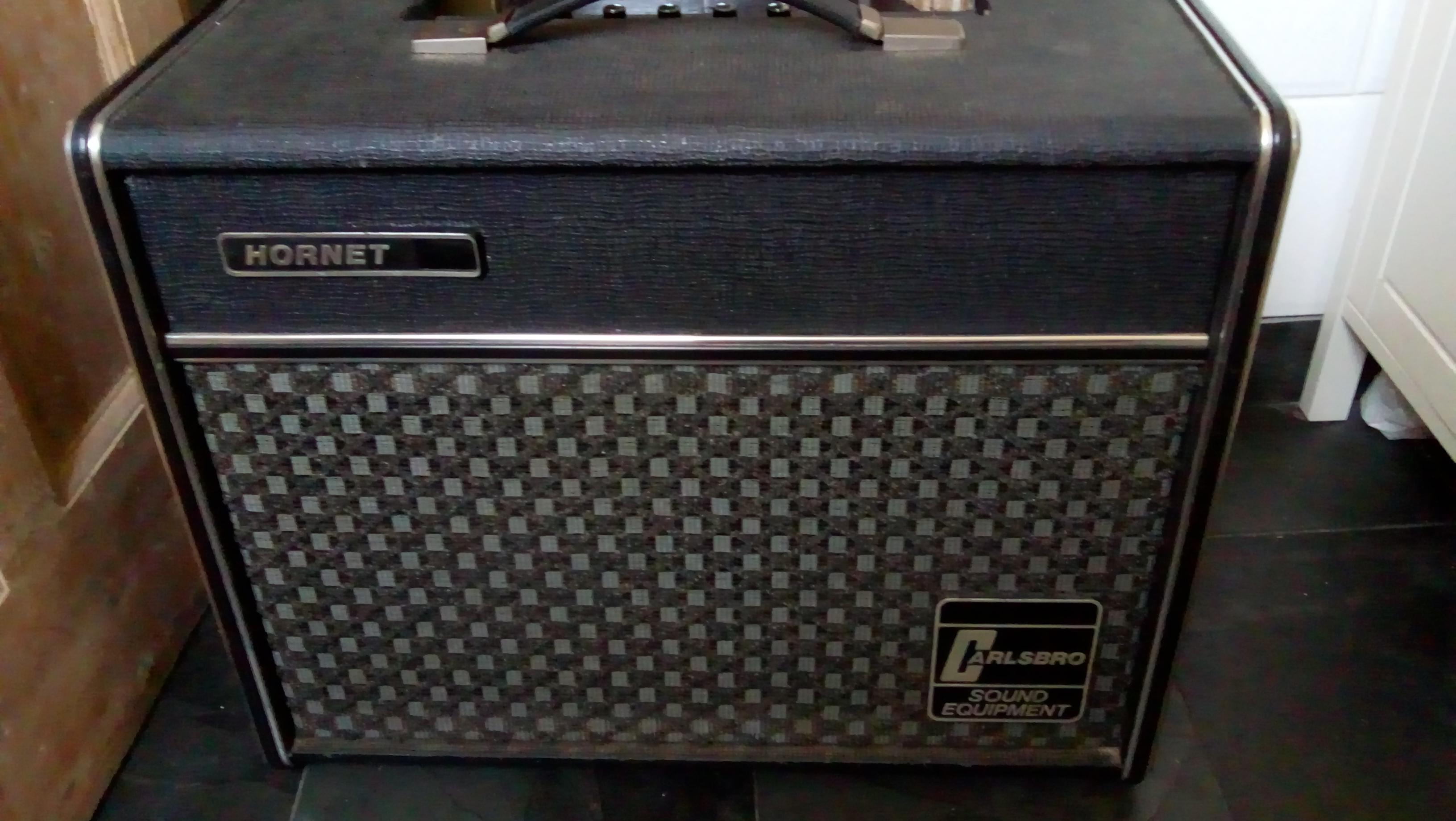

I thought I had made it clear but will state again.. this amp circuit is the Carlsbro Scorpion ( it just happens to be in a Hornet box) but they are basically the same and these amps are the early ones from about 1974 ...not later ones... early ones have vintage looking grey check speaker cloth.
