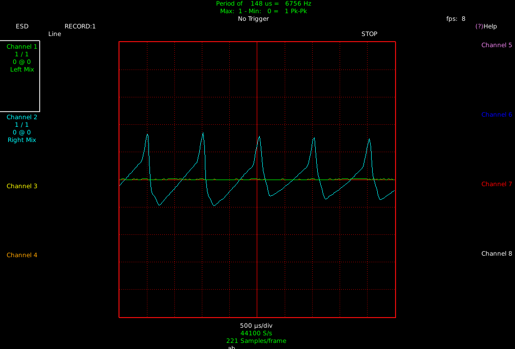

So back to square one, I have 350mVdc at the broken channel speaker output, no load and no signal. The DC voltage increases when input signal's amplitude increases until the point of the protection circuit kicking.

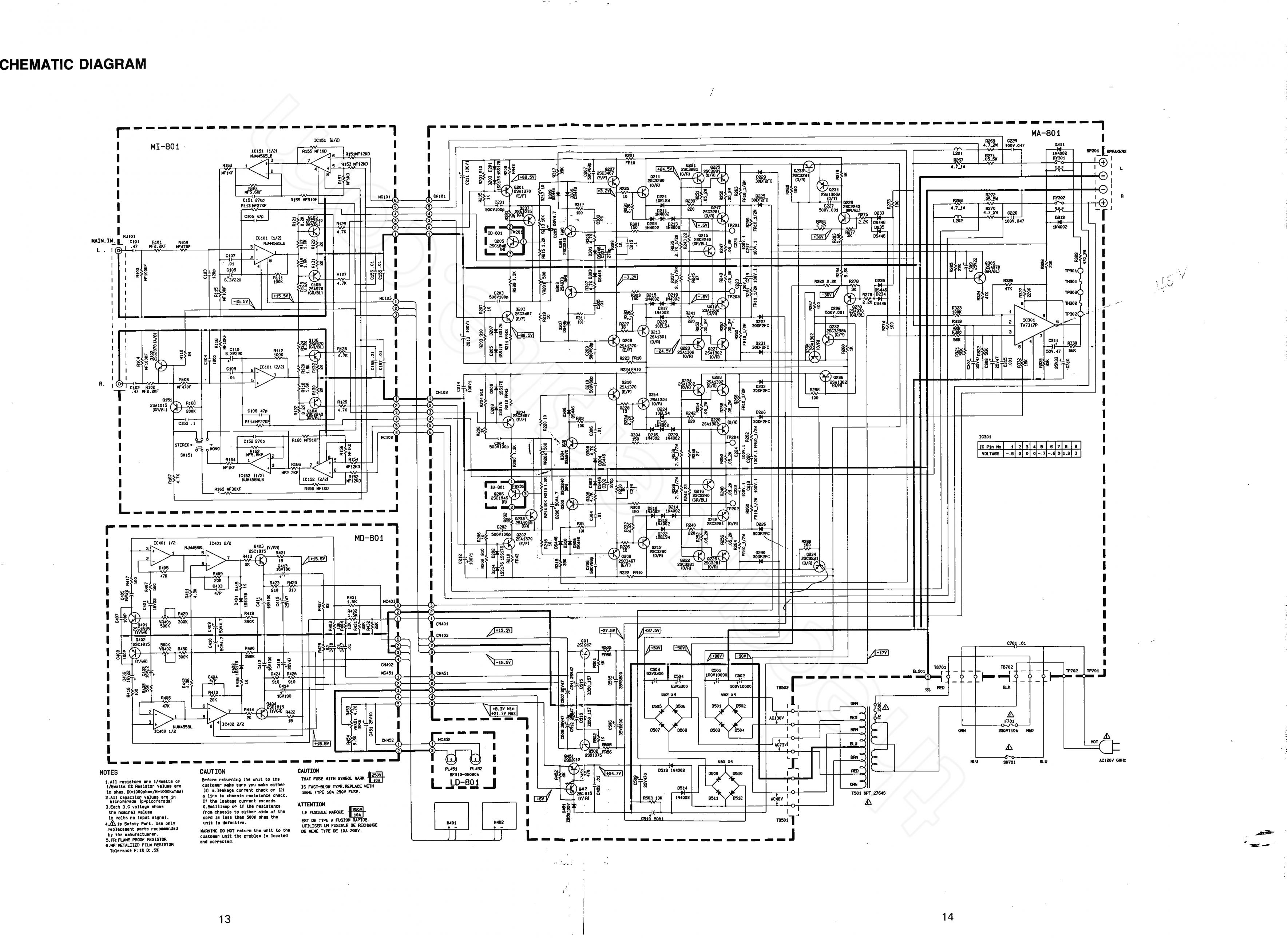

Pin 2 of IC301 is getting increasing DC with increasing input signal and tripping the relay. This pin is also connected to the base Q229 through a DS446 diode (D233) and the base of Q230 through another DS446 diode (D236). Also connected to pin 2 is IC151.
I think I will replace IC151 next and then D233 and D236.
Attached are a schematic and a scope shot of the output of the amp, input is a 1kHz sine wave.
What do the voltages and signals look like on the collectors of Q103/Q105? Should be the same but 180 out of phase. The offset on the output of the IC could be caused by Q103/105 and supporting circuitry.
