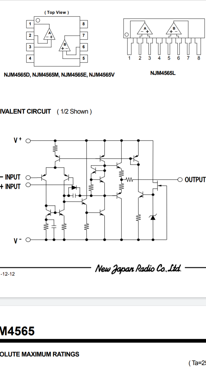

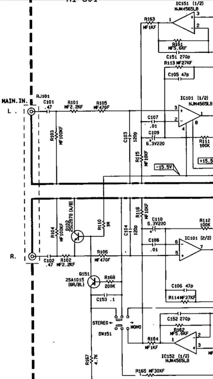

I'm trying to troubleshoot the right channel on this amplifier, the right channel is triggering the protect with a DC offset of -350mv to -400mv. Must be on the border of voltage to trigger as it comes out of protection half the time? Anyway looking at the input IC 101 , I get normal values except at the output of pin7 ( right channel) which reads +14.36 v ? Pin 1 output for left channel is -154mv... Does this indicate a toasted IC or would it be a bad component feeding into it??
Some IC info...
TA7317p pin voltage testing:
Service manual specs: pin1) -.6 pin2) 0 pin3) 0 pin4) 0 pin5) -.7 pin6) -.6 pin7) 0 pin8) 1.3 pin9) 3
Check R118, R120, R122, and R124. The center point of R118 and R120 should be near 0VDC if all is working. Check to see if you have the proper voltages feeding R122 and R124, +/- 15.5VDC. Pins 5 and 6 are near 0VDC? If those all check OK IC101 could be kaput.

Check Q221-228 for shorts. Any 2.7K 1/2W resistors on hand? Any NJM4565s on hand? Pulling the IC opened up the feedback loop and I guess it didn't care for that. If the transistors check OK you can try installing the good resistors in the left channel, reinstall IC101 and check if the left channel is still OK. Are you using a Variac or DBT? You should have no load connected.
