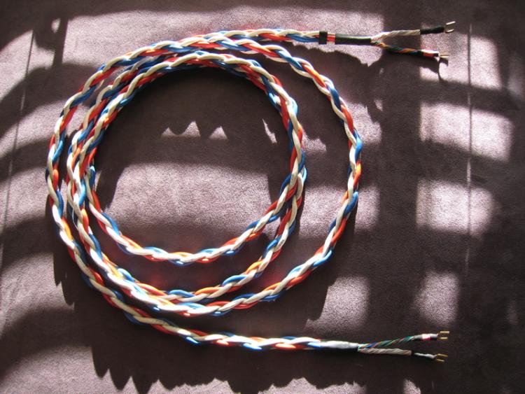

Somebody gave me a spool of CAT3 so that's what I used. Ask around and you might find some surplus CAT3 as well!
I separated stripes and solids and made mine 4 runs braided together for a 12AWG cable.

Like many people, I am of the opinion that any reasonably heavy gauge wire, made of ordinary copper, will work fine as speaker cable. (What do you suppose the voice coils and crossover inductors inside the speaker are made of? 🙂 )
Cat5 Ethernet cable has a resistance of about 30 ohms per 1000ft, so a 10 foot speaker cable made using all 4 pairs of a Cat5 (4 conductors going out, 4 coming back) will have a resistance of 0.15 ohms. This is about the same as cheap "bell wire" and 3 times the resistance of the 1.5 sq mm flexible cord used on 4-way extensions and heavy duty appliances in the UK.
Depending on how the cores were connected, the Cat5 speaker cable could have a capacitance 2 to 3x that of an ordinary speaker cable, but this is unlikely to cause problems with a 10 foot run. The mega cable shown above by Andersonix probably has 10x the capacitance of a simple zip cord of the same length.

My Cat5 cables are are three runs plaited together and at the end
all twisted pairs are paralled. That gives 12 100 ohm pairs paralled
for a nominal 8.3 ohm impedance. YMMV, works for me.
Personally though I'd recommend 5A 4 core caravan / 3 phase cable,
wired as a star quad, opposite conductors for + and -, as the best
DIY budget speaker cables in my experience. Solder tin the ends.
