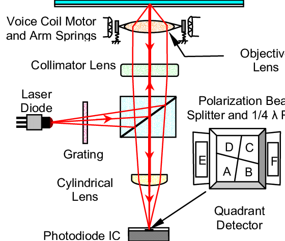

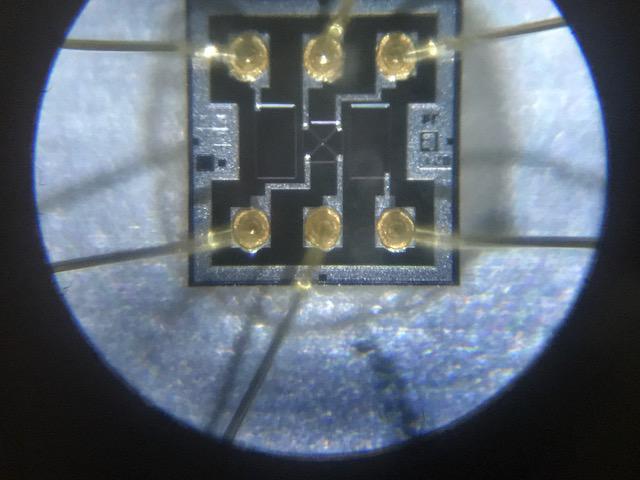

I am trying to restore some vintage cd players but I have problems with optical pickups (most of them are not available any more). So, I was wondering if it is possible to replace the laser diode itself, not the entire pickup. The problem is, that after diode replacement the laser beam fails to locate in the middle of the photodetector IC (also known as PDIC). This IC has (in my case) six photodiodes, named A,B,C,D,E,F. The main beam uses the four(A to D) lacated at the middle, while the side beams use the other two (E,F). How can I align properly this IC in order to pinpoint the main beam into the center?
Any help is greatly appreciated!
