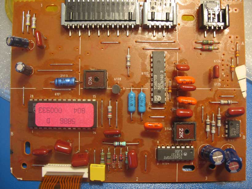

Here is the photo of the servo board (without THE cable)

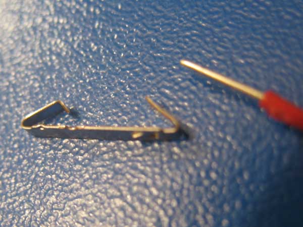

Here is the pic of the wire and connector foot taken out:

Bassivus, this is the connector I am thinking of. The wire goes in unstripped and the v shaped part of the pin is forced over the wire, cutting through the insulation and making contact.

The grey philips connectors can be dismantled, the copper pins have a fork wherein the solid core wire makes contact after pressing the connector parts together.
I have repaired some: First align the wires on both ends with tape. After dismatling of connectors (lift clips) shorten wire 3 mm each end. Press all the tiny forks a little bit smaller with a small flat gripped tool, and reassemble connector, by pressing it carefully in a bench vice. Before that check if all wires are in the correct position in the connector, not too far in or out of it. In special the big connector has to be pressed some to be reassembled. The vice helps to press the parts straight aligned (parallel)

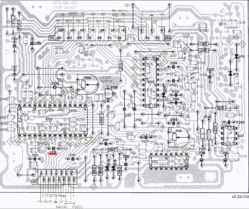

Only thing I am able to find suspicious is that I don't measure nothing across the 2136, and the manual says I should measure +-400mV adjusting the pot 3146!

I indeed have found one that must have gone out during disassembly(see attachment). This was the 14 wire "extension" cable - flat laser c. to flat servo c. I was sure that will fix the problem... but nope.
