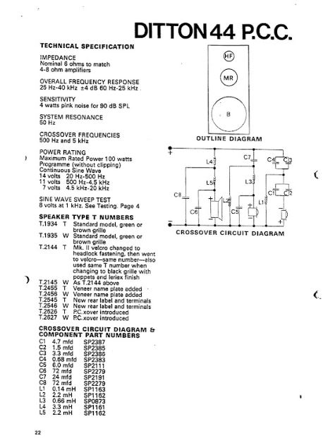

I was extremely impressed by the Ditton 44 as a loud party speaker. Integration between the drivers was excellent, and it seemed to create the wall of sound that is the mark of such things. Steep 4th order bass is quite unusual.
I would be wary of replacing the electrolytics on the bass and mid with film types, because my modelling suggested the significant resistance of the capacitors (ESR) helped smooth them a bit.

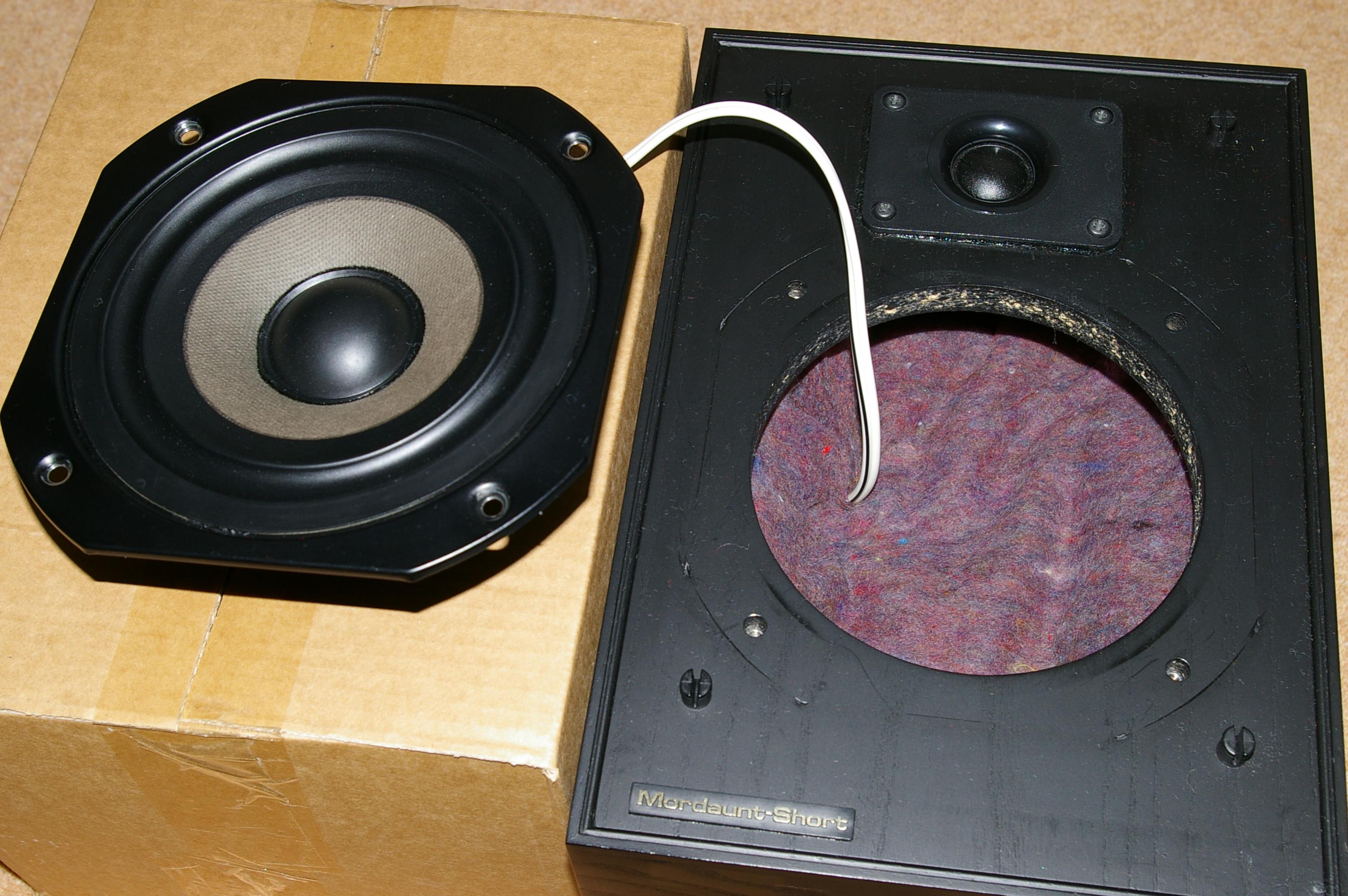

Filling the box with foam was quite Celestion. Other folks tended to merely line the box with foam and add some volume wadding. Like Galu's wool:

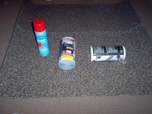

i still like the idea of sticking cabinet damping to the side, top and bottom panels:
I got this corky/rubbery Regupol stuff from the builders at work who were soundproofing a room.

Troels Gravesen gives his usual superb analysis of this type of speaker here|:
SEAS Kit 503
His 1R/10R attenuator/impedance correction on the mid must help deal with mid breakup.
