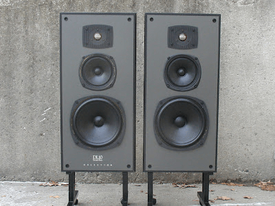

I need to replace/repair tweeters on Celestion D10s.
I can't find any or suitable other make/model replacements.
If these are blown is it the diaphragm/coil that gets damaged and would it be a case of attempting to replace these micro parts as I noticed that someone in the states is selling the coils and diaphragms.

This is the DL10 Series 2:
I believe the same, or similar, aluminium dome tweeter is employed in the DL8.

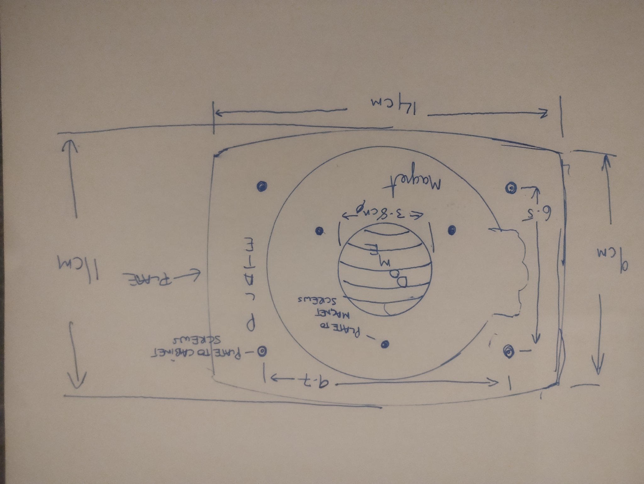

P.S. Please supply all dimensions of your DL10 tweeters.

Hope this is clear. DL10 tweeter drawing.
It's clear if I stand on my head!
The faceplate (converted to a rectangle) is 140 mm (w) x 110 mm (h) which is large compared to what I see available.
You could make a mockup of the DL10 faceplate from aluminium sheet, into which a smaller tweeter would fit.
However, finding a replacement tweeter that is a good electromechanical match for the DL10 tweeter is a problem.
I've ruled out trying to fit the DL8 tweeter to the DL10 plate due to cone aperture size and screw alignment so I have some 2mm steel which I'm thinking of cutting and drilling to match the DL10 plate size. Screw that to front baffle and in turn fix the DL8 tweeter. Wish me luck 🤞 or I may be able to put a thin bit ply instead shaped there is enough room to not touch cloth, as they say.
