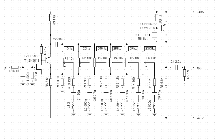

Please see the first post and the link to the original tone-control thread.
It includes this schematic:
![273858d1332735474-high-end-tone-control-minimal-eq.jpg](https://www.diyaudio.com/forums/attachments/analog-line-level/273858d1332735474-high-end-tone-control-minimal-eq.jpg)
I called it "East German EQ" because that is what it is. It was designed in East Germany in the late 70's and remains somewhat legendary for it's sound quality. It avoids the use of looped feedback, which similar western Pro-Audio design already used in massive amounts routinely. I can attest to the sonics of this type of EQ, I used it extensively.
This EQ shows the principles for what "ZenEQ" (Solid State) and the "HotEQ" (Tubed).
The circuit can be realised using only two N-Channel devices per channel, or if we want to very Zen, we can get away with one device (but must provide a tightly defined load).
The chokes in the filters can be replaced by Gyrators, using even single J-Fets. I would attempt to retain real chokes for as many bands as possible though.
It appears ZEQ/HEQ is currently ahead in the poll, the advantage is that that linear track pots may be used and few parts are required. The downside is that the active section must be designed in. So a Tube version would be a distinct Fork, the Fet version another.
Ciao T

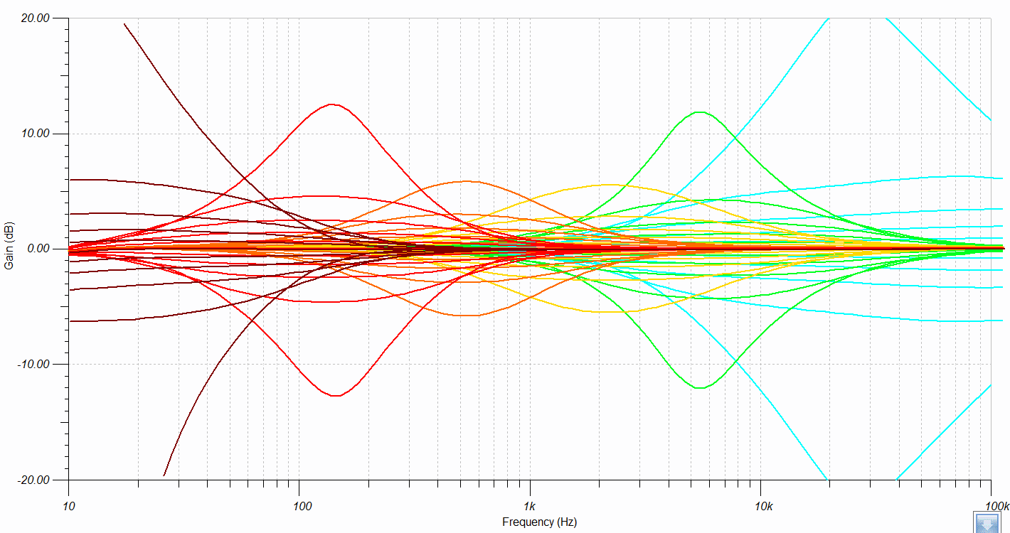

Folks,
I had the chance today to run the "ZenEQ" concept through Tina-Ti. This is not necessarily meant to be a final design, rather a quick study how a simple circuit may perform.
This reminded me that if we require a more or less proportionate boost in dB vs. rotation we need to use potentiometers that are "S" curve, not linear. These are hard to get these days.
If using linear pots then the adjustment range gets bunched up towards the extremes. This is not necessarily a bad thing, as it makes very small adjustments very precise, the downside is that if we need a lot of correction we are left with very little usable travel.
If using switches as controls this is of course of no consequence at all, as we simply can select the correct resistances to give correct dB/vs. Attenuation.
Attached is Tina-Ti File I used (needs latest version) and some simulation results, all using 10K//1nF load. I am not sure how accurate the models buld into Tina-Ti are etc., but it would seem okayish for ballpark.
I would specify 2SK170 BL or V for the circuit, Tina-Ti lacks the model, so I made up a compound from 2N3819 & a PNP BJT, 2SK170 will show worse THD. I am for now showing ideal chokes, they can be replaced by gyrators, but I lack the time right now. For the LF choke 2H with < 120 Ohm DCR are needed, I do have a few such around, so we know they can be made.
The schematic looks like this:
The curves produced by stepping the pots in 10% intervals (this is equivalent to rotating linear pots 10% of the rotation for each step):

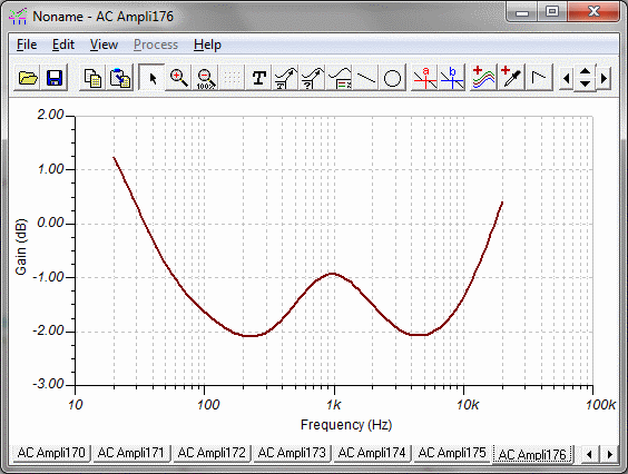

The frequency response with controls perfectly centred (impossible with pots) looks like this:

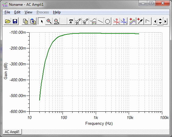

The LF rolloff is a result of the 2.2uF coupling capacitors shown. I habitually use this value, it works fine IME.

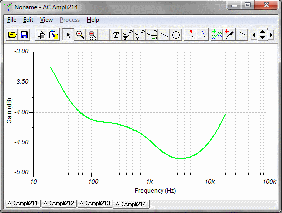

To illustrate two interesting EQ results, here what it looks like with all controls set halfway towards maximum cut from neutral:
This illustrates rather well how the various bands combine and with a weighting that is similar to the ISO Equal loudness peaks and through...
And here a EQ setting that can help with modern overproduced recordings, by cutting back presence and "kick" bass, and dialing the extremes up, all just a touch:
The required pot settings for this (0 = centre, 0.5 is half way between zero and the respective end, linear pots assumed) are:

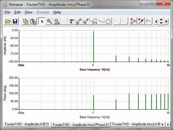

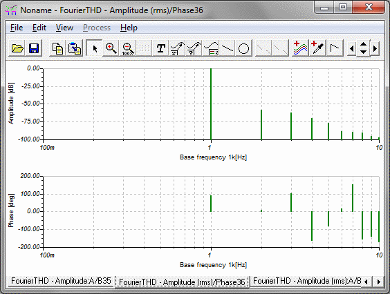

Here harmonics for 1V out which adds up to 0.005% THD according to Tina-Ti:
and for 4V out which adds up to 0.05% THD according to Tina-Ti:
Clipping (1% THD) is at 5V.

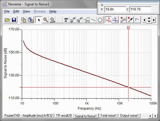

Tina-Ti has a seriously funky way of showing noise, anyway, it works out ot -120dB unweighted re. 1V, which seems too good to be true. Still, might be on the money:

That is probably my fault. I refuse "to lead" and to be the one who lays the down guru style on how it can only "one way, this way and no other". I'd rather people find THEIR way. Hence i gave many options and ways.
Anyway, what I can contribute for now is on the table. True, I assume that there will be some of the least common of all senses applied when using the circuit I suggest, no attempts to drive headphones directly off the output of the EQ and other such sillyness.
Anyone wants to do something Op-Amp based instead, on a similar level, please chip in...
Ciao T
