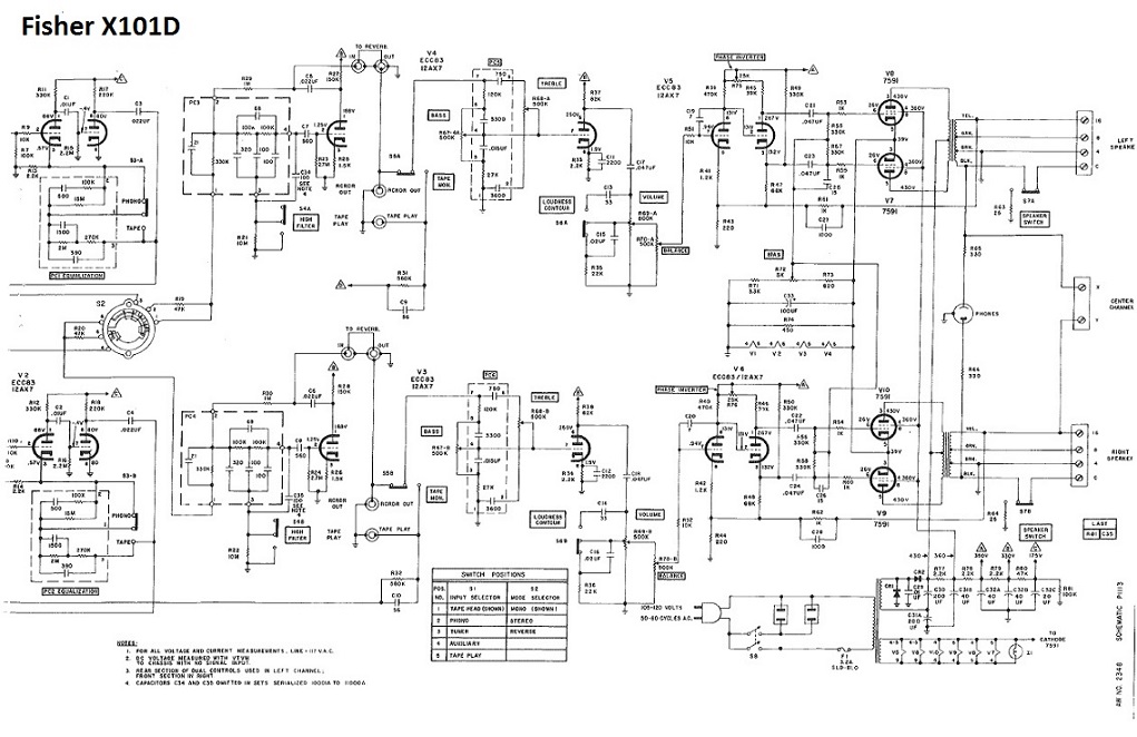

You have seen the circuits.
I have not seen the schematic.
Please post a schematic.

The Schematic of Fisher X101D in attachment.

Gusmore,
Thanks for the schematic.
There are extra taps on the output transformer secondaries.
One is L - (not common) - = it is out of phase versus the 4, 8 , and 16 Ohm taps.
One is R - (not common) - = it is out of phase versus the 4, 8 , and 16 Ohm taps.
The common of those secondaries is one tap up. the commons are connected to amplifier circuit commons, like B-, bottom of output tube self bias -, etc.
1. One purpose of the extra taps was to run a Headset:
The tap plus 330 Ohm resistors from each tap runs the L and R Headset.
The headset signals are out of phase with the regular L and R speakers.
2. The other purpose of the extra taps was to be able to run an extra speaker to create an
expanding effect acoustically.
You have already stated: The [same] extra taps also connect to the "center" speaker.
This is not a "center" channel. Just because you place the "center" speaker between the L and R speakers, does not make it the sum of L + R.
Consider a stereo recording, with the lady singer exactly between the 2 recording microphones.
Her voice will be the same signal phase and amplitude coming out of the L and R speakers. (that makes a Pseudo acoustic effect, which makes you hear her as if she was in the middle between the L and R speakers, even though there is no speaker there.
A true "center" speaker coming from a 3rd channel amplifier that was L+R, would put out her voice.
But the L - tap and R - tap have exactly the same voltage and phase of her voice signal.
The difference is Zero, and No sound comes out of the "center" speaker.
The only sound coming out of your "center" speaker is the signals that are Not in the center of the stereo recording, only the performers on the Left side of the recording, plus only the performers on the Right side of the recording.
I hope that complex discussion explains it.

Notice that the center channel speaker differential connection is between the 16 ohm tap of one channel, and
the 0 ohm tap (C) of the other channel. This gives a mono signal, since the two nodes are "out of phase".
That is, ( 1/2 plus V - 1/2 minus V ) = plus V ........which is mono.
The headphones, being ground referenced, are connected from each 0 ohm (C) tap to ground.
rayma and duncan,
Good eye on the schematic.
My eyes are 75 years old, and the schematic was not the clearest.
I did not catch the "center" speaker connection to R channel 16 Ohm tap.
However, we need to look at the schematic a little closer too:
The Headphone output resistors connect to the Extra L tap and Extra R tap. They do not connect to the 0 (C) tap (well, the Common of the headphones do).
And C taps are at amplifier ground.
As I said already, the headphone signals are out of phase with the main loudspeakers phase.
(depending on the manufacturers phase versus their connectors; and depending how you connect the loudspeakers to the C and x Ohm tap.).
No, I will not go to Fisher and tell them about what I have observed from this study.
And even if I owned that amplifier, I would not connect the "Center" speaker.
But . . . it was a good curiosity, and perhaps gave a sweet sounding and interesting acoustic sound for the times.
And no, the extra L tap, and 16 Ohm R tap are not always out of phase.
That is because some signals on a stereo recording already have out of phase signals of L and R, before they even get sent to the amplifier.
Out of phase once, and then going through another out of phase process = in phase.

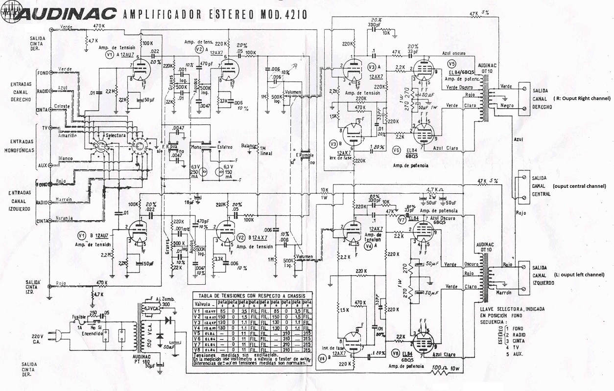

I have read, in audio and electronic magazines of the 60s, the advertisements of stereo amplifiers with a central channel, and I was curious about this.
I had also warned that the connections are not symmetrical.
Look at the circuit that I publish in attachments about a stereo amplifier with a central channel from the 60s, made in my country.
Connections are similar, but not the same as the Fisher X101D.
I await comments.

I think to explain it simply there's a reverse tap on the top output transformer so this generates -R to one terminal of the speaker and L to the other. Thus the speaker generates L+R. Its rather clever. You could hang a subwoofer here. By playing with the taps more you could even widen the stereo image.
Thanks for the answer,
I don't think the speaker connection generates L + R, for me it is more complex.
I think it is not that simple, it is easy when the manufacturer indicates what the connection is like, and another thing is if you do not know, and you have to do it yourself.

Except that Rayma was correct. I have worked on some of these amplifiers and his explanation is the correct one, it is mono (sum) out of the center speaker.
The output transformers have their 4R taps grounded, like Audio Research amps have always done.
(ARC uses this feature for balanced feedback.) This gives +Vout on the 16R tap, and -Vout on the 0R tap.
Each of these outputs is at half of the total output amplitude, and they are "out of phase" with each other.
The 4R tap is electrically a center tap of the secondary, halfway in voltage from the 0R tap to the 16R tap.
With this topology, we should avoid calling the 0R tap "common", because it is not grounded.
Instead the (common ground) headphones return to the 4R tap, which is grounded.

RE: Post # 7 schematic:
The impedance of the various output taps:
With both the L and R 4 Ohm taps grounded, that means that the C taps are (- phase) 4 Ohms away from ground.
And that means that the 16 Ohm taps are ( + phase) 4 Ohms away from ground.
We have one end of a "center" speaker connected to the L channel - phase 'common' tap which is 4 Ohms away from ground; and the other end ofthe "center" speaker connected to the R channel + phase tap that is 4 Ohms away from ground.
Now we are loading the various Ohm taps with a L and R speaker, and at the same time with a center speaker.
That means they outputs are nominally overloaded.
Probably should connect L and R speakers this way:
16 Ohm L and R speakers to 8 Ohm taps.
8 Ohm L and R speakers to 4 Ohm taps.
And 4 Ohm L and R speakers to 4 Ohm taps (Oh, but the center speaker is already loading the taps).
And the center channel speaker should be either 8 or 16 Ohm.
