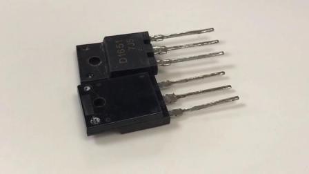

First time using these, because they are supposed to transfer vastly more heat to the heatsink than mica or silicon insulators. The question I have is... Do I still use a quality thermal grease like DuPont with these? Or do you mount these insulators dry? They are a porous crystalline solid dielectric but with very high heat transfer, so wondering if the grease helps or hurts. Debating what to do, not much on Google about which way to go.
https://www.aliexpress.com/item/1005001350971494.html?spm=a2g0o.9042311.0.0.dcd44c4dEiogOD
You DO need grease with ALL solid/hard insulators, that includes Mylar, because you need to fill surface imperfections with other than air, and I mean transistor case and heat sink surface imperfections.
Only Silpads and similar can avoid grease but that because they are very flexible (rubber) and fill the voids.

Thanks, makes sense. The porosity of these was throwing me off, in my mind thinking what if they are just big sponges absorbing the grease and maybe losing their characteristics if they get "clogged up". Overthinking it probably.You DO need grease with ALL solid/hard insulators, that includes Mylar, because you need to fill surface imperfections with other than air, and I mean transistor case and heat sink surface imperfections.

I used these for two F5 Turbo. Much better with a thin layer of grease but in my case it was somewhat tied to the rough finish on the heatsinks.First time using these, because they are supposed to transfer vastly more heat to the heatsink than mica or silicon insulators. The question I have is... Do I still use a quality thermal grease like DuPont with these? Or do you mount these insulators dry? They are a porous crystalline solid dielectric but with very high heat transfer, so wondering if the grease helps or hurts. Debating what to do, not much on Google about which way to go.

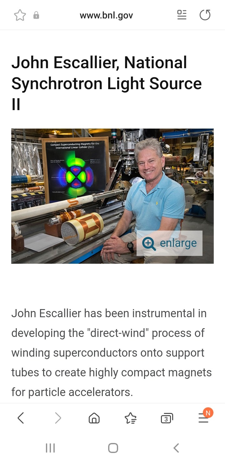

I can only say that I envy you...a lot!What's that S shaped coil doing?Sitting there, so full of myself....then the photographer said to me...lean forward so you don't look so fat.
ffffsssss.... air rushing out of a balloon.. sigh...
jn
It is a small test pattern for a longer coil. It is a serpentine pattern that creates an octupole magnet.I can only say that I envy you...a lot!What's that S shaped coil doing?
I start with a small test pattern, as the process has almost 70 variables which require optimization for new patterns.
It is exactly like flying in a plane.... 95% boredom, with 5% gut wrenching terror. In my case, the straights are boring, the ends are the problem areas, so there is no need to waste wire in the straights for tests.
The poster behind me is a false color image of a quadrupole, 4 poles 2 north, 2 south. It also has shield coils to cancel external fields, I turned off the shields on the left of the pic, and on in the right side.
John

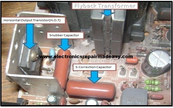

It's not much power going through old CRT TV horizontal deflection transistor (one often see these H transistors mounted on a flimsy piece of aluminium sheet), I think it's more a matter of high voltage, Mica isn't reliable material for high voltage due to micro cracks (I have seen mica insulators with carbon build-up in between its fine structural layers which shorted the transistors backside to the heatsink) so that may be a reason why some TV manufacturer used ceramic, but many horizontal transistors came in fully isolated plastic packages (metal tab inside the plastic mold) meaning the backside was insulated with a thin layer of plastic so these transistors didn't require any additional isolation/insulation, some H transistors have been made in both 'normal' packaging and fully isolated, and the power rating goes down quite a lot only due to the poor thermal conduction properties of fully isolate packages, in the end it simplified and reduced manufacturing cost assembling a fully isolated transistor over one that needs additional parts.You made me remember that once there was a Philips K9 TV set that used such a ceramic plate to spread the heat from its horizontal deflection drive transistor to an aluminium heatsink and now i get why.
