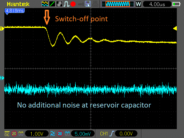

Capacitors across diodes are a very bad solution considering common mode noise. They connect transformer secondary to the rectified output and transfer common mode HF noise. When rectifier diode switch off, there will be RLC ringing. However, at that moment as all diodes are switched off, secondary is disconnected from the first reservoir capacitor. Ringing produces only radiated common mode noise and has direct path only through small diodes' capacitance. Here is an example with EI transformer, active rectifiers (LT4320) and no snubbers:
How much of common mode noise will be converted to the differential noise/signal depends on circuit design, wiring and PCB.
With snubbers, at the switch off point, there would be only one smooth step down and no ringing at all.
