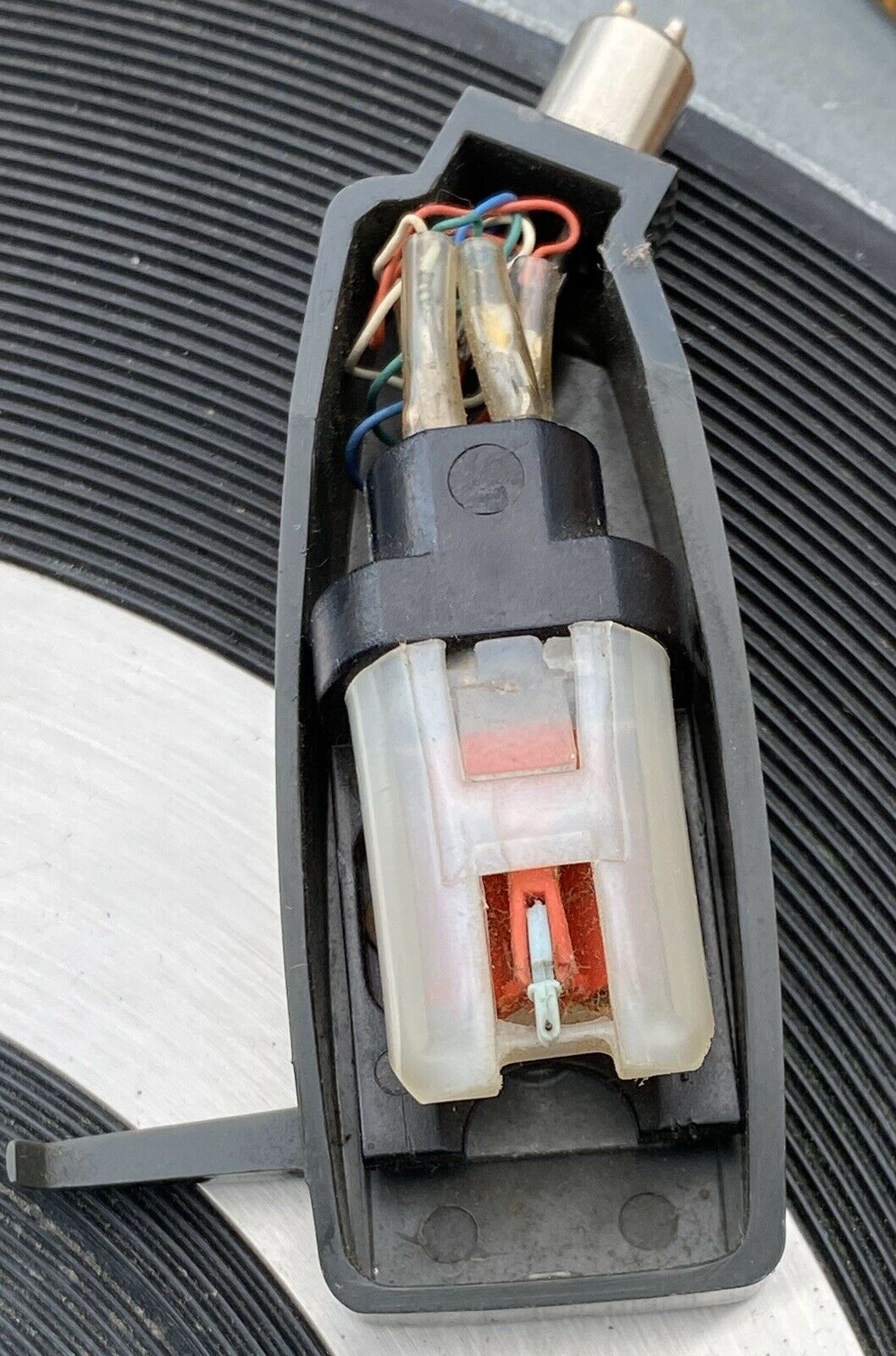

Ceramic carts are high output and need little to no EQ if the proper preamp is used. I have a nice new Sonotone (AKA Garrard) cart and a good old EV from my Clairtone. How well can they perform? I mounted the Sonotone on my AT tonearm with a new headshell and gave it a spin. The ceramic cart and headshell are so light that they float where the AT95E has 2.5g of tracking force. A dime on the headshell and a little balance adjustment got me to the 4.25g needed for the Sonotone.
It pugs right into my USB sound card and at 0.48V output, as more than enough level. It does suffer HF roll off, even tho the instrument input of the soundcard is supposed to me 1 Meg ohm. Below you will see two graphs, the shaggy one from RightMark shows the FR from a song on an old mono LP. White is the AT cart with RIAA, green is the ceramic straight in. The smoothed graph used the AT cart as reference and the plot is the FR of ceramic.

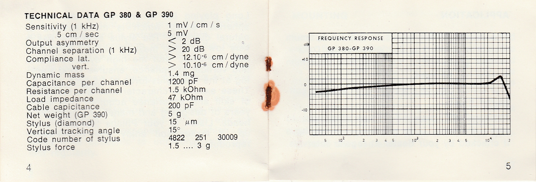

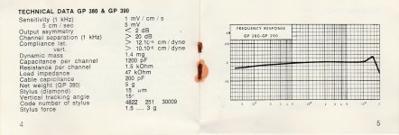

I love ceramics. Special the Grado B model and the Philips GP390. You can use these on a normal MM Riaa pre. They sound special like there is nothing in between if you know what i mean. More a "real to real" sound than a "Shure Moving magnet" sound. To bad they stop building and devolopment of ceramics. The old ones are faling apart, the compliance are hardend and the cantilivers and diamonds are not state of the art.

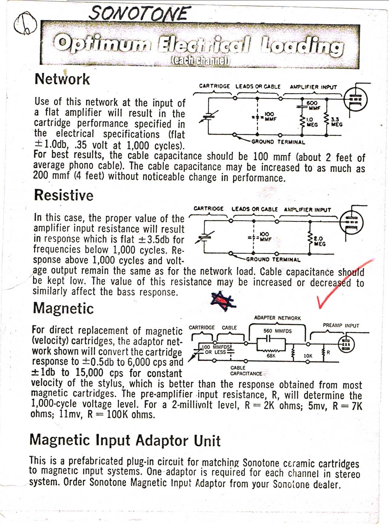

This looks like a simple and easy preamp for ceramic.
Ceramic Cartridge Preamp Circuit -- The Revitalizer
Or I might have a couple of SSM2019 that would have high input impedance. Using a load like the paper Galu posted could work. Don't need much gain, 6dB would likely be enough since the cart is high output.

Someone once told me that ceramic cartridges work a lot better when loaded with a virtual ground, but I didn't ask him any details. If I remember well, he was talking about a current to voltage amplifier with RIAA correction (or just a charge amplifier, that is, integrating current to voltage amplifier?). He taught electronics at a university of technology, so he generally knew what he was talking about.
Did anyone ever try that?
I understand it is conceptually better than a high-impedance load because you can use good-quality capacitors for the conversion of the charge from the cartridge into a voltage, while with a high-impedance load, you use the capacitance of the cartridge itself. The capacitance of piezoelectric ceramics is usually non-linear. No idea how much difference that makes.

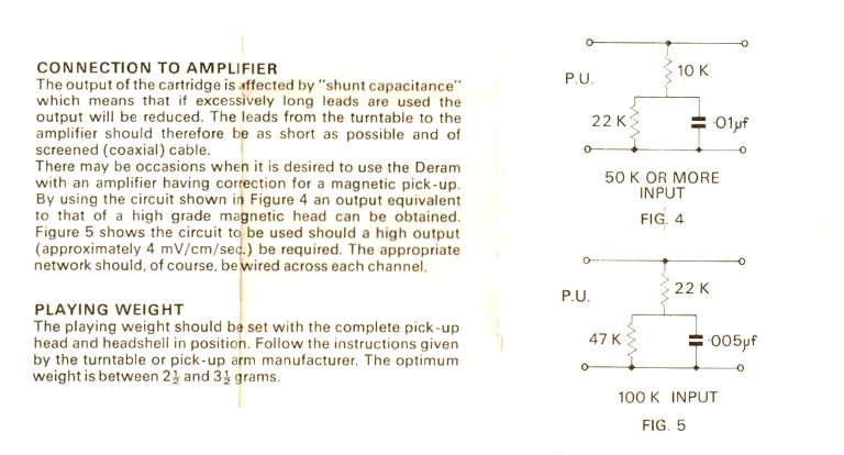

The specs for the "New Series" Decca Deram, the one with the translucent white body, are as follows:
Compliance: 9/5 cu
Separation: 20 dB
Output at 1 kHz: 200 mv at 5 cm/sec
Frequency range: 18 Hz - 18 kHz
Attached is the circuit to allow the Deram to work with a standard MM input.
