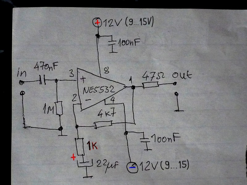

Here good schematic for ceramic pickup.
Cheers!

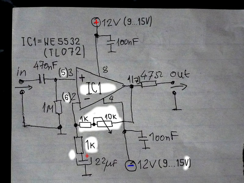

This is a better schematics which can be changed a gain with trimmer of 10k or (1....470k).
This schematic is for the stereo to mono use OA: NE5534, LF351, TL071, OP123, etc., while attention should be paid to the pins OA?
Input resistance changes with the input resistor connected to ground (1MOhm)
To enter this violin pickup resistor should be about 4,7 MOhm!
Best regards!
