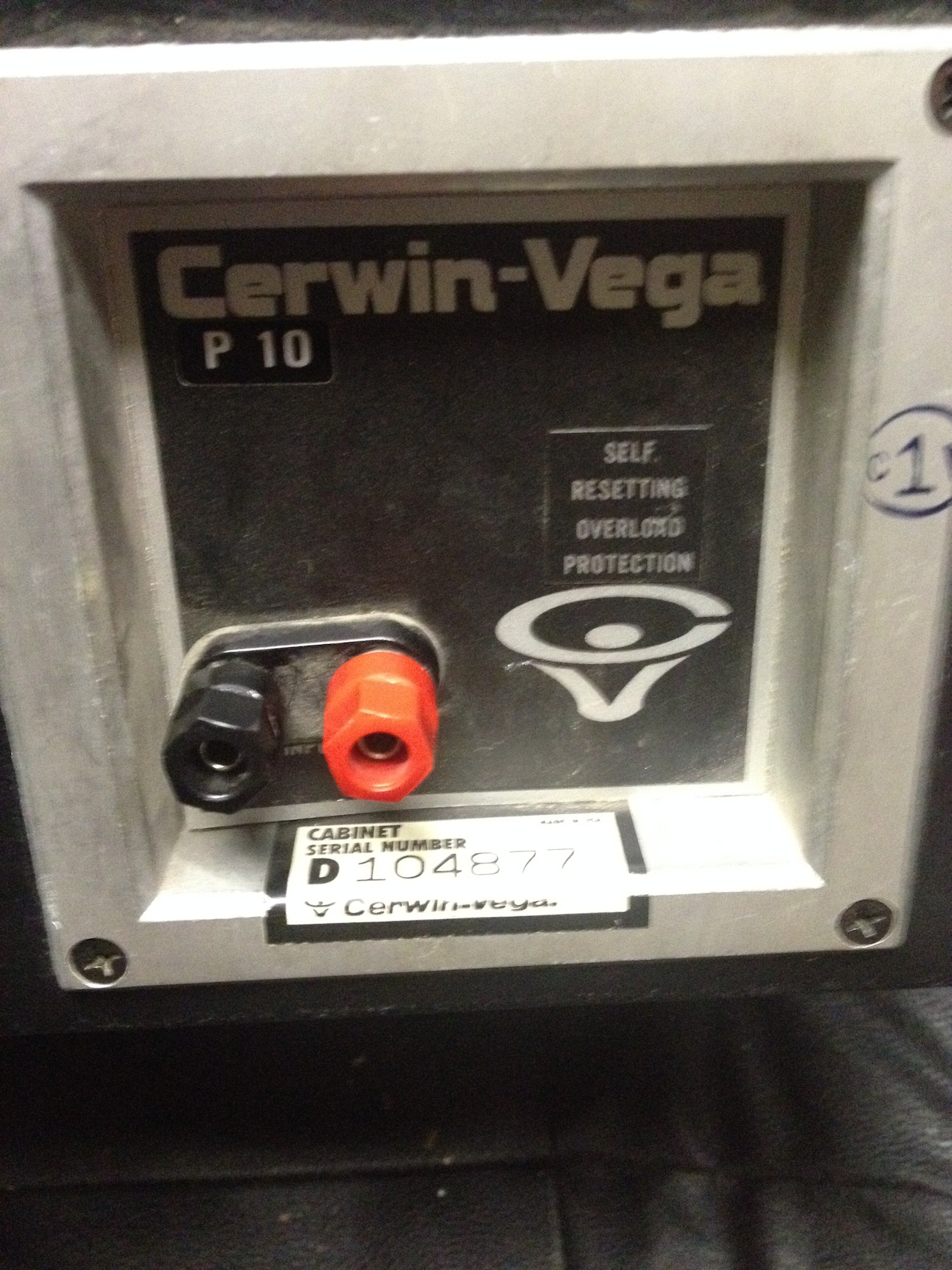

Hi everyone,
This is my first Thread here, so I hope I posted in the right Category.
I've bought a used Cervin Vega Sub/Sat system a few weeks ago, but I don't know much about this system and I even don't know if the sub and the sats belong together), so I wanted to ask if anyone knows something about these.
In the attachment there's a picture of them. If needed, I can take more detailed pictures.
What I know about the system :
The sub has no label anymore, so anything I know is that it's a 15" sub with a standard surround (not an M shape like on PA-Drivers). It has a passive lowpass and an hipass for the sats. The crossover frequency seems to be quite low (below 100 Hz).
The sats have a label which says the type is P10 but doesn't tell anything else. They are fitted with a 10" woofer and a small tweeter which seems to be an hybrid between ring diaphragm and horn. The woofer has no lowpass and the hipass has a 12 dB slope with a crossover frequency I estimate at about 4 kHz.
I hope someone knows more about these or maybe has some old catalogs, where some information can be found.

i'd pull the drivers and check what they are.
the thing that makes me wonder about whether these are legitimate product is the aluminum labels with the "red" those where only found on product that where produced before the 80's(older V32's and B38's)
i also wonder about the 10 inch drivers the color of the surrounds doesn't seem right the 15's have the normal fade of older Cerwin stuff.
i'd venture someone made boxes and loaded drivers that are cosmetically treated to look like C/V stuff

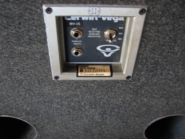

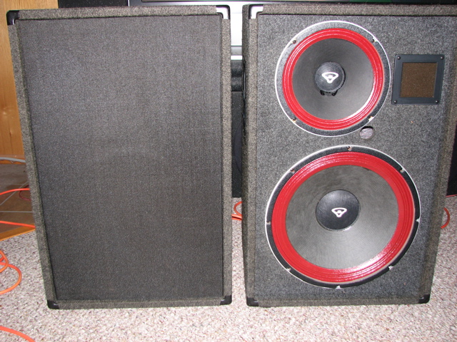

The 10's look to be the same as these. These are Cerwin Vega MV-15's. They are intended as a pub speaker, not really suited for live music.
Yours look like a similar combo. I'm thinking the woofers were replaced with HiFi units.

Yes, they seem to be the same. I just took a look at google concerning the MV-15's but there's not more information to find about them than about the P10's, except some comments which say that they're not really good.
Mine really look like a mish mash. That's why I wondered if the really belong together especially as the sub seems to be designed for really low-bass (which isn't quite PA-like) and there seems to be a dip in the frequency response between the sub and the sats.

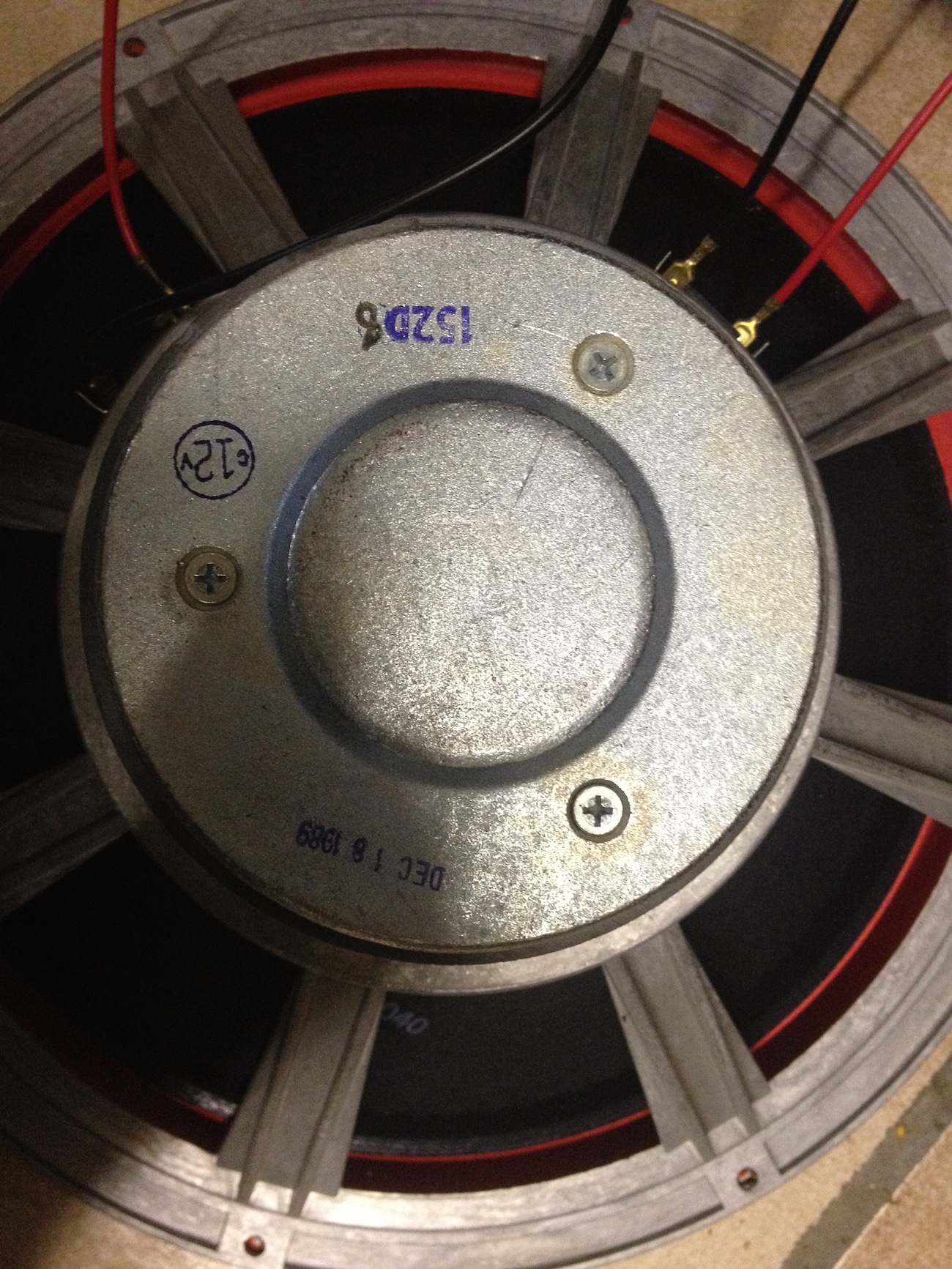

Hi everyone,
I'm sorry it lasted a bit longer, but I was absolutely lacking time the last few days.

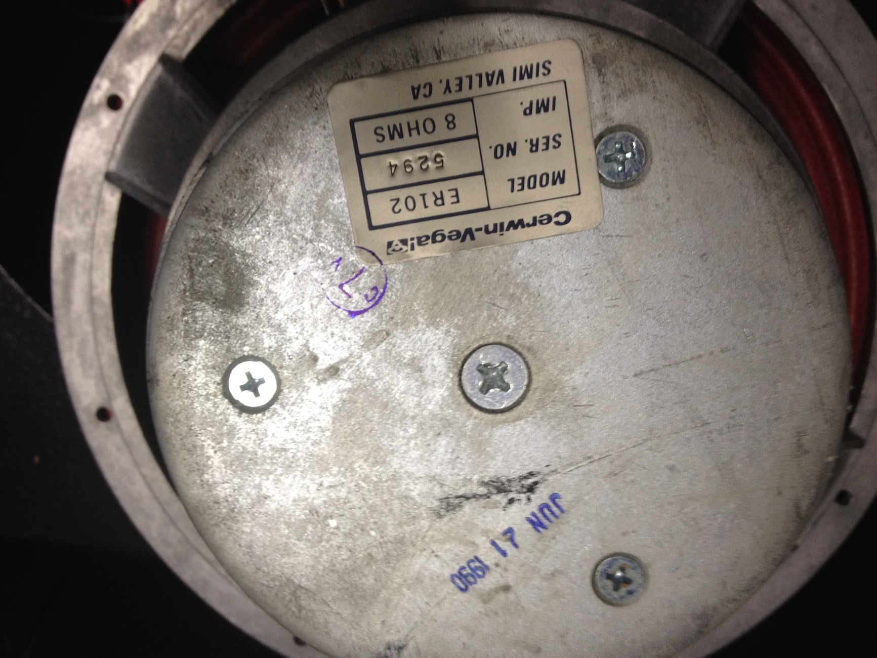

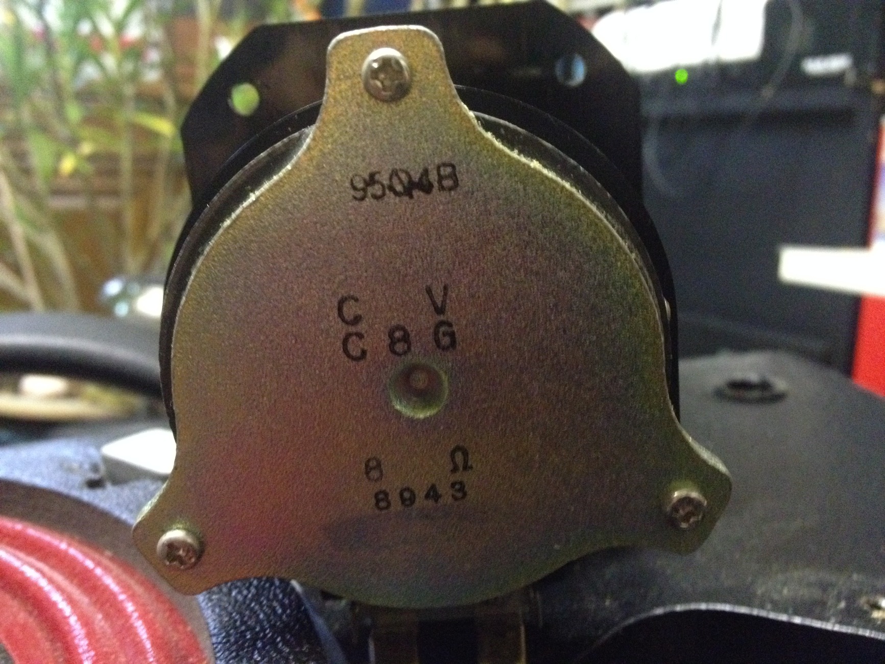

I now took pictures of the drivers back sides, with the drivers ID-numbers. You'll find them in the attachment. (In that order : sub crossover, sub driver, sat tweeter, sat woofer, sat crossover, sat terminal)
The system seems to have been manufactured in 1990 as the manufacturing dates of the drivers are from late 1989 and early 1990.
Now I'm quite sure the system is a mish-mash as from the magnet of the 15" woofers quite too small for a PA Driver and even smaller than the one of the 10" driver. So the sub is definitely taken from the Hifi section.

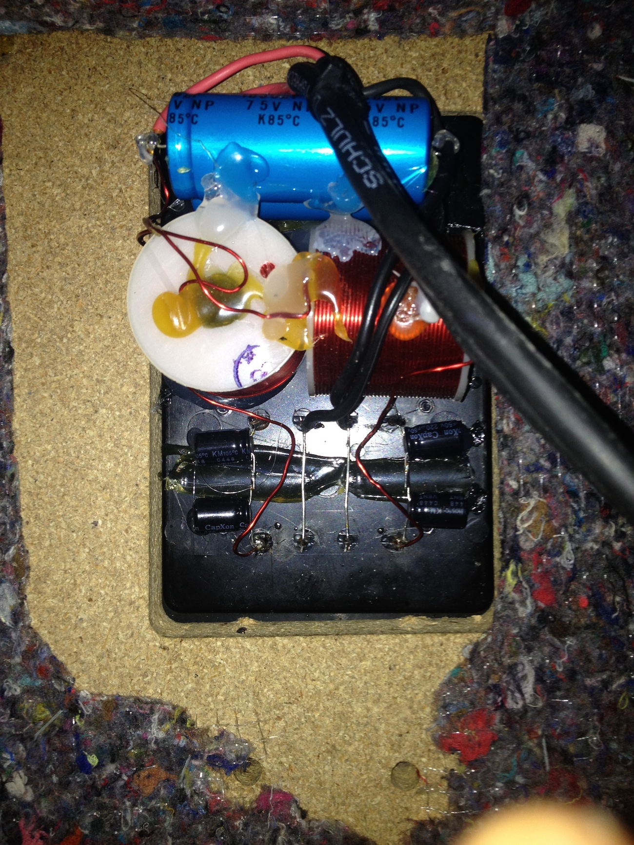

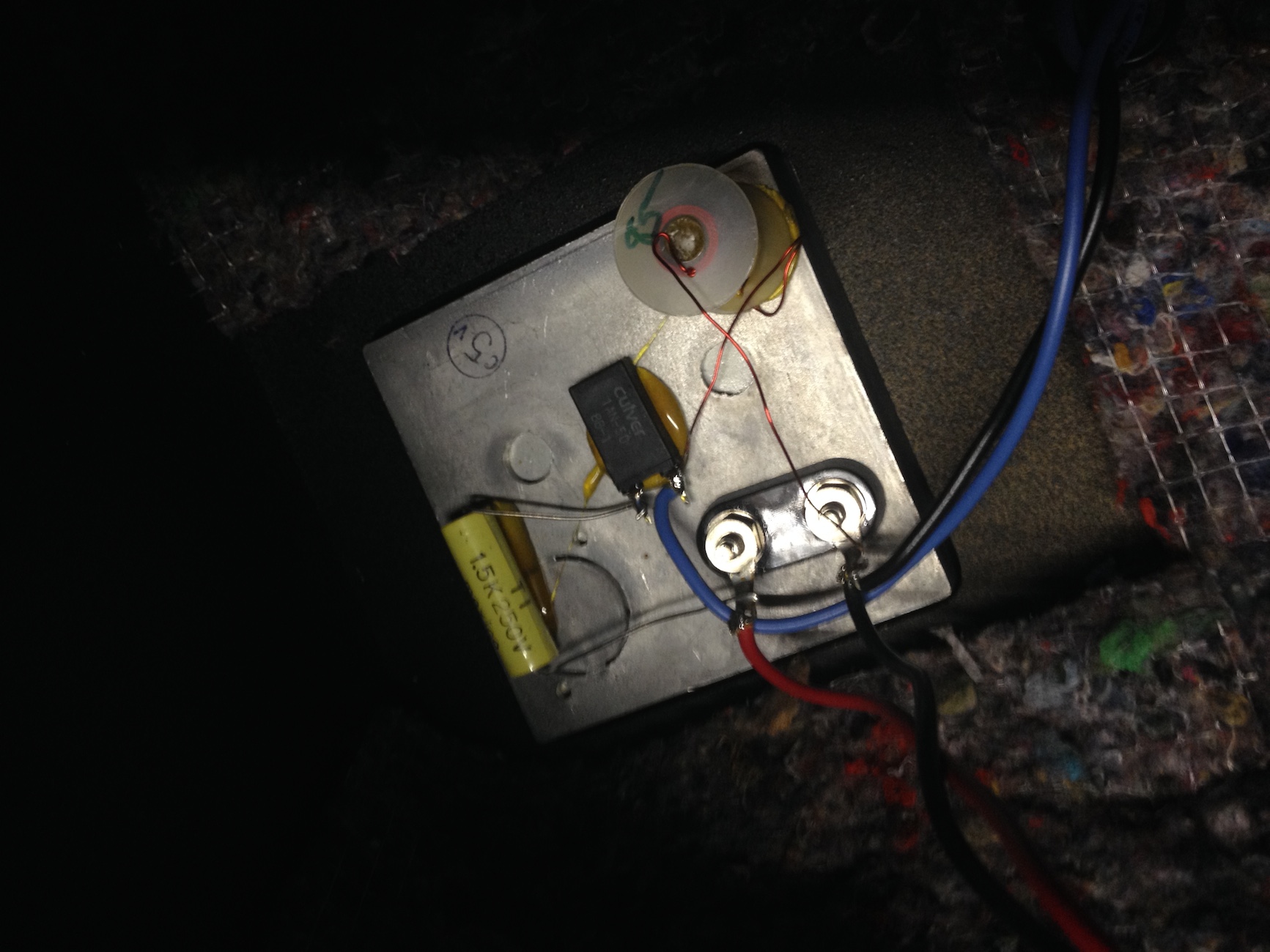

The sub's crossover seems to have been modified.
Hello Denis. If I remember correctly the magnet size on my 15" is smaller than the 10" also so the only thing we can go on is that PA drivers normally have an accordion surround. Both of your boxes look like PA so again, it may just be the woofers were replaced. Another strange thing is that the P10 binding post looks like it is for home use with the screw type and banana plug. Never seen that on PA stuff.
What makes you think that?.
Ok, thanks for the information. The terminals look quite strange for PA, especially on the Sub, where they're just pushbutton types which are designed for quite small wires (more than 1.5mm2 won't fit).
The first thing I noticed when looking at the crossover is that there are two different types of hot glue used to attach the crossover parts to the Terminal, one seems to be newer as it is whiter. The caps for the hipass aren't glued although there's glue under them and their capacitance (2 x 220uF in series, so in fact just 110 uF) seems to be much too low.
Additionally the cables from the crossover to the the woofer are two types from different brands connected together as if they were lengthened.

I think I know what those are--and why.
Back in the 60's to early 90's, the US military was big into audio. They sold so much higher end audio that manufacturers would make military only models. The big brands
back then where JBL, Infinity, Bose, Cerwin Vega, Klipsch, KEF etc. For instance, Cerwin Vega made the D series for consumer use and the M series for the military. The M series used PA drivers and more protection in the crossovers. They were also very LOUD and durable--perfect for the target audience.
Not brandy snifter hi-fi, but when teamed up with a Yamaha M-80 or Carver M1.5t amplifier and a pocket full of fuses...instant block party. The next morning, plug in the KEF 104.2 speakers to sooth the hangover.
The P10 was not a big seller because it was not as loud as the M series and sat/sub systems were supposed to be small (Bose AM-5) Catch 22 for the time.
I'd rebuild the crossovers and give it a shot--easy to swap the sub with a more modern edition to get it smooth.
