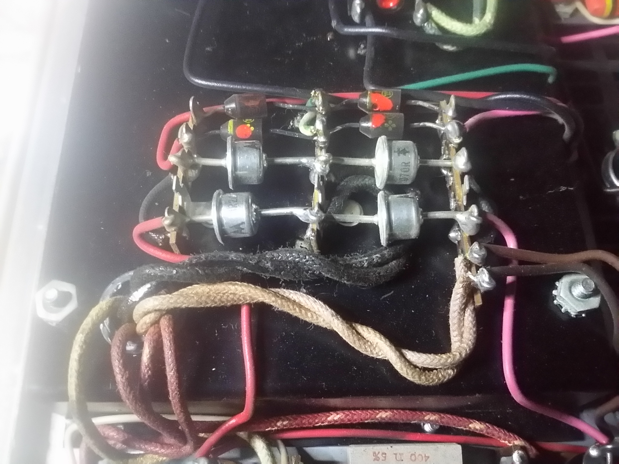

Hello,
I did change the primary connection from two windings in parallel to two windings in series to make it work with 230 volts ac in my country.
Did find schottky diodes ( sb12100 12A peak reverse voltage 100 volt). Will wait for more input to decide if i will use them.

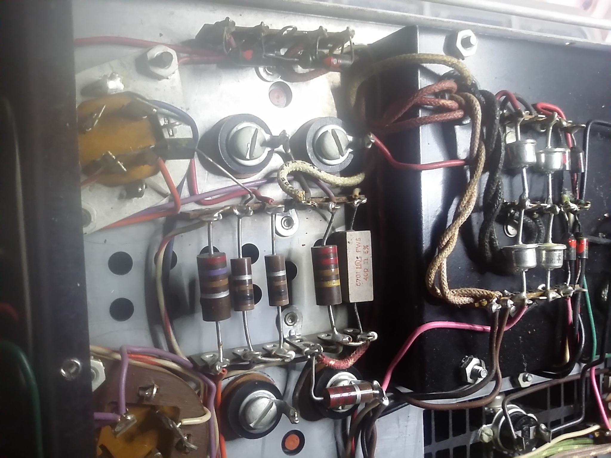

Hello,
I did start replacing the caps in the power supply.
I am not a technician at all but the way the power supply is wired is not really the best way to do it. Because the resistors in the power supply used to make RC network and/or getting the right voltage for the next stage to be '' fed '' are in the same area mounted between two terminal strips.. The wire feeding the circuit will often depart from the resistor which seems strange to me because the '' energy '' is stored in the cap. So i did replace the old caps containing a few caps inside by seperate ones and mounted the resistors right the different caps and have the circuit getting their supply by using a wire coming from the capacitor.
The grounding of the capacitors in the original design is also a bit strange. There are two terminal strips and in the end the result is that they are all connected to the chassis together with the center taps from the transformer.
Because i did change the power supply into a CLC type and change the two multiple caps by seperate ones i ended up with more wires that need to be connected to ground.
I did connect the center taps and the two caps that are between rectifier and choke to the same cable lug. The caps after the choke to another lug. The caps from the negative power supply used for driver/input to a seperate lug. And then the last lug for the positive supply of the driver./input stages.
These lugs can be bolted to the chassis using the same bolt. Could be possible to only connect the center taps and first caps to the chassis there and the other ones inanother area closer to the input of the circuit???
Will post some photos later.

Hi Eduard,
I really, strongly suggest that you not mess with the grounding on these or any other amplifiers. McIntosh engineers knew precisely what they were doing when they designed these products. I'm not about to start second guessing them. I would also have left the original filter capacitors in place unless they were failing (which I doubt they were).

Hello Chris,
Always finished it and going back to the original situation would take me at least the same time. lol
The caps being at least forty years old i dont wanna take the risk. Once i had a big cap going bad ( the pressure vent did open up) not with a big bang but still.
The original ones might be ok but i dont wanna take the risk. You can find a lot of postings here about caps going bad in amps much younger than this one ( produced between 1967 and 1977)

Hi Eduard,
I'm an authorized McIntosh technician. Those large capacitors rarely fail or dry out. They aren't the same as the small electrolytic types. The terminal studs allow for very high peak currents to flow, and this amplifier (or any for that matter) rely on this for high transients in the music.
If you must replace those, buy something the same type and value. These will be expensive, but there is a reason why this is so. I think you are focusing on a rare event to justify replacing them, but that is your prerogative. Just put the appropriate type to replace them with.
