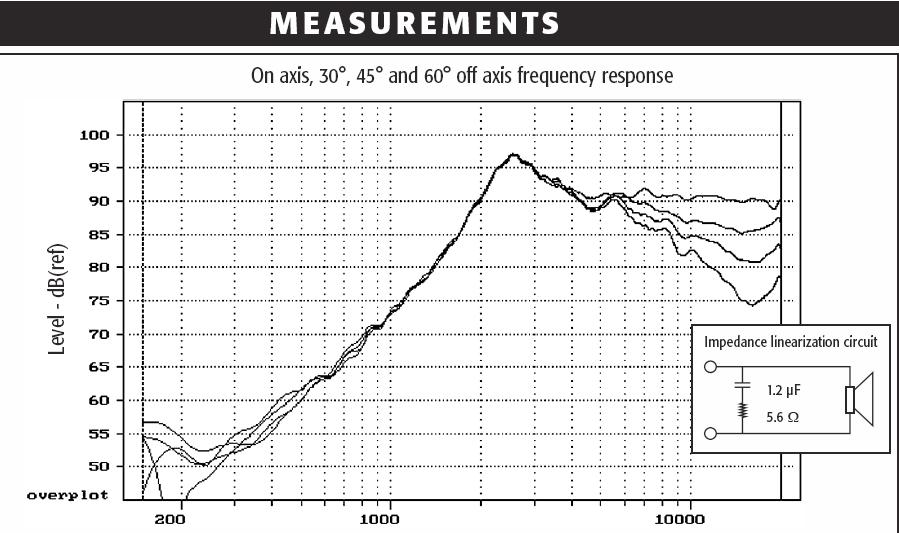

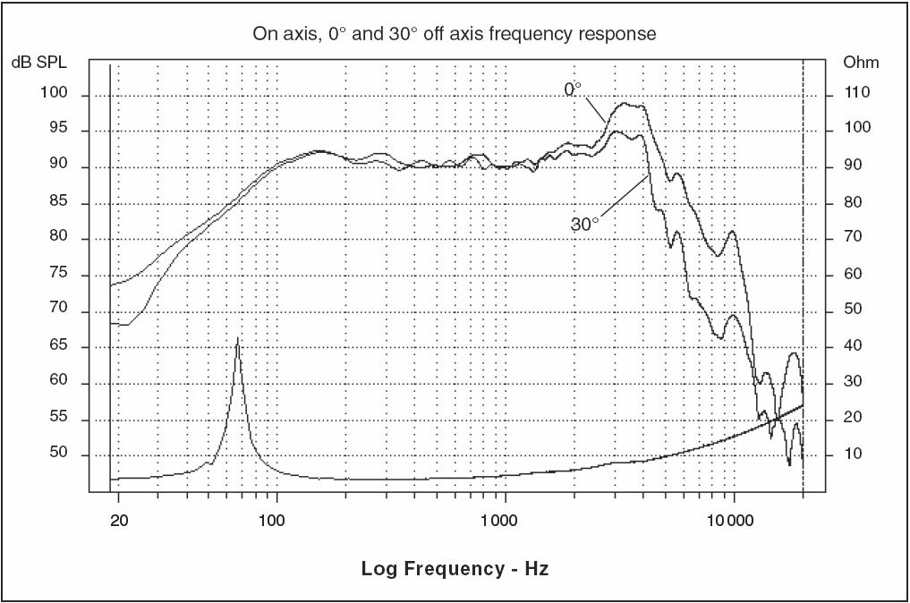

My question now the focals crossover is at 3500 hz 12db/oct if I go to 24db/oct or even more can I go to 3000 ?
The reason is tweeter have less boost on 3000-3500 than the woofer
I post datasheet measurement any Tips on where to cros are wellcome
Thanks in advance

I don't understand actually what is the tweeter ? It is useful to have tweeter impedance. If it is a TN-45 you can go as low as 3kHz.
I suppose all is 4ohms impedance, all drivers connect positive polarity and you use a LPAD to adjust the level of the tweeter.
The crossover 3kHz
Tweeter : HP 18dB 10uF/0.15mH/15uF
woofer : LP 12 dB 0.47mH/22uF
Focal has done a 6/12db at 4.5kHz (I suppose 0.22mH LP and 4.7uF/0.15mH HP 😕 )
If you want a better sound i think you should cross as low as 2kHz. The woofer at 3kHz have a cone resonance, not good for the sound. You need a very good neo tweeter. The resonance frequency must be lower than 1500HZ. The original Focal's TNB tweeter can be use or seas tweeter 27TFFN or Monacor DT284 etc.
The crossover 2KHz
Tweeter : HP 18dB 15uF/0.22mH/22uF
woofer : LP 12dB 1mH/22uF
Note I work with the acoustic slope, here 24dB.
Hope this helps

Looks to me like you almost have to cross at 3000, since both units are peaking strongly about 1/3rd octave on the opposite side of that point.
If your question is about the power handling tradeoffs of 12/ at 3.5k vs. 24/ at 3k, I think the increase slope will benefit much more than the slight crossover reduction hurts.
Go for it.
Note that since your woofer and tweeter are both rising significantly at crossover, you will end up with split crossover points: i.e. the woofer may need a 2500Hz electrical filter and the tweeter a 3500Hz electrical, to achieve 3000Hz crossover.
