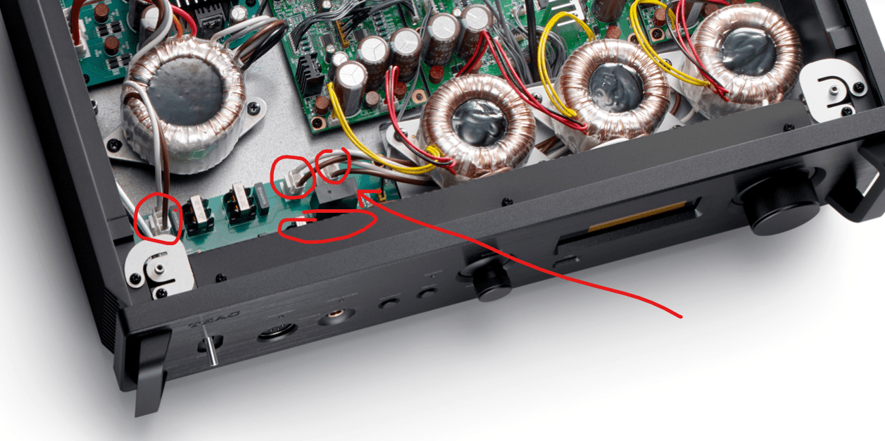

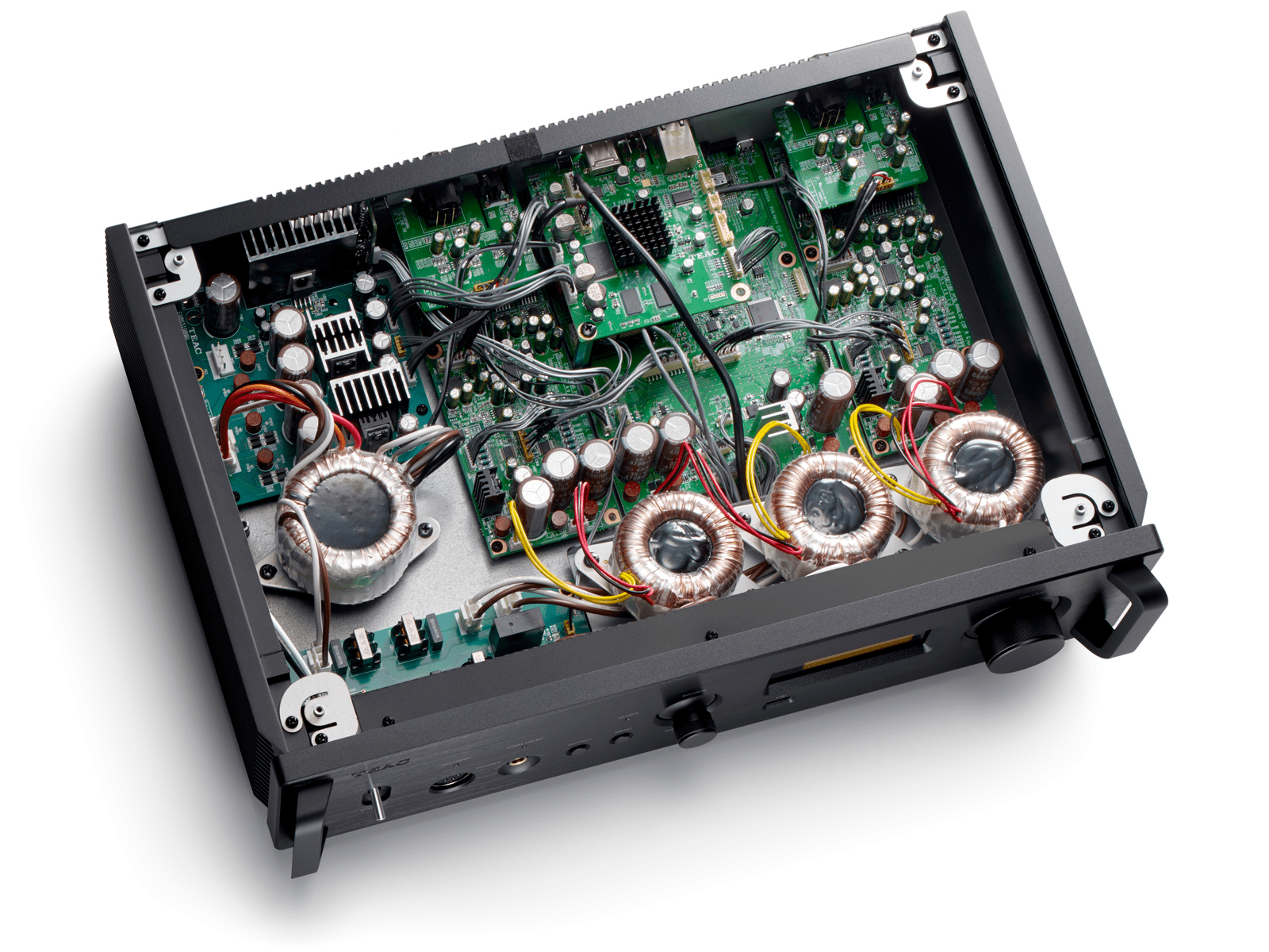

I really want a TEAC UD-701N DAC/network player, but the US price is $1200 more than I can buy from Japan or Europe. Of course there's a voltage problem, and I don't want an external transformer, the alteration would have to be internal. But I'm not sure what would be required, this looks more complicated than a lot of the gear I've owned.
I'm posting an internal photo, wonder if anyone has a good idea of what might be involved, worst case scenario. Easy to get a new toroidal trans, but I'm not sure what else might be involved. Any suggestions welcome, thank you.

Thanks Mooly, that’s what I was afraid of. I wasn’t even considering the 3 smaller ones, which I thought would have been common to all regions. But the big input trans looks like it might also require a new board too?

Thanks again Mooly. But the internal voltage is set by the big toroid right? Isn't that one doing the transforming to feed the rest of them from its secondary taps into that board in the lower left? I was thinking the first one could just be replaced and the only difference would be it has a different primary, but the secondary would be the same. I'm not very expert at these things, so just a novice assumption. Still might need a different input board I also assume, so it's a no-fly.
I think you will find they are all connected to the mains. If you look at the board at the lower left you can see the primary connections. The arrow points to what seems to be a relay and so I imagine the larger transformer keeps the logic and so on powered when in standby and the relay connects the other three to the mains when it is taken out of standby. All those brown and white wires will connect to the incoming mains.
All the toroids have multiple secondaries. Red/Black/Red on the little ones will likely be something like 15-0-15 to derive a split rail and the yellow single secondary for some other use.
those are definitely 100v only transformers. might work at 120v, probably the unit will overheat. get a 120v to 100v transformer.

Mooly, thank you for pointing those details out, it’s educational. On my current dac, a Gustard R26, you flip a switch and done. Same with other components. But I have to presume these bespoke arrangements are a bit cleaner overall, it’s got to cost more to make 3 versions than just install a switch.

Often transformers have multi voltage primary windings which as you say can be either user switchable or perhaps a simple internal rearrangement of a plug/socket but unfortunately these do not appear to have that.
I would think ultimately the reason will come down to cost (it always does in one way or another). It may be a few percent cheaper to have a single voltage rather than multi standard. Also less cost in adding user switching.
