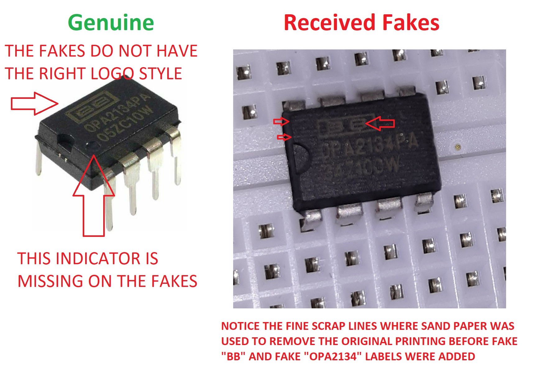

I also suggest the OPA2134. However be aware that so many op amps sold online are fake.
If you buy them online expect to get sand papered and relabeled LM358 or something in that sort of performance class.
Thanks for the advice but i always buy from RS component or from some reputed offline(local) component dealers 🙂 ....& i'm very good at recognising fake op-amps, no one can fool me 😀

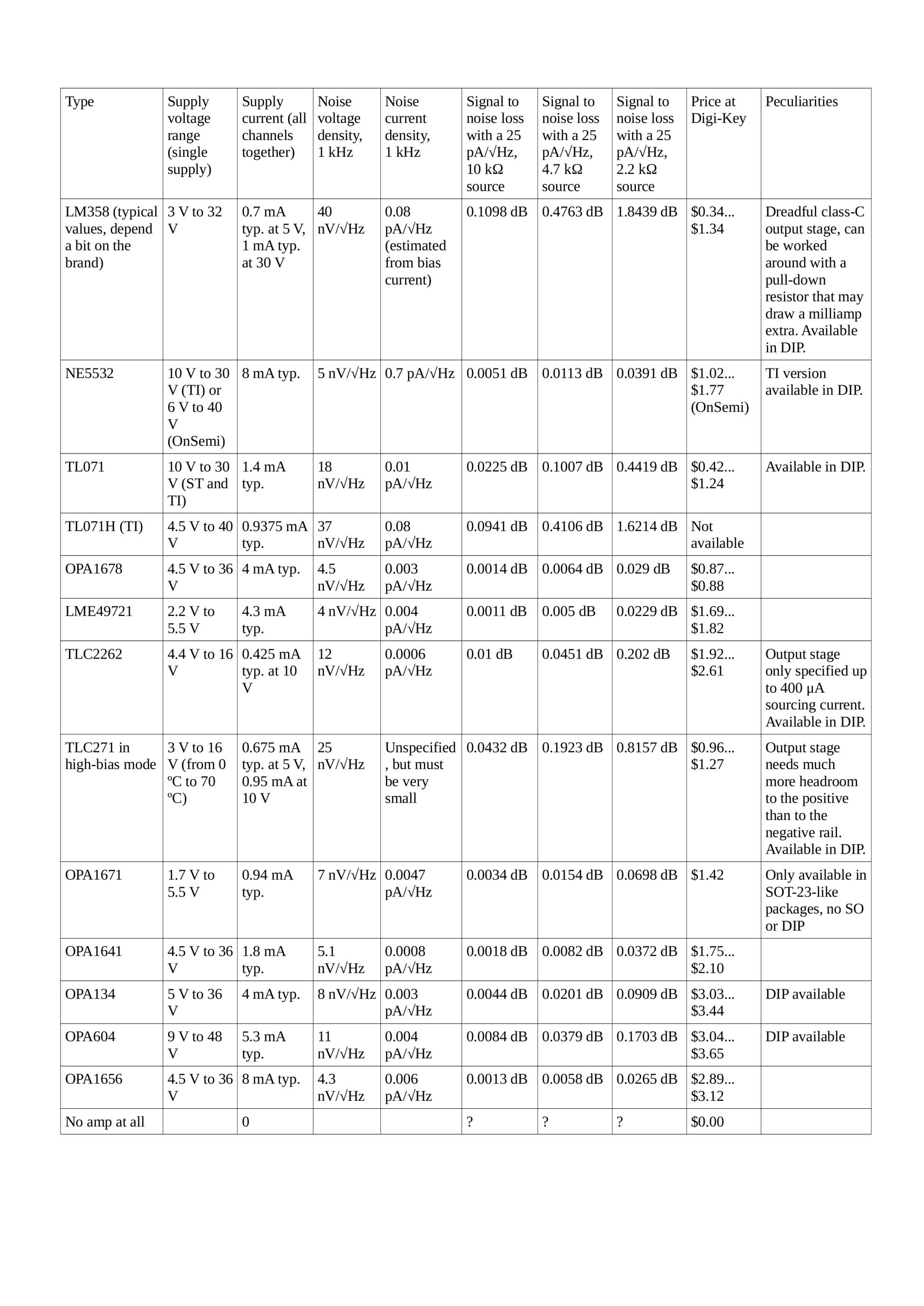

I made the attached list for another thread and not everything on it has a JFET input stage, but maybe it will be useful anyway.

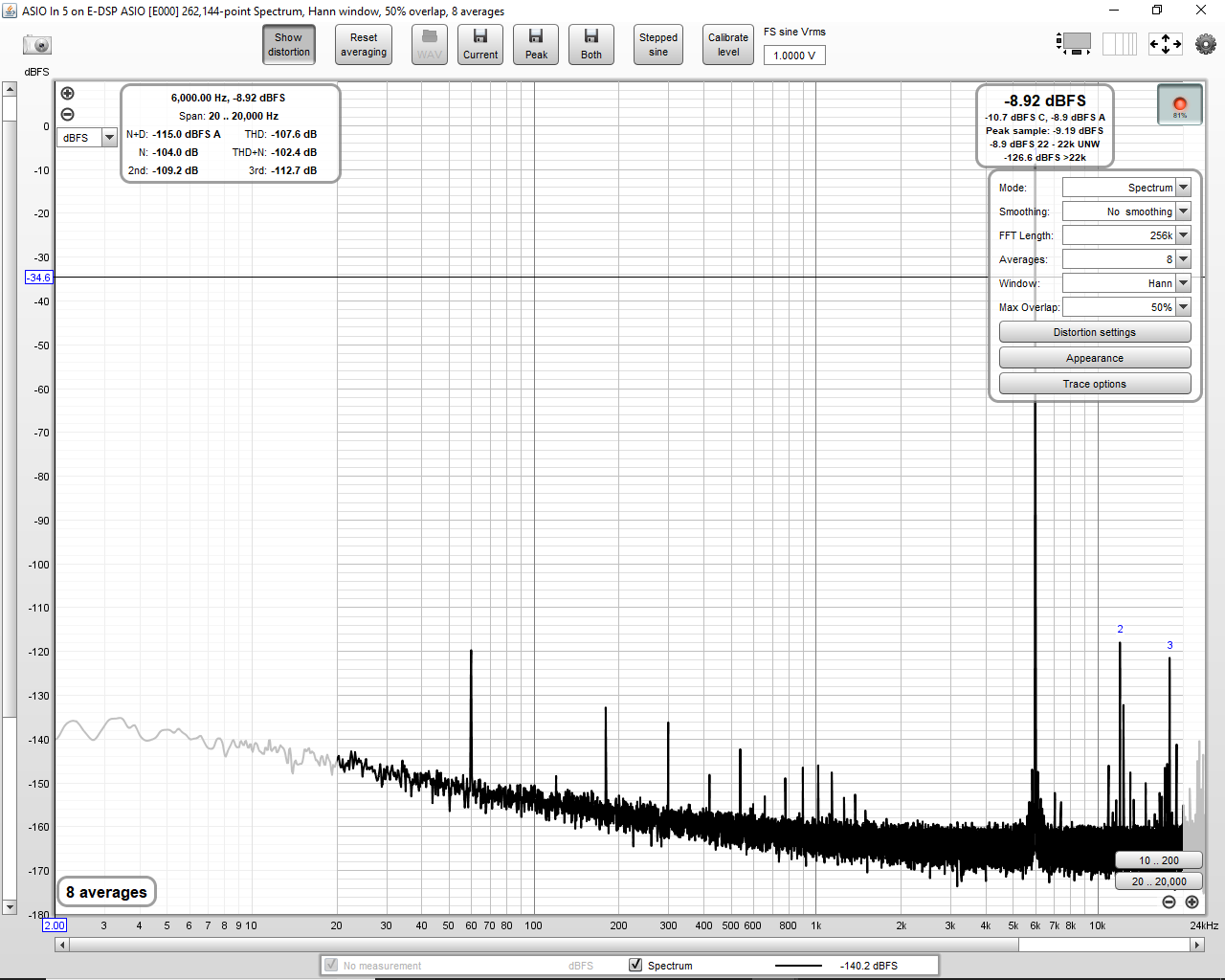

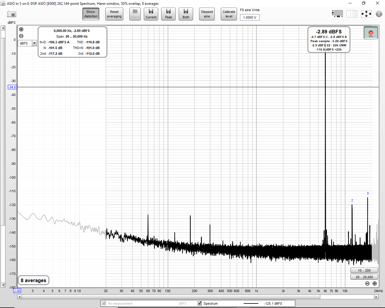

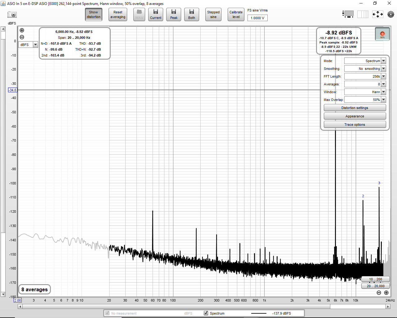

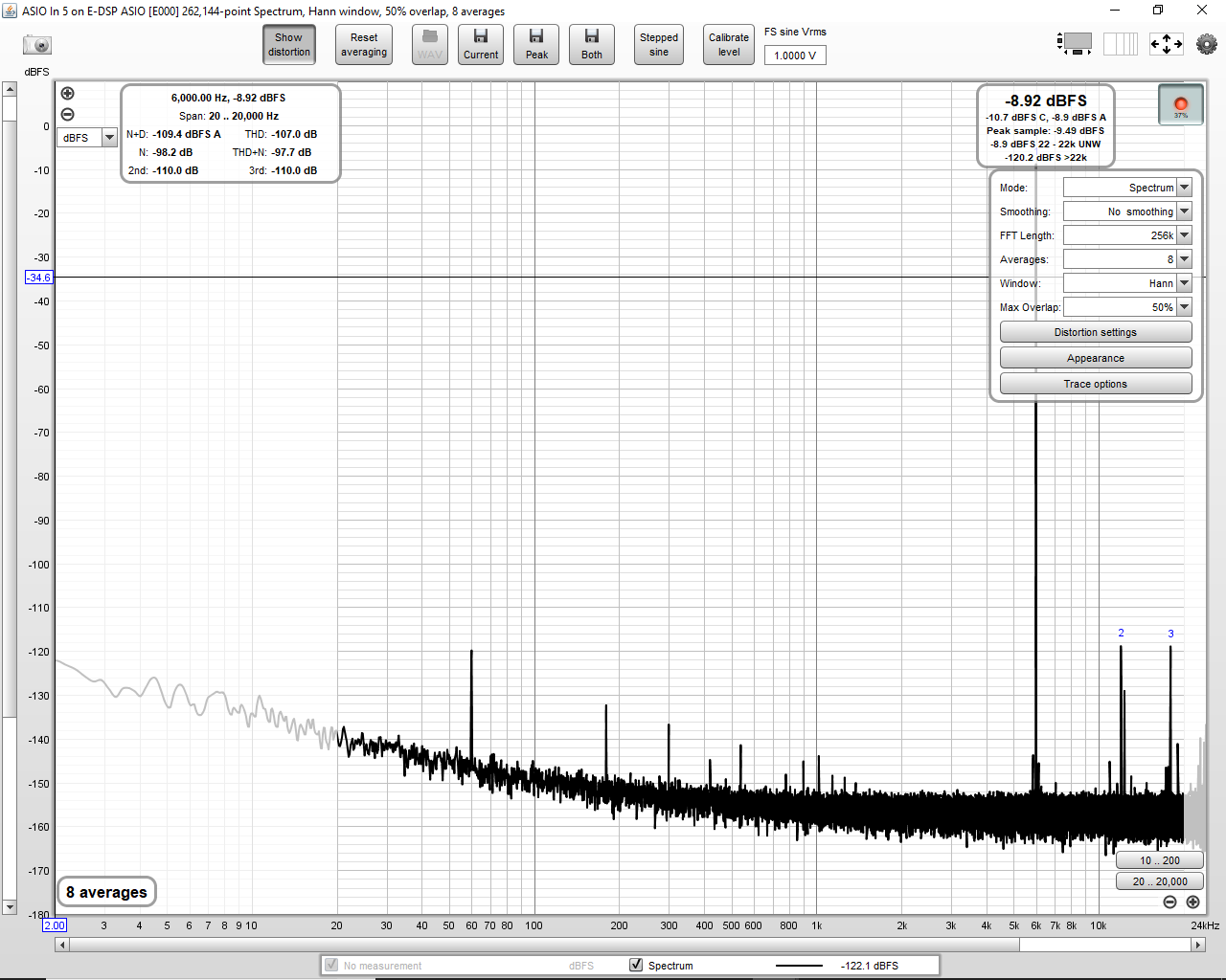

I just put NJM 072BD and then LF353N in my PCM1798 DAC. They measure very differently. The LF353N (old National parts) performed amazingly well. The TL072 performs poorly in that application. I put them in the I/V and the filter locations. (Using the BB schematic.)
In order the graphs are NJM 072BD, LF353N, LF356M and LM4562NA.
These are single ended measurements at 6kHz (to make it harder than 1kHz) -3 dBFS. Later I will do balanced measurements with my E-MU 1616m.
