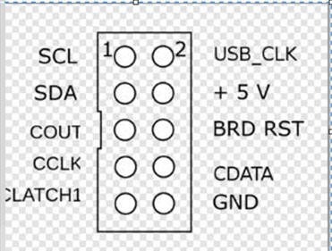

I'm not sure if that programmer will work with the 1701. Looking at the picture it says "For Sharc" which the 1701 is not. Here's the pin out for the 1701 USBi connector.
It's got me worried.
The EVAL-ADAU1701MINIZ board from AD uses
1- SCL
3- SDA
2- USB_CLK (although this seems to be unconnected)
4- 5V usb power (opt)
6- BRD_RST
10- GND
This programmer has all these except 2 and 6. Unless it can reuse some of its other pins as a 6- BRD_RST there is no chance of it working.

It works! First time!!!!!! So happy!
That's this USB programmer https://www.aliexpress.com/item/1005003091557781.html programming an ADAU1701/1401 board.
All it needs connecting is SCL, SDA, and GND and you can power the ADAU from the programmer if you like.

Hi Spot, would like to know your connections to the ADAU1701 board. My board has a 10Way connector just like the programmer you have mentioned.
You just need to connect the SCL, SDA, and GND pins and either power the board externally or from the programmer.
If you're not sure which pins are what on your board, lookup the datasheet for the ADAU chip and follow the pcb traces from the chip to the connector if you can.
