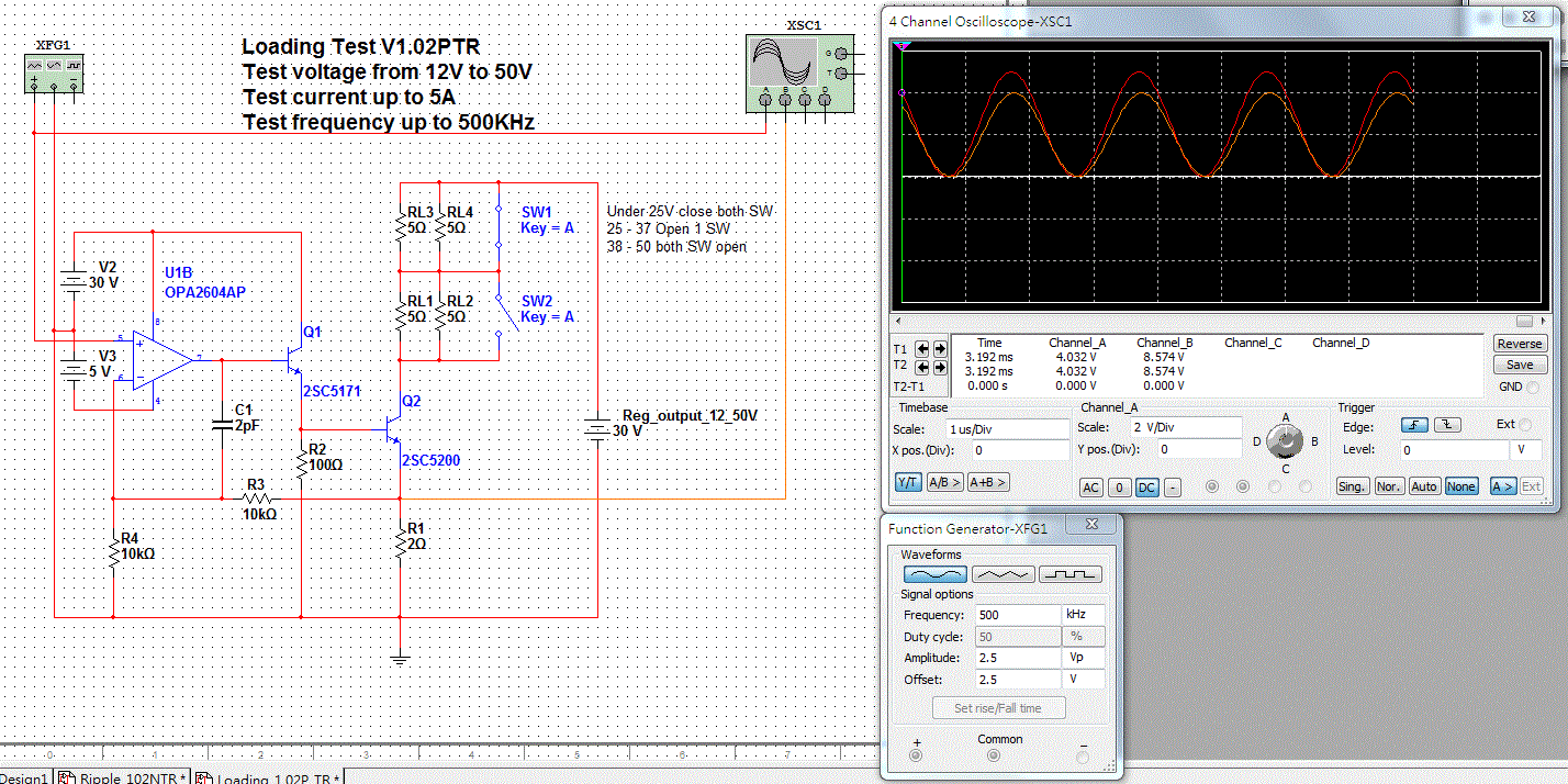

I'm also looking for some circuit for building a power supply performance test, mainly 2: 1) Loading test, 2) Ripple test. Does anyone like solution for that?
