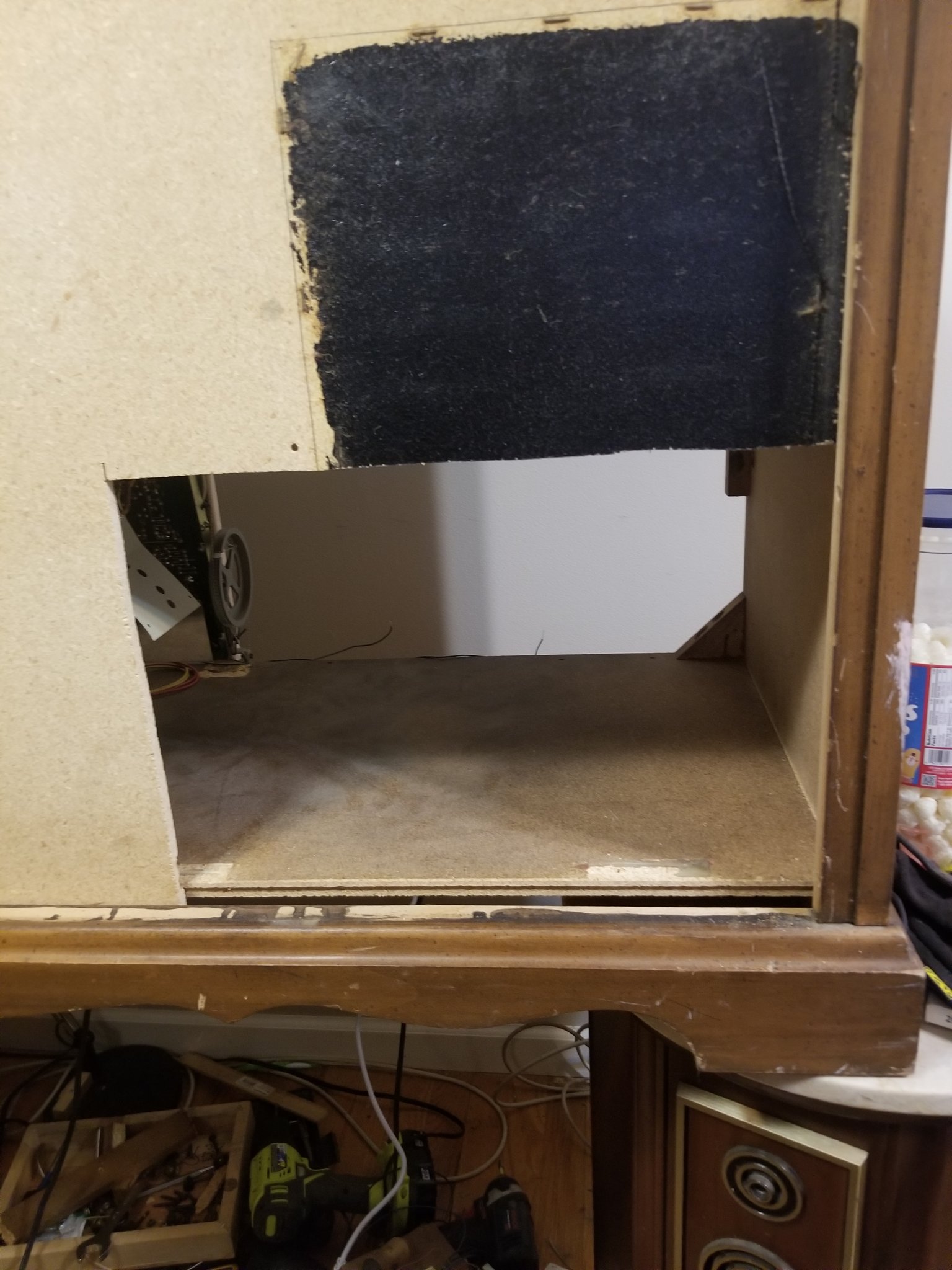

I am working with a set of Yamaha NS 6390 / 6490 bookshelves. As these speakers are going to be built into a zenith allegro console. (I am just jamming them in the cavity of the console, box and all.) I am not going to spend much time with the speakers until I rebuild the complete cabinetry of the console.
That said I intend to place a 2" x 2" dense Oak cross brace side to side, and a 2" thick piece of paper backed insulation on the inside rear panel.

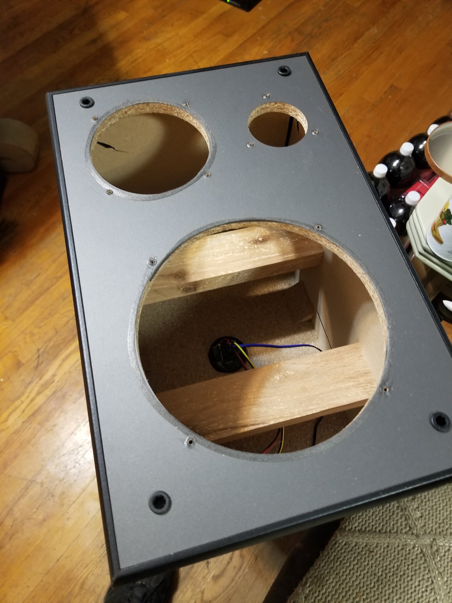

This is the bracing I ended up with.
Two 1" x2" oak. They are surprisingly ineffective according to the " bang it with your knuckles" test. I am sure that once the drivers are mounted there will be some improvement compared to the non braced box.

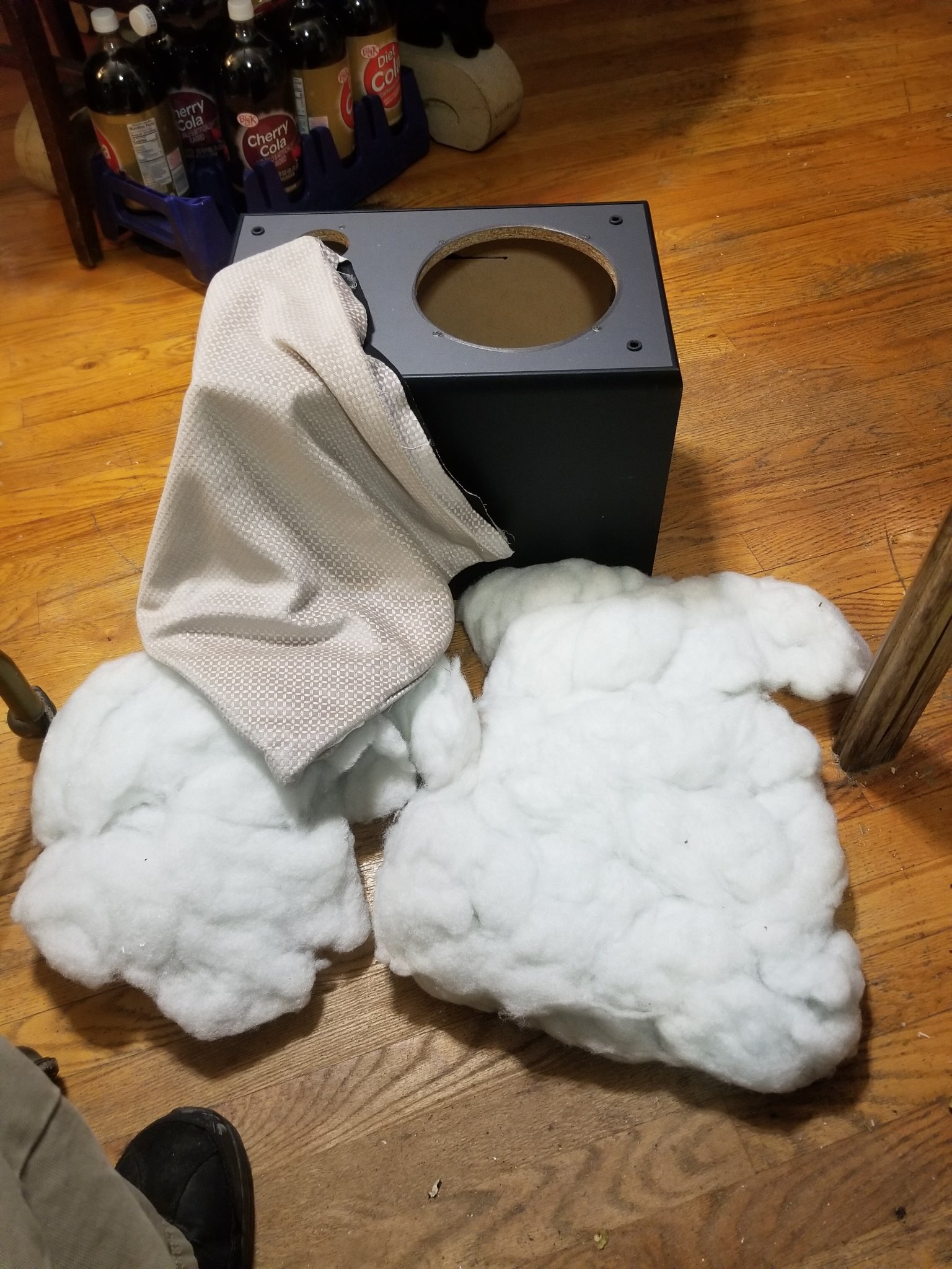

I will be using exactly .877 x 1.5 pounds of fill, 1.3155lbs. errr umm I mean I will be using exactly half of the pillow stuffing that I scavenged from a mysteriously missing couch pillow

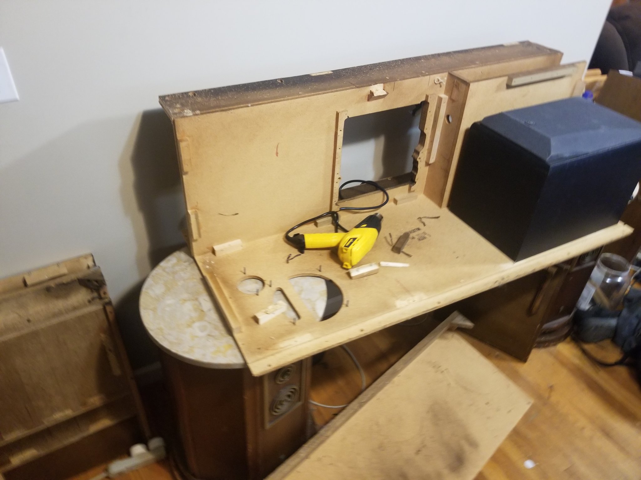

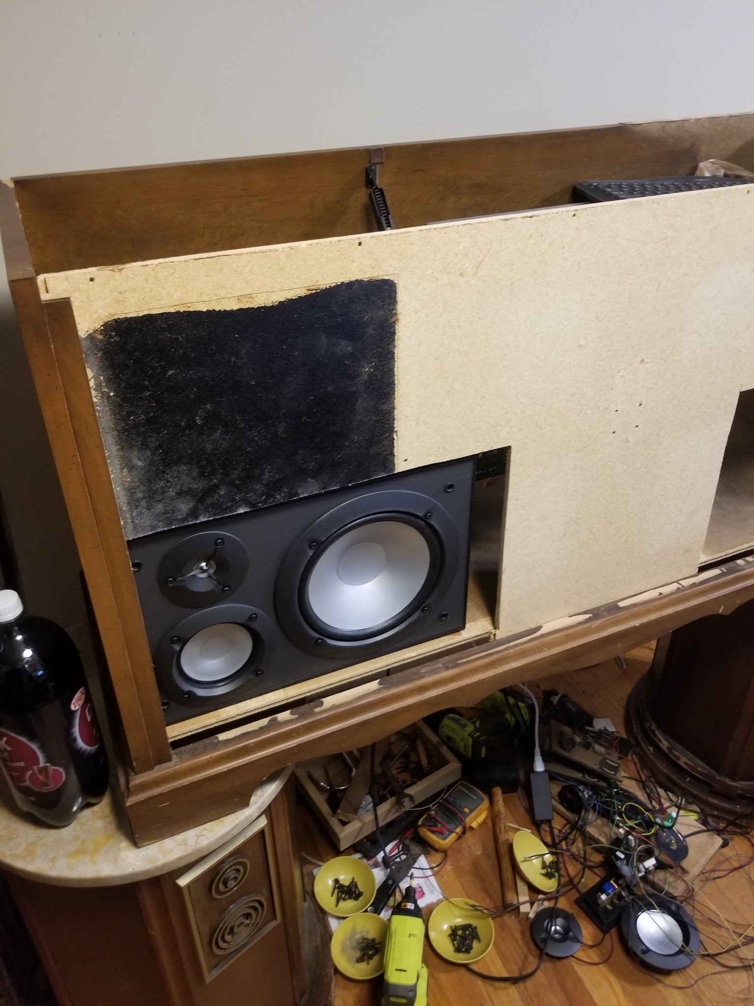

Here are a few pics of this thing. It is going to be forgotten about for a few months as the wood shop is not climate controlled. (under the car port.)
Maybe I'll recap the Empire Grenadiers.

As you are building them in, you could more easily just glued a bit of MDF to each side. Internally, a 1 inch dowel is a fine brace.
If they are sealed, you can measure the Q and see if stuffing would help the bass extension. You can usually squeak a good 5 Hz Fs that way. You do it by MEASURING THE Q, not some WEB calculator.

I have never heard of using closed cell foam as fill in a speaker. Sometimes on the walls. Open cell foam is normal. If sealed, fiberglass ifs fine, but the preferred material is synthetic stuffing. Cheap pillow stuffing works OK, but the stuffing sold through places like Parts Express is better. Cheap. One can stuff a box to get about 1/2 Q out of it. It also helps reduce the reflections back through the cones.
How much stuffing and how dense you only know my measuring the response or Q.
