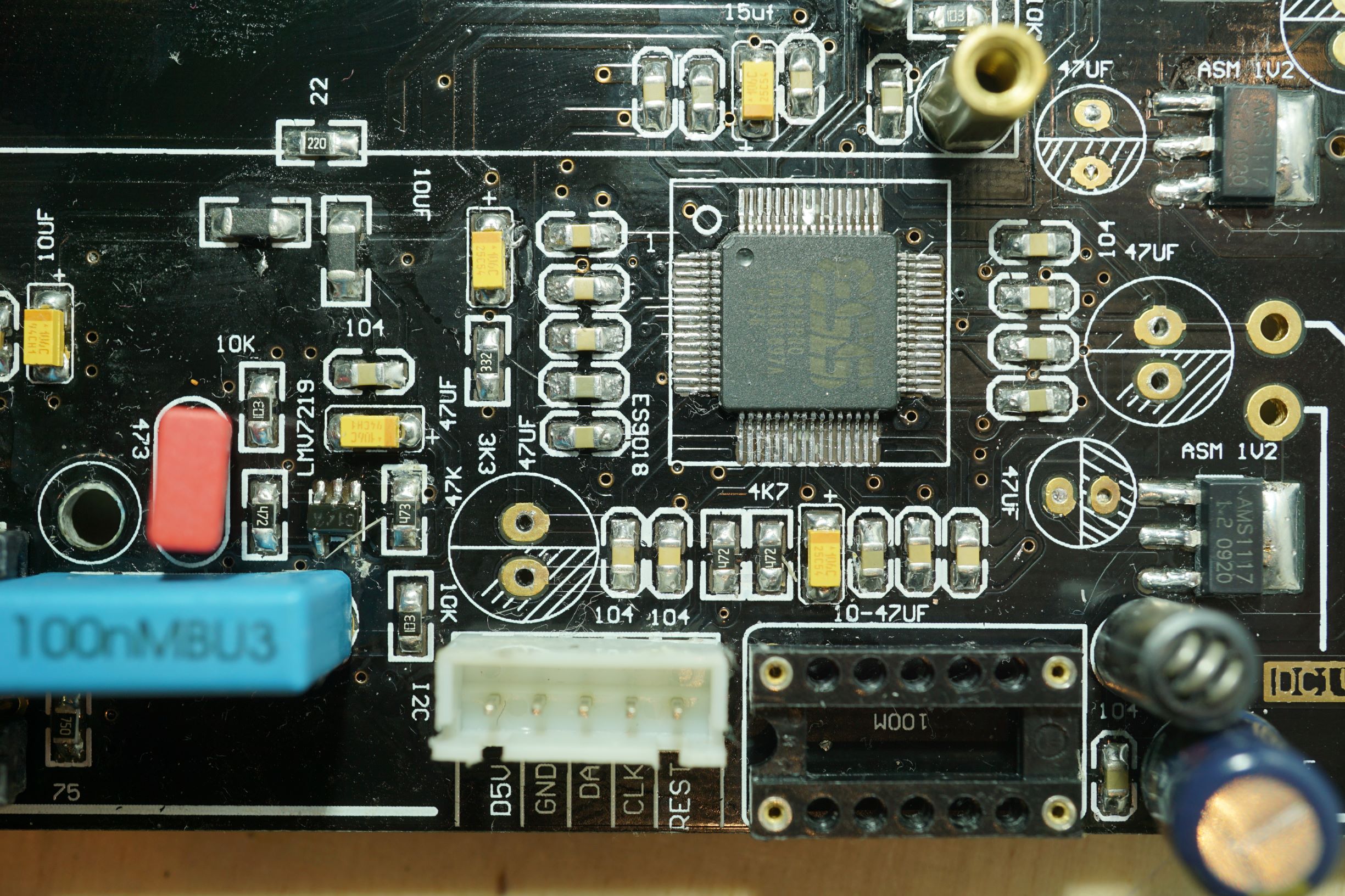

That looks better than many of the other es boards I’ve seen, looks much more diy friendly anyways.
I have a similar ak4495 board that shares some of the regulators.
First thing I would do would be to straighten out the loads on the onboard regulators before getting wrapped up in any external regulation schemes. The differences between what is provided and some of the super low noise regulators will be washed out in the application.
The LT1963 will work with an output capacitor that has an esr as low as .050 ohm, and the smaller ams1117 will work with capacitors that have an esr as low as .300 ohm.
What I have found to work well is to use something that has values like this with each part.
The Sanyo Oscon 47uf is going to be more well suited to being placed after the LT regulator than after the smaller ams part.
The ams1117 I have found will work well with a 100uf, 16v, starndard electrolytic such as a bc 037 for example, or the Nichicon VX.
That along with putting a .01uf COG on the clock for decoupling will make a nice difference, and there is still likely much to be gained from the output stage as well.

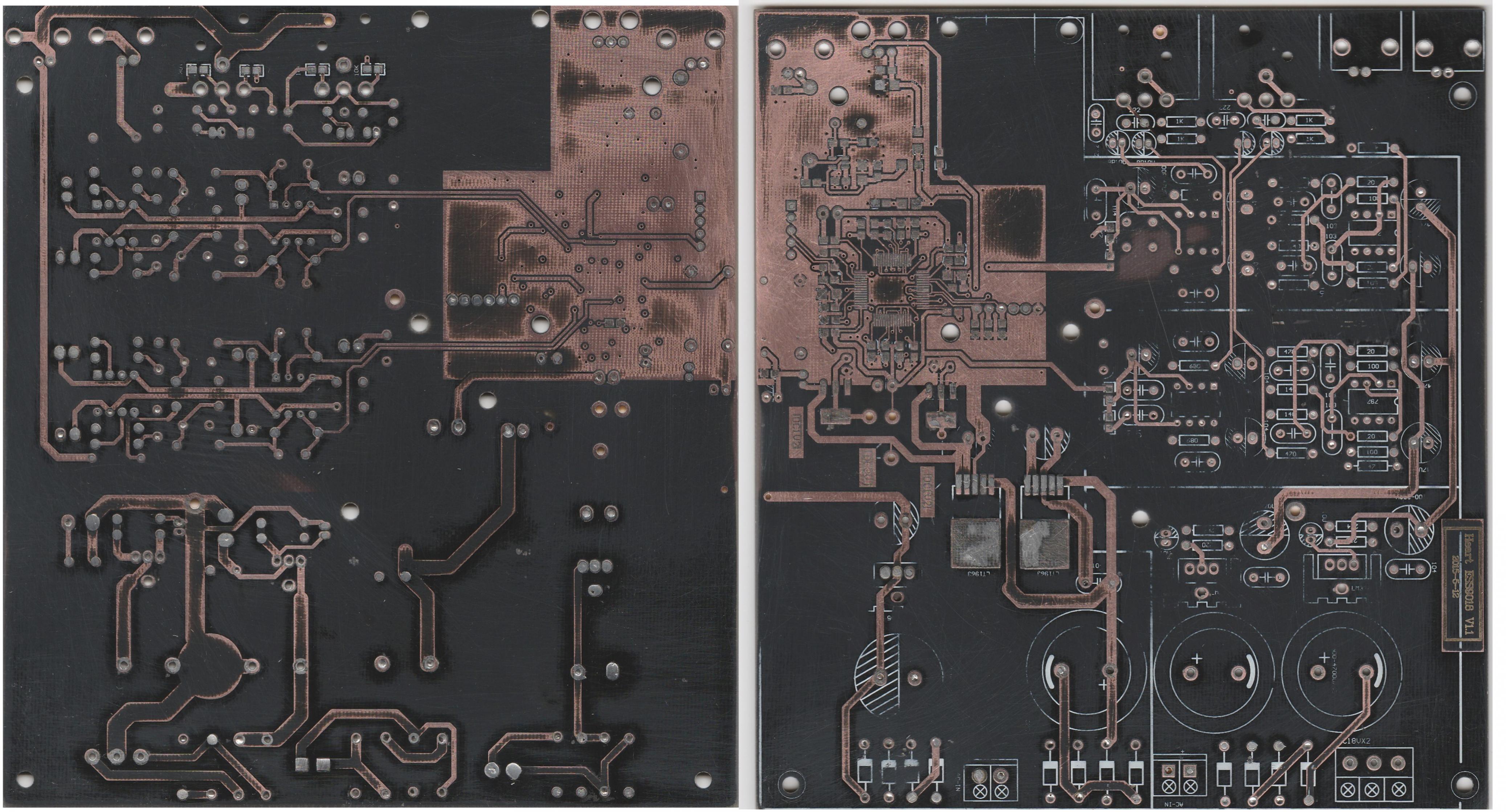

Grounding layer appears to be missing on the PS have not checked the rest . Good job, uncovering the outer layers though.

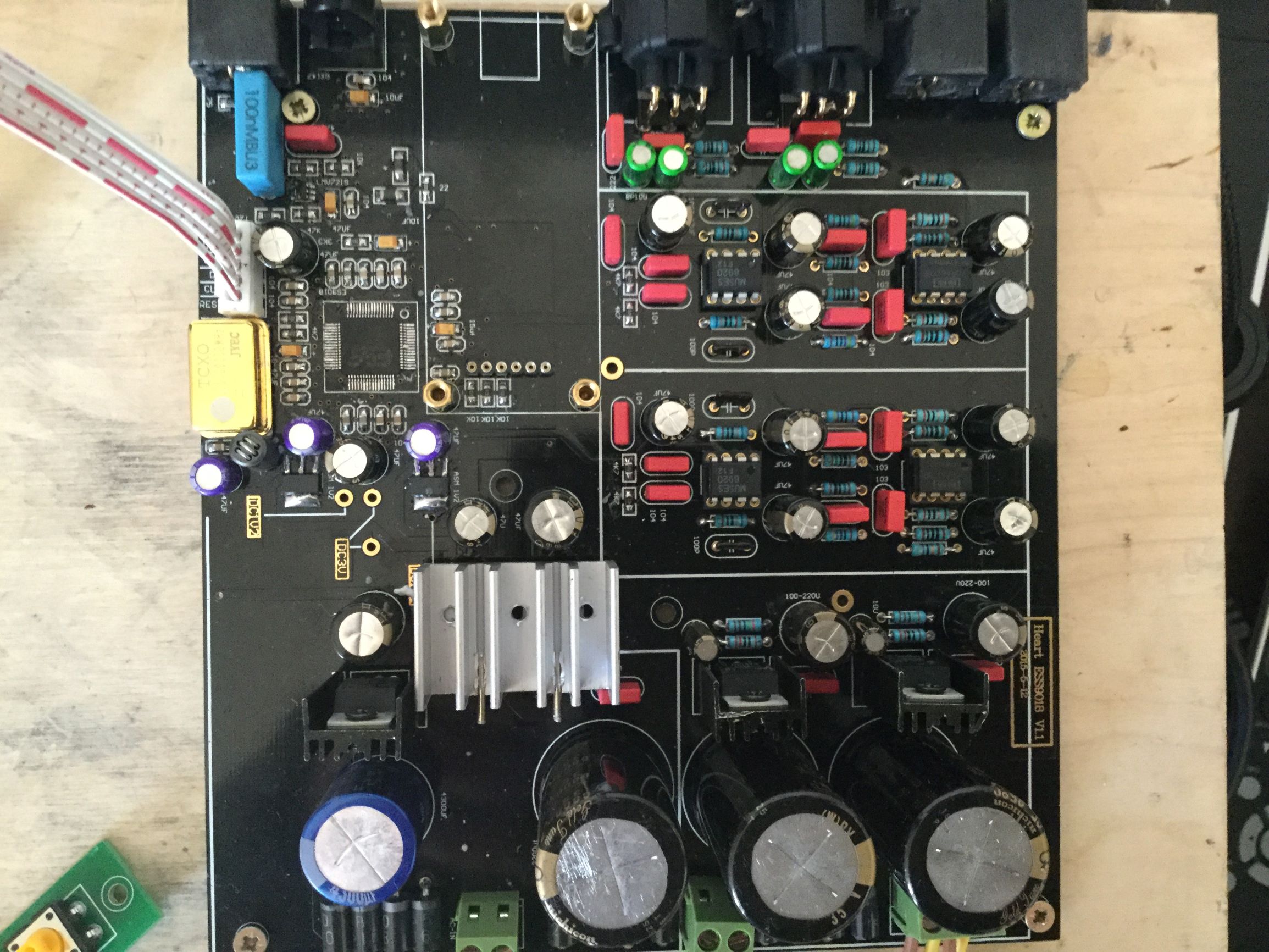

Here is what I have done so far with mine and from there I changed the AD817 to an AD797 which sounds superior.
https://www.diyaudio.com/forums/digital-line-level/314935-es9038q2m-board-328.html#post5619723
Tbh I have no idea about the other layers. I got ahold of a faulty board with a short circuit between layers, so could use it for educational purpose.

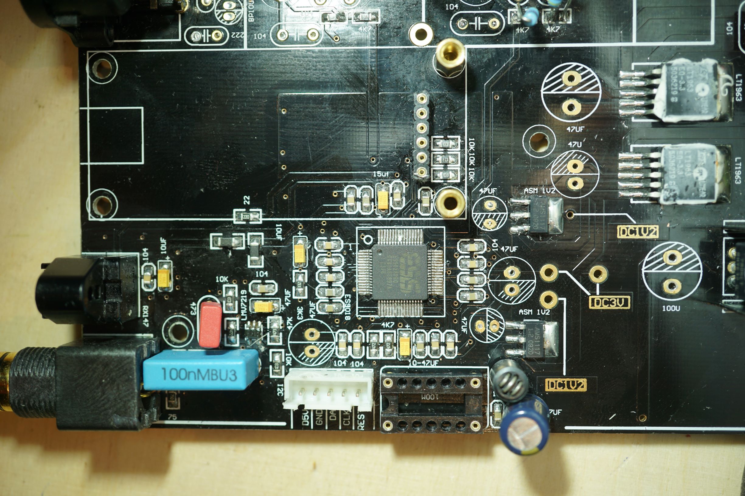

So far I have upgraded the following:
- Clock changed to Crystek CCHD 950
- burson v6 opamps
- Changed Wima MKS capacitors to MKP.
- replaced counterfeit mika CDE capacitors with original CDE 1% 100 pF.
- fake Elna Silmic II are still there waiting to be replaced with originals.

I have had great results with using a combination of Siemens KS, or EMZ polystyrene along with the Wima FKP2. Looking at the circuit, I will place the polypropylene caps in series with the signal path, and the polystyrene in the shunt positions to ground.
This has given a nice balance of punchy bass, with smooth airy treble, at least in my experience/opinion.
Those 100pf can be swapped out for better parts too...
I didn’t see any local bypass on the op amps when I looked at the boards, if you can, try .01uf film caps under the sockets, directly on the pins.
...I didn’t see any local bypass on the op amps when I looked at the boards, if you can, try .01uf film caps under the sockets, directly on the pins.
Not recommended if you have upgraded to AD797.
In that case you would have more work to do, as I recall those need additional high/medium esr parts on the pins and also tied to a ground plane that needs to be very close. I try to do that with bipolar op amps if I ever use those.

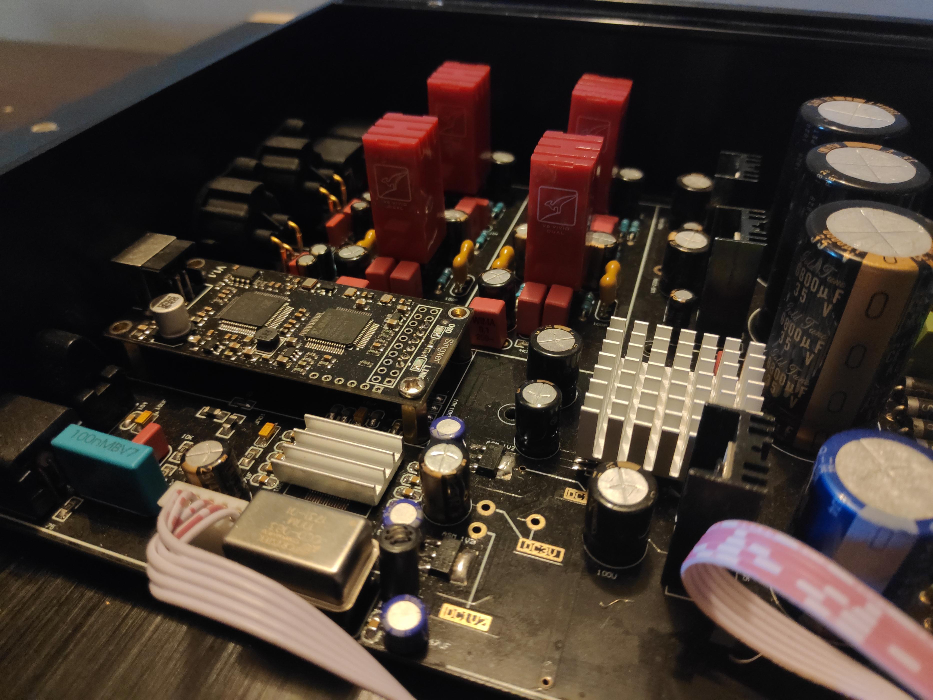

As far as the output stages for any of these Sabre dacs goes, the output stage we recommend using in the 'ES9038Q2M board' thread should work quite nicely so long as the I/V resistors are scaled appropriately. OPA1612 can handle the current from a single ES9038PRO channel. Don't forget enough stacked film caps on the +-15v rails. 100uf per rail has served quite well for ES9038Q2M dacs, have to see if still sufficient when using ES90038PRO with higher currents. Likely okay.
Is there someting wrong with the original output stage with busron v6 opamps?As far as the output stages for any of these Sabre dacs goes, the output stage we recommend using in the 'ES9038Q2M board' thread should work quite nicely so long as the I/V resistors are scaled appropriately. OPA1612 can handle the current from a single ES9038PRO channel.
The SQ is quite ok for me. Still didn't clean the power supply though.
seems a huge capacity for film caps, There might be a problem with space, not sure they would fit. would electolitics work instead?Don't forget enough stacked film caps on the +-15v rails. 100uf per rail has served quite well for ES9038Q2M dacs, have to see if still sufficient when using ES90038PRO with higher currents. Likely okay.
I have not heard Burson opamp, and the output stage might be okay. Don't know. I find the dacs tend to sound better with more output stage filtering than many designs use. The output stage we use for ES9038Q2M has good filtering and all good components, is all, so you kind of know it will will not be worse and might be better than what the dacs sometimes come with stock.
Also, elctrolytics did not work instead of film caps when I tried it. I used 10,000uf, .053 ohm ESR electrolytics and they sounded bad compared to 110uf of film caps. I don't know if it really takes a whole 100uf or so of film caps though, I only tested the bunch of those that were already soldered together. You could try will less and see how many you need before there is no benefit to adding more.
680 ohms seems very high I/V resistor. 220-240 seems more appropriate for 2Vrms out, and obviously the capacitor value should scale (upward) accordingly. With 10mA output current available from 4 DACs per channel, 680R would be really the wrong choice.
This is an output stage meant for some other, lower current DAC that has been transplanted into this circuit by the 'designer'. Not that you should expect anything more out of these kind of products - and I wonder if anything at all is optimised correctly for the ESS chips.
