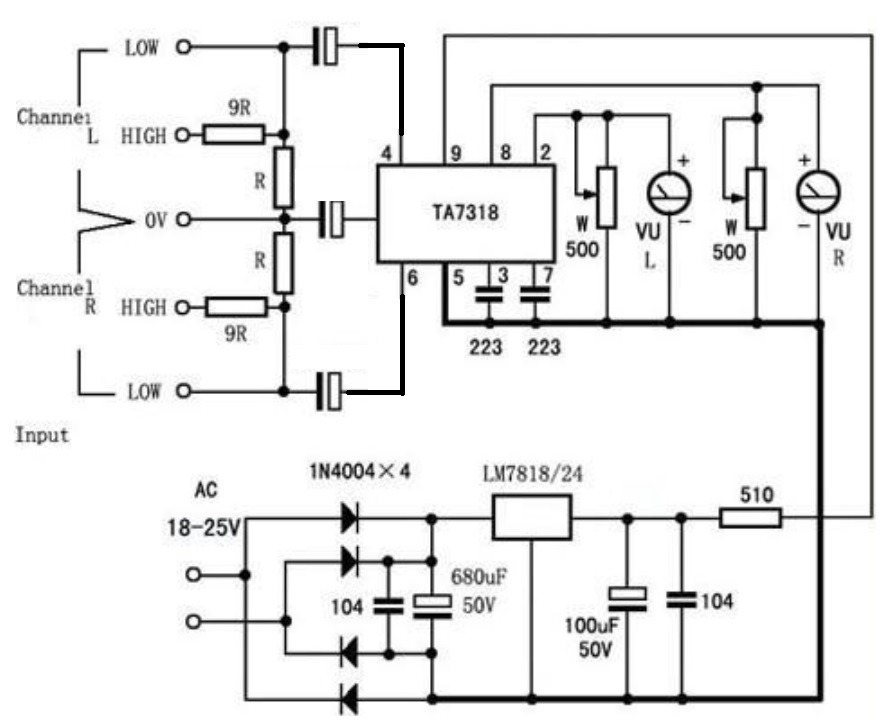

Does anyone have experience with these cheap Chinese VU meters and the driver board. I want to use it on the line level of the preamp, between it and the power amp. But I'm getting nothing no mater how I turn the two trim pots......Any help?

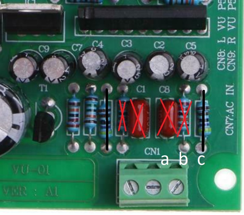

1) You have wired the RCA wrong (short signal to ground, reverse ground and signal,...)
or
2) the signal applied to RCA is too low (much lower than the noise you produce with your finger)
Assuming 2) is the case and looking at the attached (similar, not exactly yours) schematics:
- first, notice that it is possible to adjust the potentiometers in such a way they will short the vu-meters, so make sure you are not in that situation: disconnect power and the vu-meters and with an ohmmeter connected at each vu-meter connection, rotate the corresponding potentiometer until the measured resistance is maximum. Once you will have some Vu-meter movement you can readjust this.
- second there is a divider/attenuator at the high input; your board does not have a low input; an even better schematic would be to replace the fixed divider at the input with a potentiometer at least until you figure things out.
a) remove C8 ( C1 for the other channel)
b) remove Brown Brown Black Brown Black ? (really not sure, better see attached picture) resistor
c) short the Green Blue Black Brown Brown (not sure, better see attached picture) resistor
Make sure you don't put some big DC component (static or transitory) at the input.
I am surprised to see no resistor between pin 4 and 1 and no resistor between pin 6 and 1 of the IC on your board
