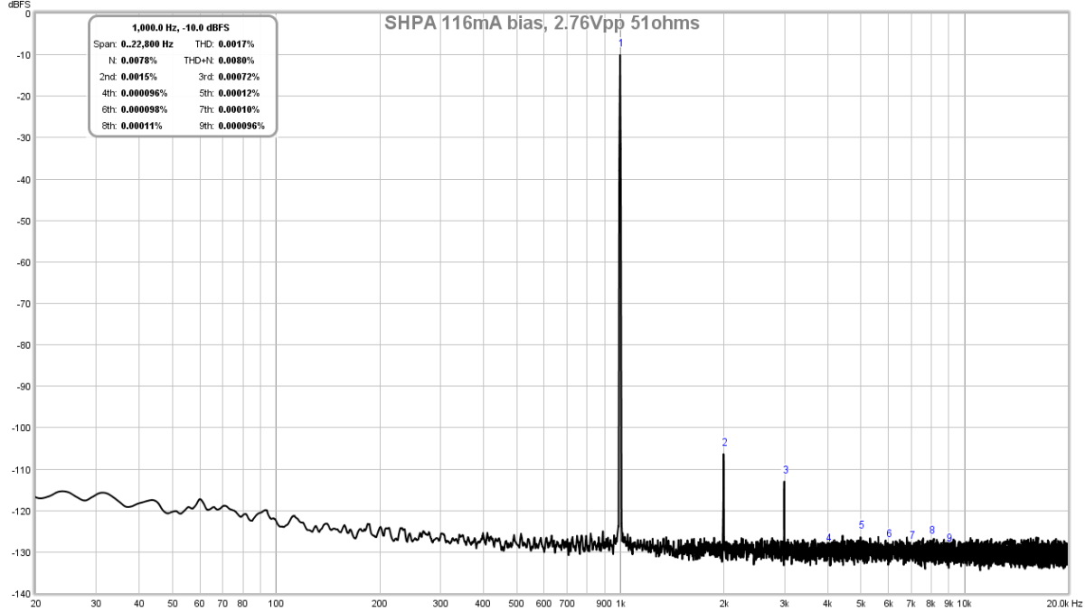

I notice that liner regulated PS for power amplifiers are very rarely used but anyway decided to go this route. I can’t find anything wrong with 10 A, 3 uV noise and ripple, 0.15 V dropout and 40 uΩ output impedance super regulator that I’m using with my amplifier build. It’s only slightly more complicated than a very good capacitance multiplier, but incomparably better in performance.
On my headphone amp I used a 12v linear wall wart supply feeding a Traco +/- 24v DCDC switcher which then went to a TPS7A4XXX low noise regulator. This then fed a mosfet cap Mx and that was then filtered by a CRCRC. I adjusted the regulators to get +/-18v after the cap Mx (circa 4v drop). The result was a supply that was quiet like a battery.

And I believe that to this day, this is the quietest PSU I have ever made or measured. I still wonder if I should have put the cap Mx before the regulators though…
Here is FFT:
699790d1535317831-simple-performance-dc-coupled-class-hpa-sub-ppm-thd-shpa-gb-verif-build-fft-1-03vpp-51ohms-png
699791d1535317831-simple-performance-dc-coupled-class-hpa-sub-ppm-thd-shpa-gb-verif-build-fft-2-78vpp-51ohms-png
Of course, superb layout by JPS64 is also key to achieving this kind of performance.
