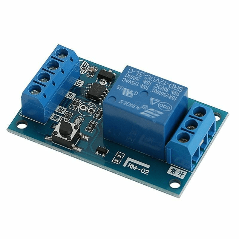

I use a light up momentary button for power on my builds connected to one of these:
https://www.ebay.ca/itm/222483418790
