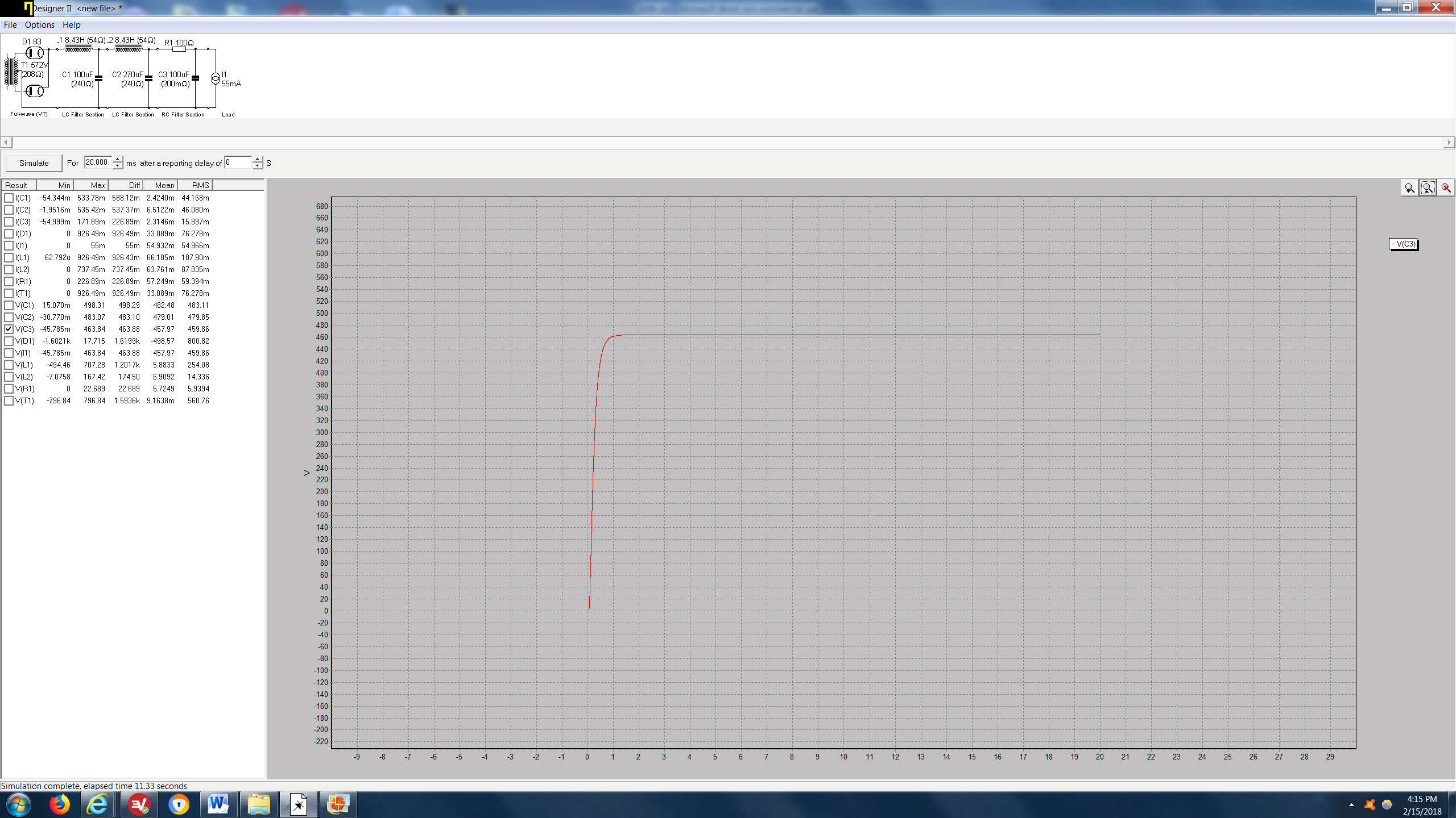

I would like to build a choke input power supply for a 300B project that I am working on. I will be building dual mono power supplies on one chassis dedicated to just the B+ and DC filament supplies. This supply will use 2 large Freed power transformers with 520-0-520 volts at 250 mA and 375-0 volts at 35 mA secondaries on each transformer. This would appear to be overkill, but I have them on hand. I figure that I can use the 520 for the 300B B+ and the 375 for the pre tube B+. I was hoping to use a choke input filter to bring the voltages down to around a 420-430 volts B+, and was playing with PSUD-II to figure out what that looks like. The 4 chokes I have at hand are all the same, and are very large and heavy. They are vintage, and I can't find any info on them based on their markings, but they appear to be quality swinging chokes. They measure 54 Ohms and 8.43 Henries on my multimeter. I have built many capacitor input supplies, and modeled them on PSUD II without issue, but never a choke input supply. I have attached a PSUD II simulation that is not the usual quick rise and wiggle free curve that I'm used to. Obviously I'm missing some important component here. There is no way that the result in the screenshot is a desirable one. I know that voltages are too high, but I used a very low drop rectifier in the example, and can switch it to another. I hope to run the 300Bs at 350-360 volts plate to cathode, and at -75 volts on the cathode for a total of around 425-435 volts (50-60 mA), and would like to use the components that I have at hand. Any advice or references that will explain what is going on, and how to fix, it would be very appreciated.
Not exactly my realm but I will guess that the wiggles are not 100Hz charging artefacts.
Calculate the characteristic LC section impedances as SQRT(L/C). For example...
SQRT(8H43/100uF) = 290R
In the above case you already have 54R from the Choke winding resistance so for 'critical' damping or concept thereof you need to add about 240R.
Put another electrolytic capacitor about 3 times the original, 330uF, in series with a 240R resistor in parallel with your original 100uF.
Do the same on the second section and then on the final section...
SQRT(30H/47uF) = 799R - 595R = 200R with 150uF.
Hopefully that will either get rid of or otherwise tame the wiggles.
Oh... you do not get quick rises because you have big inductors. 8H43 and 100uF is at about 5Hz so guess your rise time would be about 200mS or longer.

Oh... and you might want to put the first damping section at the very beginning of things. When your input rectifier goes open circuit the first inductor is going to argue with being starved of current.
Are you going to use an indirectly heated valve rectifier as a means to minimise the initial voltage overshoot, or does the 300B start to conduct fast enough to load the power supply with a directly heated valve rectifier? PSUD2 can sort of show that risk by using a stepped constant current load with an initial vary low current level. I don't use 300B's so unsure of that performance.
PSUD2 can be used to assess ringing response to load transients by introducing a step change in constant current load from say idle load current to twice that value at a time when everything is operating steady-state (eg. after 1 sec). Your filter doesn't show any significant ringing when I sim it - mainly due to the significant choke DCR levels.
Power on oscillatory response from mains charging pulses is not likely to be an issue at all - and caution is required in viewing the sim waveform during that initial period as there are many non-linear processes going on that aren't properly modelled in a sim (loading resistance change; inductor inductance due to DC current change, diode resistance change due to heater warming up).
The sim also has a hard time with diode turn-off and on transitions due to the choke current - so caution is required in assessing any such sim waveforms. That's not to say that circuit design and layout should not worry choke input formats - as that format has large dI/dt transients - and so best to use tuned snubbers on the PT secondary windings (as per Quasimodo), and a small bypass cap on the output of the diodes to steer transient current back through the choke current loop.
Your supply could also use protection ss diodes in series with valve anodes, and a CT fuse, as there is a lot of grunt available.

updated choke input sim

Yes I suggest you don't worry about charging wiggles in your situation.
You may get some initial B+ voltage overshoot with directly heated diodes, but it sounds like you are putting in caps that would manage 800VDC surge.
Have a look at the diode PIV in the sim waveforms - they are about 1600V - you have chosen a 1400V PIV diode - can you see that spec in the diode data sheet? Either use a diode with at least 1600V PIV or slightly cheat and add seriesed ss diodes in series with each valve diode plate.
Your sim shows strange capacitor ESR values??

choke input sim
I tried two sims with stepped response. One with a 240 Ohm resistor in parallel with each of the original's first two 100uF capacitors, and one without them in place. It appears that there is a small wobble on the stepped response when there are no resistors in place, and no wobble with the resistors in place. There is still an issue with the PIV being exceeded of any rectifier that I have at hand. I have attached some more photos.
The capacitor ESR values (240 Ohms) were my way of showing a parallel resistor to the capacitor of 240 Ohms, as per MorbidFractal's suggestion. I'm not sure if that is the correct way of doing it, but there doesn't appear to be any other way of showing parallel resistance in PSUD II. Is there a proper way to do it?
Agreed - you need to use a different diode (eg. 5R4) or do the ss diode short-cut.There is still an issue with the PIV being exceeded of any rectifier that I have at hand.
That is the wrong way to sim a parallel resistance - there is no way to do it in PSUD2 (perhaps PSUD3 will provide that capability).

It's not easy to determine appropriate dampening for power supply LCLC type filters, because one end is receiving charging pulses, and the other end is sort of resistively loaded (an output stage is not a resistor or a constant current with respect to music signal transient loading). I suggest the stepped constant current load technique for PSUD2 is about as good an indicator as any - and I don't see your circuit ringing in my sim.
The short-cut method to raise valve PIV requires caution, as there are many ways a diode could have problems with PIV stress - so its only a short-cut to raise the PIV 'a bit', say from 1400V to 1600V. The ss diodes have to be similarly rated, so 3 1N4007 in series (with those diodes from the same batch) would be appropriate.

Ooooops. My bad. Perhaps I did not explain things so well. See the attached which shows the additional damping.
Your over-voltage on the rectifier diodes is ocurring because at some point they go open circuit whilst your input inductor is still trying to draw current. I've added a diode, catch, to overcome that problem.
You also have to consider the nature of the input voltage. If your filter had an input capacitor then that would charge to the peak line input voltage and you would expect the output voltage to reach a similar value.
In your case the input is an inductor and, with the catch diode in place the voltage is a full wave rectified sine. Your filter acts to average that voltage,

A standard uncontrolled diode bridge inherently includes a catch (or free-wheeling) diode - not sure why an additional diode would be needed for this application?

I note you are slightly wary about simulation results and possibly rightly so. It could be the case that the simulation loses the plot at that point and reports a false answer...
Either way the additional diode, D5, makes the apparent problem go away. I would be inclined to put it in for peace of mind.
