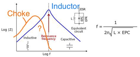

So a choke is really an inductor optimised for lower frequency range or specifically mains frequency?
The parasitic capacitance maybe higher than an inductor so it will reach self resonance frequency at a lower frequency?
Any ideas what a realistic capacitance or resonance frequency for a choke? I think it might be outside of audio range? If so, it’s a good choice.
Yes, that makes sense. It’s larger - I think - for the same inductance value. It’s a shame people have to struggle with data sheets. You go to all the trouble of manufacturing a part and you can’t be bothered to put a impedance plot on the page.

Simply because the current from a constant AC voltage source , like an amplifier , is much higher at low frequency where the reactive resistance is low . 2 x PI x f x L
So 100x more resistance and 100x less current at 1KHz vs 10Hz

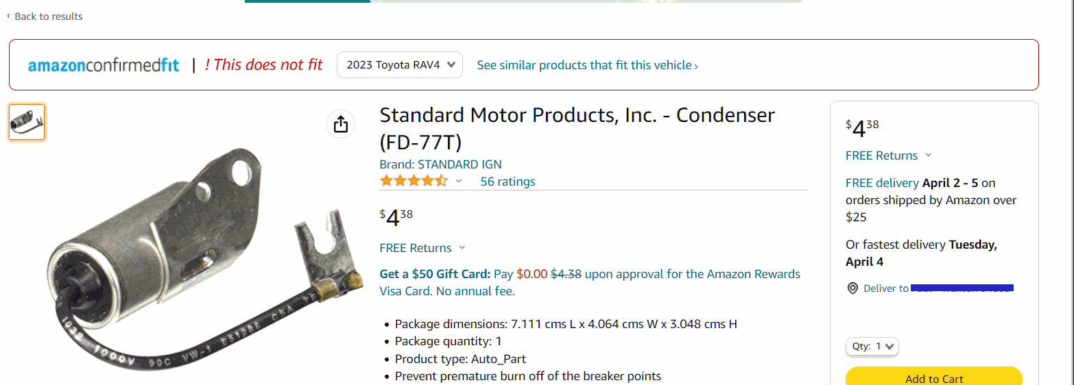

"Condenser" persisted in car spark systems long after fashion in the electronics field moved to "capacitor". Why? It is a funny language.
I dunno if spark-cars even have 'condensers' today; certainly not the new (this century?) Toyotas.
Inductor is a theoretical concept.
"Choke" comes from telephone systems. It passes DC (to power the microphone) but blocks ("chokes") the audio out of the battery circuit. Practical function, not theory.
