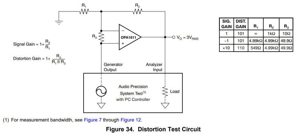

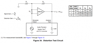

For Figures 4.22 and 4.23 the feedback resistances were 2k2 and 1 kΩ, so the minimum source resistance presented to the inverting input is 687 Ω. In Figure 4.24 extra source resistances were then put in series with the input path, (as was done with the 5532 in the section above on common-mode distortion) and this revealed a remarkable property of the LM4562 – it is much more resistant to common-mode distortion than the 5532. At 10 Vrms and 10 kHz, with a 10 kΩ source resistance the 5532 generates 0.0014% THD (see Figure 4.6 ) but the LM4562 gives only 0.00046% under the same conditions. I strongly suspect that the LM4562 has a more sophisticated input stage than the 5532, probably incorporating cascoding to minimise the effects of common-mode voltages. Note that only the rising curves to the right represent actual distortion. The raised levels of the horizontal traces at the LF end is due to Johnson noise from the extra series resistance. It has taken an unbelievably long time – nearly 30 years – for a better audio opamp than the 5532 to come along, but at last it has happened. The LM4562 is superior in just about every parameter, but it has much higher current noise. At present it also has a much higher price, but hopefully that will change.

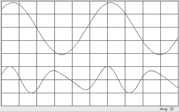

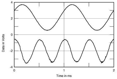

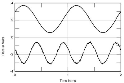

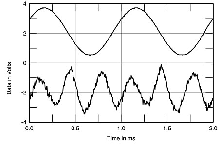

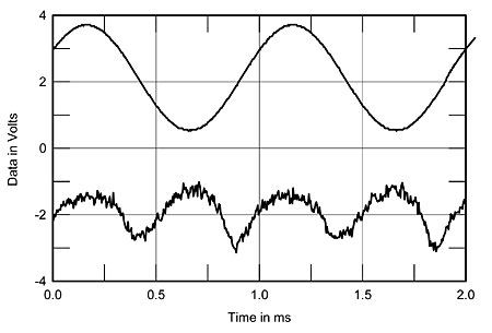

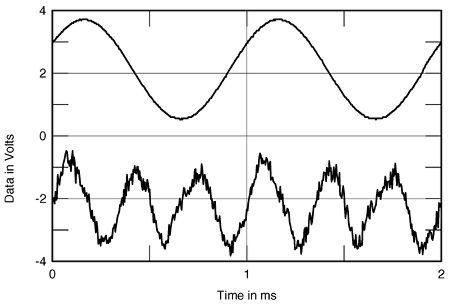

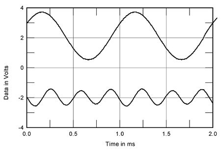

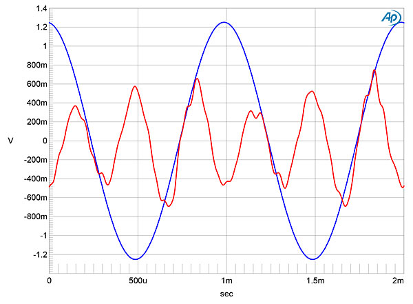

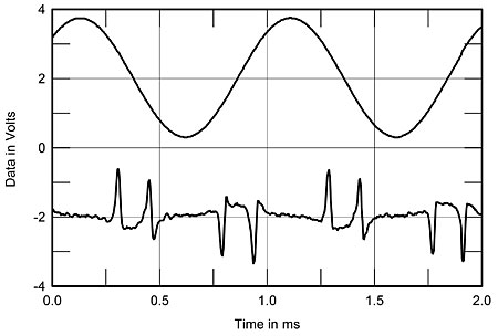

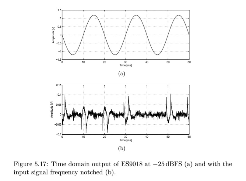

The biggest disadvantage of all these considerations is that all exist distortions (THD+N) are lumped together in the diagrams and no distinction is made between THD components e. g. of a low order (inaudible up to around 1-2%) and those of a very high order, which always occur even with extremely low THD+N levels are still audible - go to fig. 3 under
http://www-f9.ijs.si/~margan/Articles/Class_B_Dist.pdf
(The fact that these diagrams refer to power amplifiers in non-Class A operation and not to small signal stages with OP amps doesn't matter for these fundamental considerations - so I think).
Very helpful for choosing the right OP-AMPs would be a diagram with the distortion waveform character (fundamental notched out).
In the attachment are to find such diagrams from some power amps, which I have heard in the last years and even tested and measured in the US magazine "Stereophile" (with my experience today, I would know which of these models I would not even unpack and test ):
Pass Aleph 3
Pass Labs Aleph 3 power amplifier Measurements | Stereophile.com
Solution 710
Soulution 710 power amplifier Measurements | Stereophile.com
bel-canto-eone-s300iu-integrated-amplifier
Bel Canto e.One S300iu integrated amplifier Measurements | Stereophile.com
accuphase-m-2000-monoblock
Accuphase M-2000 monoblock power amplifier Measurements | Stereophile.com
balanced-audio-technology-vk-56se
https://www.stereophile.com/content/balanced-audio-technology-vk-56se-power-amplifier-measurements
Halcro DM38
https://www.stereophile.com/content/halcro-dm38-power-amplifier-measurements
Graaf GM200
https://www.stereophile.com/tubepoweramps/997graaf/index.html
Bryston 7B SST2
https://www.stereophile.com/content/bryston-7b-sstsup2sup-monoblock-power-amplifier-measurements
Bryston 3B ST
https://www.stereophile.com/content/bryston-3b-st-power-amplifier-measurements
PS Audio Stellar M700
https://www.stereophile.com/content/ps-audio-stellar-m700-monoblock-power-amplifier-measurements
If there are such diagrams with the distortion waveform character (fundamental notched out) at different frequencies (e. g. 100Hz-1KHz-10KHz-20KHz) and different levels on different loads, one would find with a probability bordering on certainty that only very few integrated operational amplifiers would be suitable for audio applications.
The NE5534 (so as the dual version NE5532) that Mr. Douglas Self favors for many applications in audio stuff, so as all other OP-Amps with two gain stages inside of the feedback loop (even the OPA627/637/LT1028) are unfortunately not included therefore according sonic impressions of most listeners.
I have find out, that all integrated OP-AMPs with only one voltage gain stage (at whole a folded cascode so as an buffer stage) inside of the NFB loop provide good results on listening tests.
My favorites in RIAA phono and line pre-amps so as power amp front ends are AD797, AD817/AD825 (dual version AD826) AD844 and AD846.
Even the OPA604/2604 so as OPA134/2134 provide better results than OPA627/637, OP27/37 or LT1028 from the view of most listeners.
I don't know, why two gain stages inside of the feedback lope (like the circuit topology of "BLAMELESS" power amp are a disadvantage for good results on listening tests, but I guess, the THD waveform character is nearly triangular instead of sinusoidal.
By compare a OPA604 or AD817 against a OPA627 or LT1028 in a line stage of a preamp at a listening test the audible differences are similar to those by compare a Pass Aleph 3 single ended class-A power amp against a Bryston 3B or PS Audio M700 power amp (check out the attachments).
Whoever of the experts of measurement technique could create and post these diagrams for the most popular operational amplifiers ?
These have a much greater significance in relation to the sound character perceived by most music listeners than the most showed diagrams with THD+N vs. frequency.

TI/Burr Brown has been going nuts over the past decade. The designers keep one-upping each other to the point that the latest Audio Precision test gear can't measure the distortion without a test bench to degrade the performance. They use a test circuit that causes the error voltage to be 100x larger.
Here's their latest, the OPA1611, with 15u% THD (!), and 1.1 nV/rtHz noise. Cost for the 1611 is kind of high at $3.02/amp in 100 piece quantities, but not crazy. I've never heard these, but I want to. Also comes in a dual, the OPA1612.
https://www.ti.com/product/OPA1611
