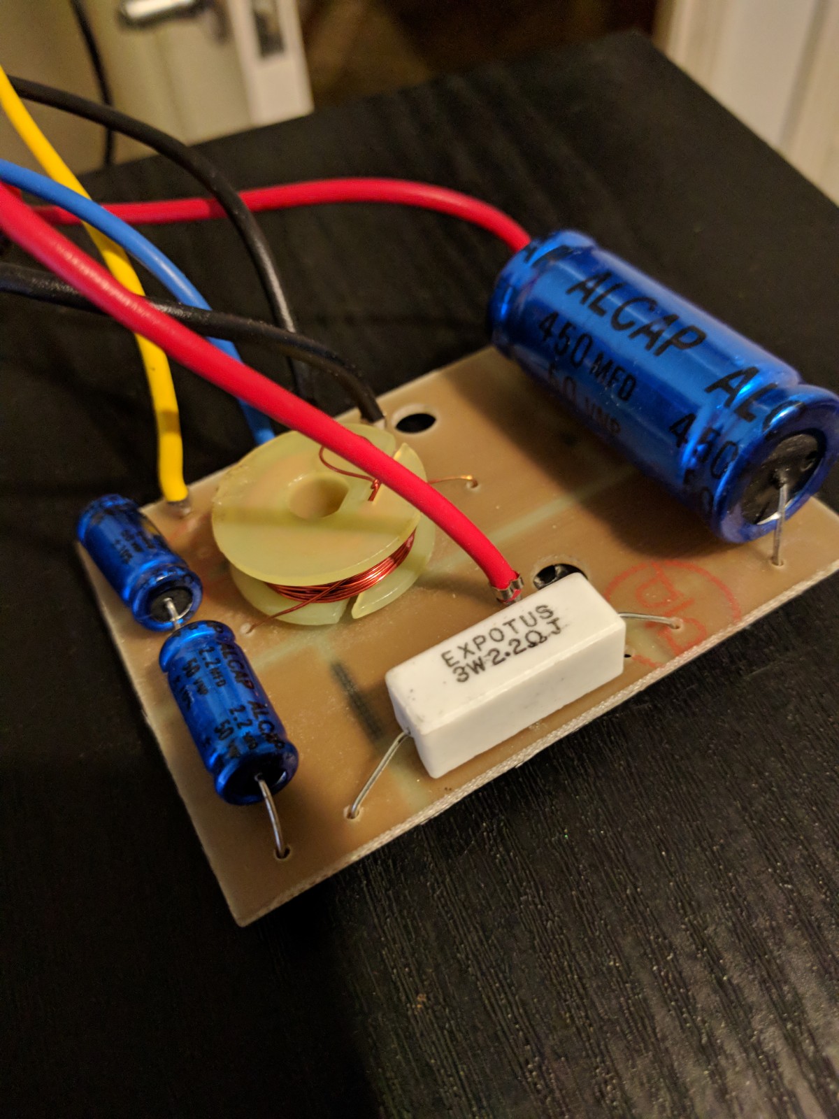

As I have no electrical training and limited experience, initially my aim is to upgrade either poor quality crossover parts in modern Loudspeakers, or to replace deteriorated crossover parts in vintage Loudspeakers.
I understand that the correct way to build crossovers is by testing Loudspeakers and designing the crossover to balance any deficiencies, but until I can do that, I'd be sticking to the manufacturers specs, unless a Poster has had positive experience on a design for a given Loudspeaker model, they might share.
I have a number of Loudspeakers here I'd like to experiment with.
Heres an example.
Wharfedale Diamond 3
The nasty crossover parts include:
XPOTUS 3w 2.2ohm J
AP ALCAP AL 450 MFD 50VNP x 1
AP ALCAP AL 6 MFD 50VNP x 1
AP ALCAP AL 2.2 MFD 50VNP x 1
Air Core Inductor with almost hair thin guage copper weinding.
What parts would you upgrade these to?
thanks
C

For caps either will work, Al is cheaper easier to source, but really you should be looking at the ESR in the datasheet.Which metal? Is copper a good choice?
First hit on Google for me.What does E6 & E12 refer to?
Not my point, which is that if a 3.7uF cap is needed you'll have to parallel 2.2 and 1.5, as 3.7 isn't even E24.By paralleling them do you mean 2 x Caps @ 50 microfarad, instead of a single Cap @ 100 microfarad and does this result in higher power handling?
Huh? Its a high-current connector rated to 40A, brass not steel (unless you go for cheap chinese copies - that's worth noting!). And no connector can improve sound, the best you can expect is no degradation of the signal. And so much more convenient that terminals...I thought Speakon terminals are good at proving a secure connection, but don't necessarily improve sound???

I read somewhere that brass is only one quarter as conductive compared to copper.
If the Loudspeaker terminals were of brass, wouldn't this impact the the sound?
No.If the Loudspeaker terminals were of brass, wouldn't this impact the the sound?
Your loudspeaker probably puts out 20% HD (harmonic distortion). distortion of a brass terminal is trivial.
The only speaker with a HD spec I've ever seen is one I own. It sounds really good at 1W or less. The spec is 2nd harmonic 20 db down from signal all frequencies 54 hz-14.5 khz. What's that, 12% HD?
If you really want to improve the crossover, 20 year old electrolytic capacitors are low hanging fruit. The rubber seal breaks & they dry out, at some point. Depends on the quality of the rubber they vendor bought, reflected in the service life in hours of the cap. I've found no electrolytic NP caps with a service life quoted on the datasheet.
Polyprophylene caps are now small enough they can be squeezed in on most crossover boards. Those last forever.
Another low hanging fruit is the speaker wire. On really difficult material (top octave solo Steinway piano) I hear pitch instability on 6.3 m of 16 ga zip cord. The name of that is intermodulation distortion. I do not hear that on 2.3 m of 10SO3 cord. Each 10 ga conductor is 400+ strands. It was salvage from the dumpster, but you can buy some from industrial supplies for much less than the "audio grade" phoolery. Made for hooking up 1 hp 3 phase AC motors. Make sure you can hear the problem before wasting money. Most males over age 10 have ruined their high frequency cilia already with fireworks, guns, motors, or loud "music"
Keep in mind that the capacitor ESR in the tweeter circuit was likely factored into the final acoustics of the speaker. High ESR electrolytics will attenuate the treble output. If you replace with a same value film capacitor (w/ near zero ESR) the tweeter will play a louder. May be a good thing or it may sound horrible. This can be fixed with a series or shunt resistor pad but it is a factor you should be aware of. You will be a step ahead instead of "Why are my tweeters so bright?".

100 vac on 8 ohms is 500 W. It is very unlikely you are going to drive the Sounddynamics speaker with that much power. Probably rip the woofer suspension & burn the tweeter. So no, a 60 v capacitor is probably fine in a home speaker run @ 1 W average, maybe 60 W peak. Select your cap voltage from the P=(V^2)/Z formula. P is your amp max rms power. Z is nominal speaker impedance, usually about 120% of the resistance.
1" tweeters don't get much respect over on PA systems. I have a pair of KLH23 that have a 2.5" paper cone tweeter, sounds rather nice actually. Probably cost a whole $2. Especially if the 1" tweeters you have are really piezo mallories or copies instead of real silk dome, which I have heard a few nice words about. Hole in the middle of the response curve is a problem. Also smaller tweeters don't disperse the highs evenly over a wide set of angles from dead front.
Loudspeaker design is an art, and to Speaker's point, wrong ESR can change the balance of the drivers radically. To my point in post 11, dried up electrolytic caps go high on ESR, so measuring 20 year old electrolytic caps for ESR won't tell you much of anything. If the electrolytic caps meet the specs in the Peak meter book, that means you have another couple of years or maybe more or less on your old caps.
Film caps will only affect driver balance if the electrolytic caps in there are out of spec. Polyprophylene gets a lot of respect from John Curl for linear DF, which is nice, and if your driver's are world class, you might be able to hear it.
Speaker drivers are highly inductive except for piezo tweeters, or rareties like the capacitive magnaplaners (which you don't have) so I wouldn't worry about wirewound impedance much.
If you really want to get in this, invest in a non-echoic chamber, a speaker tester mike, and some sweep and analyzer software for a PC. Parts-express here has a nice package, but your AUS vendor probably has a nice package he can order from somewhere closer than Ohio.
Remember, every bit of fluff you took out of your speaker to reach the crossover was there to break up standing waves. My KLH23 didn't have any, but they were $99 speakers new on closeout. Wharfdales had a bit more of a reputation at one time.

TBH I'm not sure they are worth "improving"
That big cap is there to limit the amount of bass getting though to the woofer and to sound balanced the top end is also pretty limited.
So why spend $100- on good components when you won't get a big benefit?
I personally love tinkering but I like to see a real improvement when I spend money of parts

Also, at the very least, junking the sandcast resisters for quality replacements at $4 a pop, isn't this worth doing?
Regarding caps, if they were replaced what voltage is recommended?
thanks
C
Cliff, have you been to LSK?
The Loudspeaker Kit
They stock a fair bit of PE's range, Dayton Audio, Peerless, VIFA, Scanspeak and SB Accoustics.
WES AUSTRALIA is another place has the same range and a extended range in SB Audience. I think they own LSK...
Thanks for the tip Harry.
I'll crawl over their site.
My time is limited but analyzing is the way to go.
Thanks for your tips.
By fluff, do you mean internal lining material?
