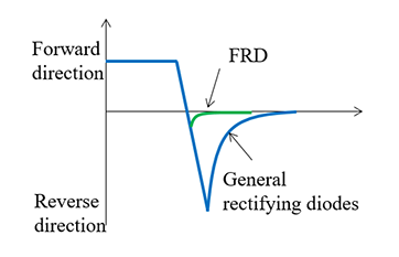

There are fast, soft recovery diodes that switch clean without introducing ringing. I would start there first.
Generally, diodes for high frequency applications like SMPSs have soft but fast recovery characteristics.
What are Fast Recovery Diodes (FRD)? | Semiconductor | SHINDENGEN ELECTRIC MFG.CO.,LTD
