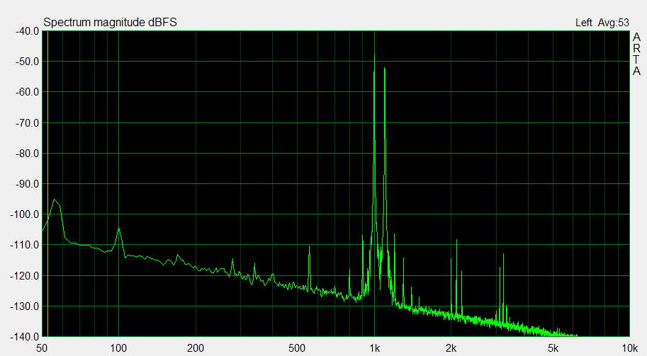

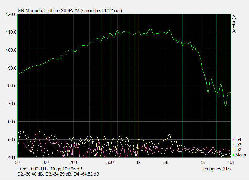

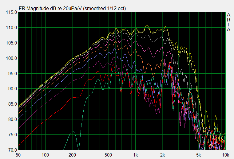

I am using the Eminence Deltalite II 2515 nude in a new open baffle project. I have to say this is a really nice driver for this application. High sensitivity, very smooth on and off axis response, and pretty good distortion figures. It has almost 5mm Xmax, which is plenty for my needs (I am crossing it over to subwoofers around 120Hz). I would not recommend using this in a dipole application for the lowest few octaves - it just doesn't have enough Xmax or a high enough Qts for that.
I'm attaching some plots of measurements that I took with the driver suspended from wires hanging in free space.
