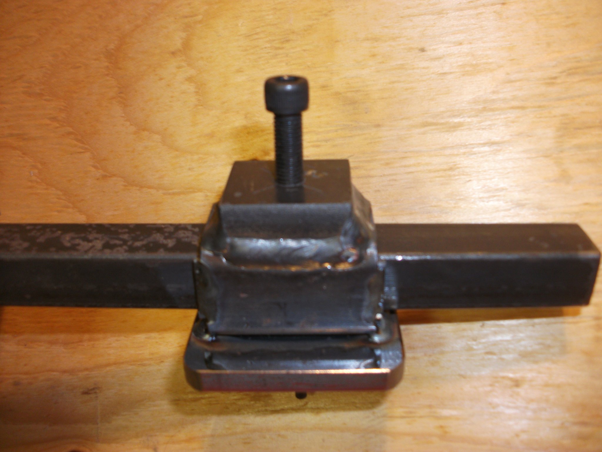

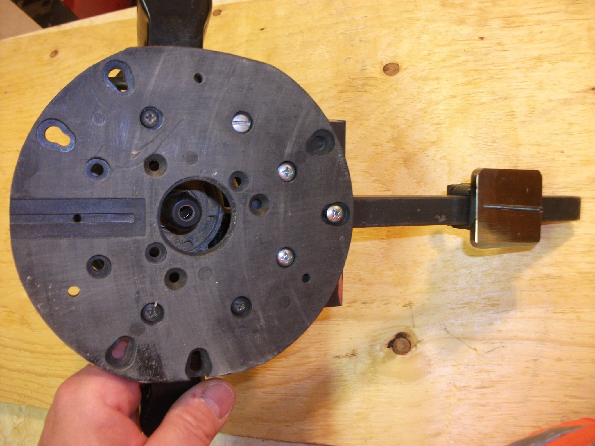

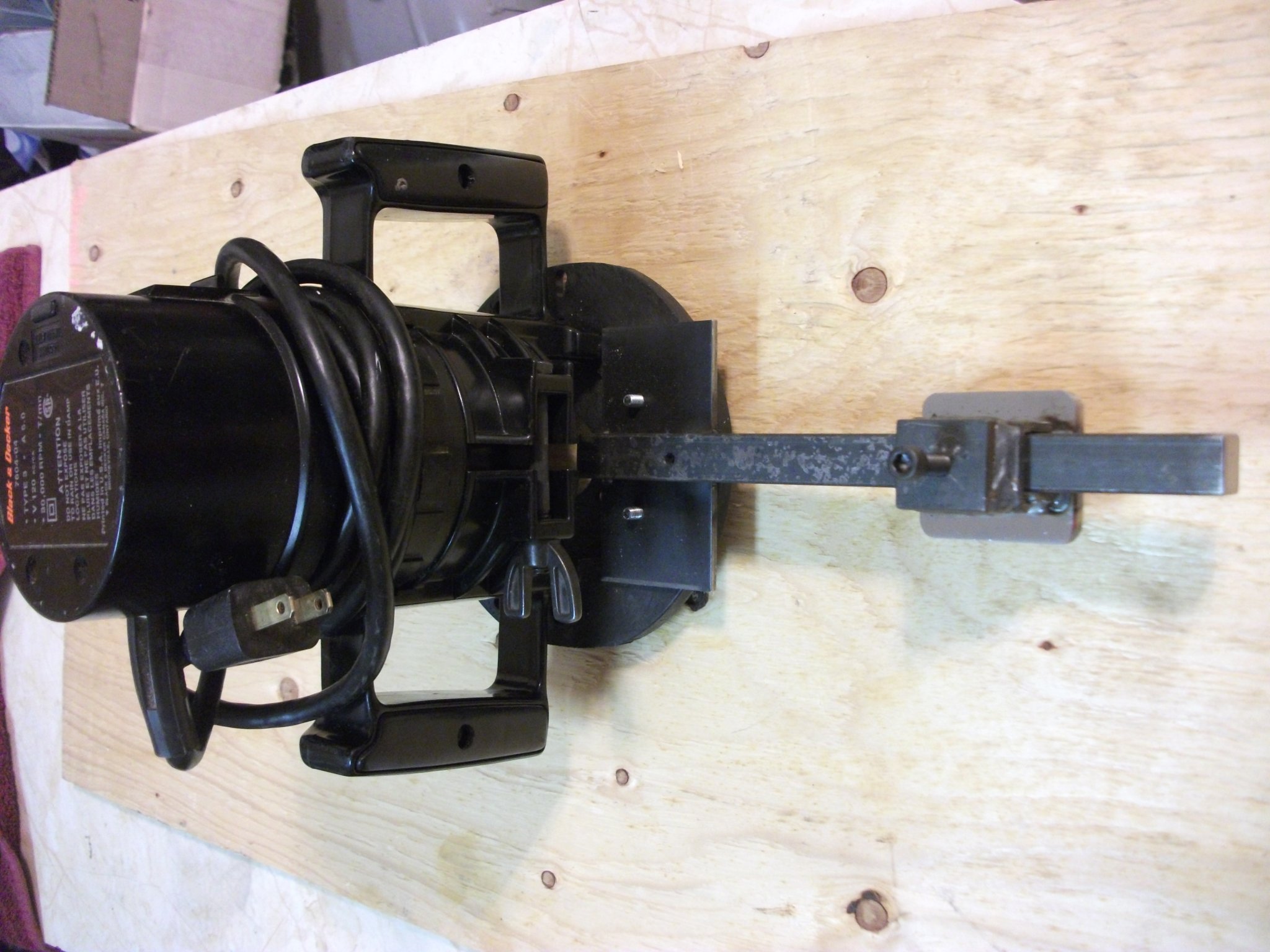

I only occasionally need to make speaker cutouts, so I couldn't really justify buying a circle jig. I made this little gadget at work on my lunch hour, and it's attached to an old 5 Amp B&D router, which is more than enough for the 1/4" end mills I use. Nothing fancy, and you have to set it by hand with a tape, but it gets me by.
