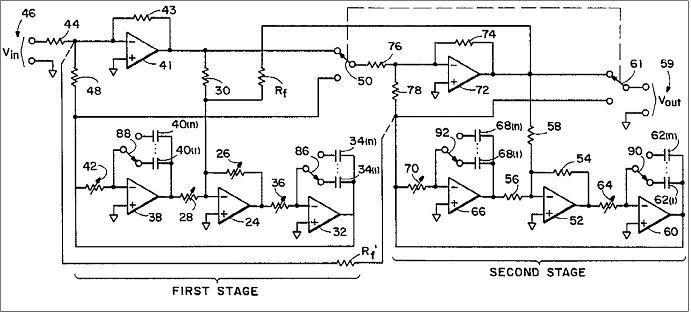

I've been doing some more digging and found the following AP patents: -

4,631,522
Method and circuit for compensation of a multiplying digital-to-analog converter
4,614,914
Low-distortion transformer-coupled circuit
4,563,652
Dual-stage filter with feedback
As typical with US company’s, they seem to Patent the obvious - in an attempt I guess to increase the IP value of the company, see 5,265,201 Master-slave processor human interface system for a good example.
Anyway, Patent 4,563,652 Dual-stage filter with feedback seems to describe the AP Notch filter - and expires in less than 1 year 🙂
