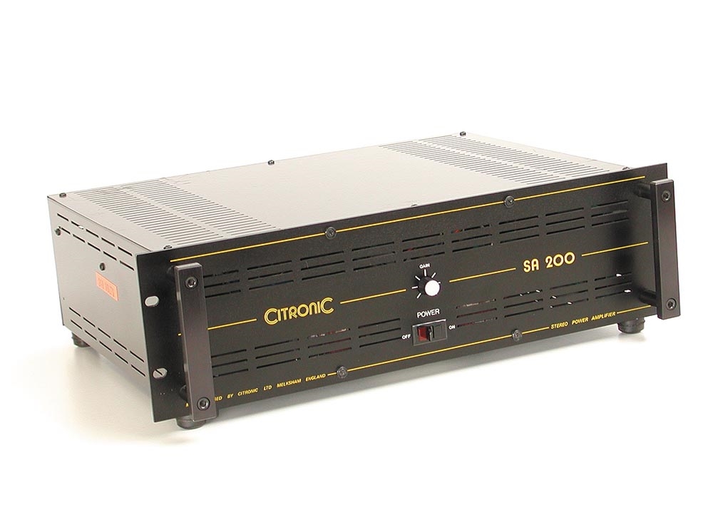

Citronic SA-200 amplifier
Have the option to buy one of these for cheap but can't find any information on the specs, was wondering if anyone had any idea about them/had any insight into whether this is a good amplifier (for use on small PAs for smallish indoor parties)
The Citronic SA 200 was made in the UK to a very high standard - not to be confused with modern Chinese equivalents.
These were solid, well constructed amps and conservatively rated. When it says 100W per channel, you can be sure that this is a continuous rating suitable for punishing disco use.

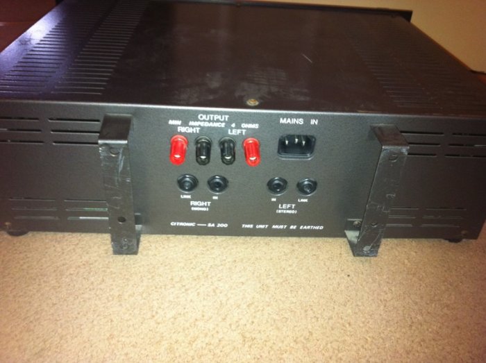

Re input jack sockets on amp, this is my interpretation:
The left channel output from your mixer must terminate in a mono jack plug. Same goes for the right channel output.
Each of the two jacks is then plugged into its designated left or right 'IN' socket on the rear of the amp.
So, update. I went and bought the amp and speakers as I couldn't turn it down for £100. After some trial and error managed to get it working. The speakers are passive and as far as I can work out they are unbranded so may well be a DIY job. Both the amp and speaker are fairly old and were once used to throw warehouse raves around the Bristol area. They are very distinctive due to the decorations on the grill (I'll post more photos when I find the time) so anyone from the area may even recognise them! The guy I bought them off said he thought they were 300W but was not 100% sure. To get them working we linked the RCA inputs on the speakers to the RCA on the amp, then ran an RCA to single jack into the LEFT (stereo) input which got both speakers working. Safe to say its all a bit of a bodge-job but as it stands it all works OK and the speakers go nice and loud without distortion (we have to have the gain on max as the dial is very broken). we opened up the amp and a sticker on the inside indicated the last service was in 1985... they really did used to build things to last.
Thanks for the update.
I think you mean you connected the RCA sockets on the speakers to the black and red 4mm sockets on the amp. But, hey, glad the amp and speakers are working!
Photos of the speakers and the internals of the amp would be most welcome.
