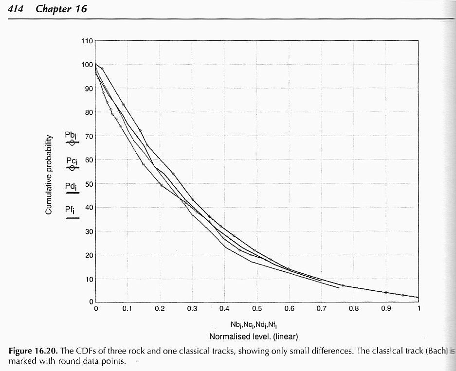

Self measured the cumulative distribution function (CDF) of signal level, of actual music. His plot is attached below. At the upper left, his graph says there is >95% probability that the signal level is greater than or equal to zero. At the lower right, his graph says there is <5% probability that the signal level is its maximum.
Put this together with your particular amplifier's dissipation-vs-level curve, driving your worst-case reactive load, and you get your amplifier's heat dissipation, while playing music and while driving that load.
