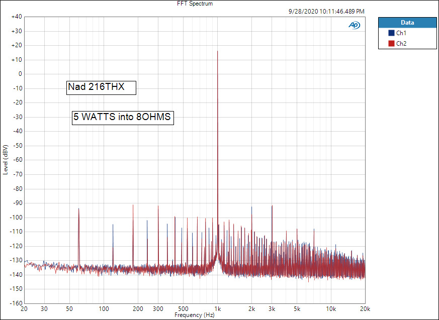

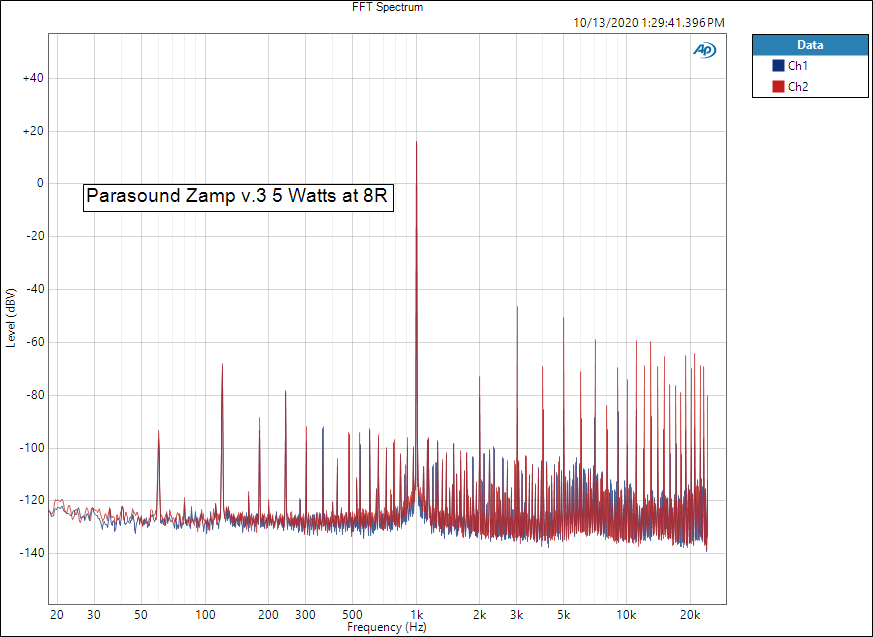

I have a question about power supplies for our old-time favorite Class AB amplifiers.
I have lately measured the THD+N of several amplifiers. Many, most if not all have with Full Wave diode bridge plus Capacitors even including inductors the power supply noise, you know the 50 or 60 Hz series, 60Hz, 120Hz, 180Hz and on up, of diodes turning on and off spikes dominate the THD+N figure. The power supply spikes are higher dB’s than the 3rd, 4th and 5th harmonics sometimes.
Switch mode power supplies in Class D amplifiers are quieter than the previous generation.
The question: Has anyone or does anyone use switch mode power supplies in old school Class AB amplifiers?
Just for grins here is a sample of a well behaved Full Wave diode bridge power supply in a NAD amplifier. I replaced with new the protection relay and all of the PS capacitors. Plus a not so well behaved example.
Thanks DT

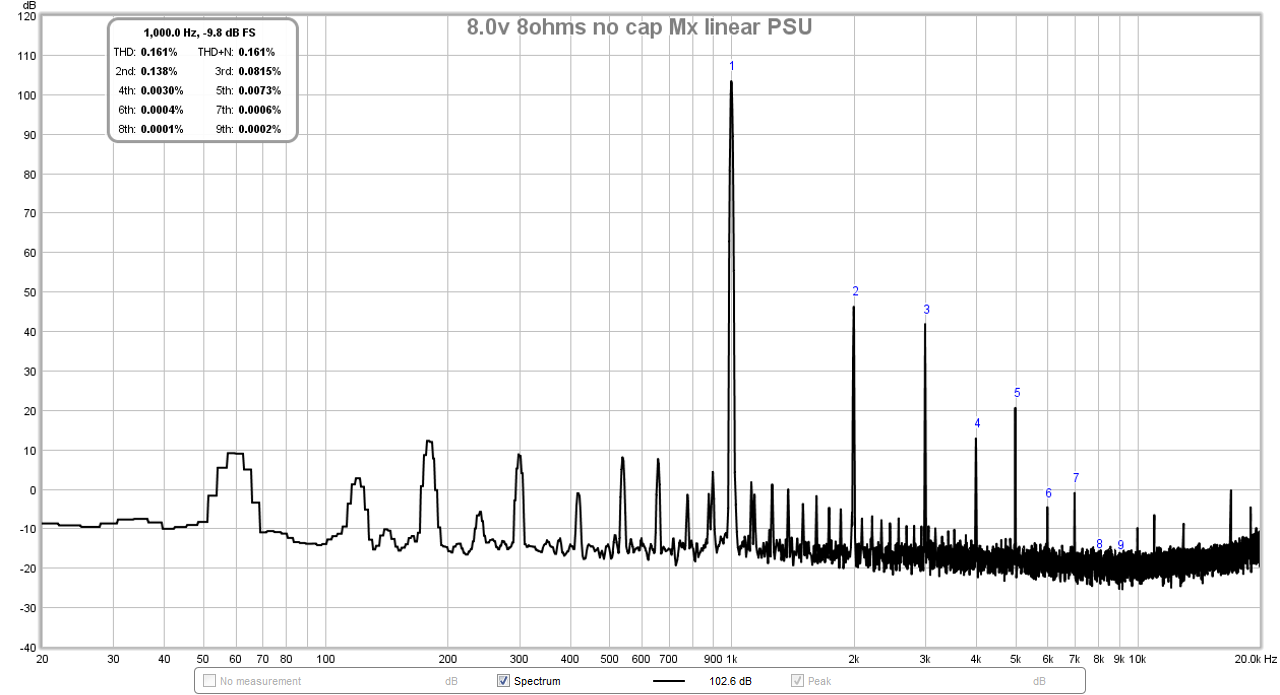

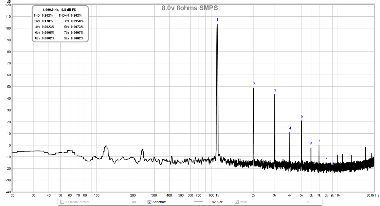

Many use smps these days, I had an older Onkyo and now the Emotiva XPA gen 3 DR series. They sport a 3kw smps!
It works very well and I even decided to re build an old class AB amp using a smps as the power supply.
Not sure it will help you that much with the mains frequency stuff though. I was thinking the same but then decided to try and measure it.
Measurements were made using a simple audio usb ADC, line in and connected to the rails via a resistor and a 100uF cap. The rails were 45 and 55 volts so the scale is sort of off. I am surprised how similar they are so maybe my measurement is flawed.
First up is a traditional supply:
Second the smps:
Second the smps:

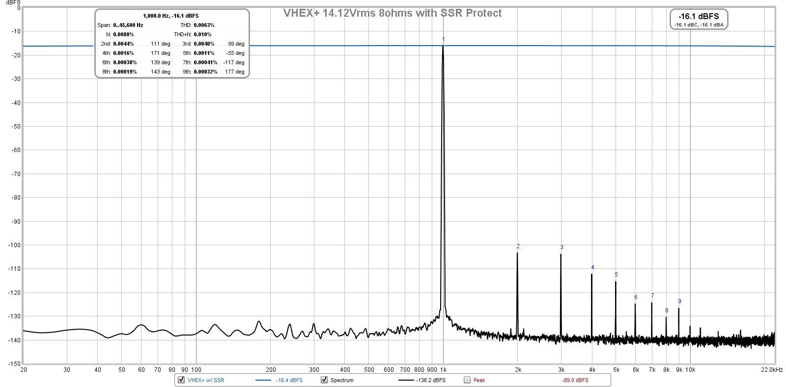

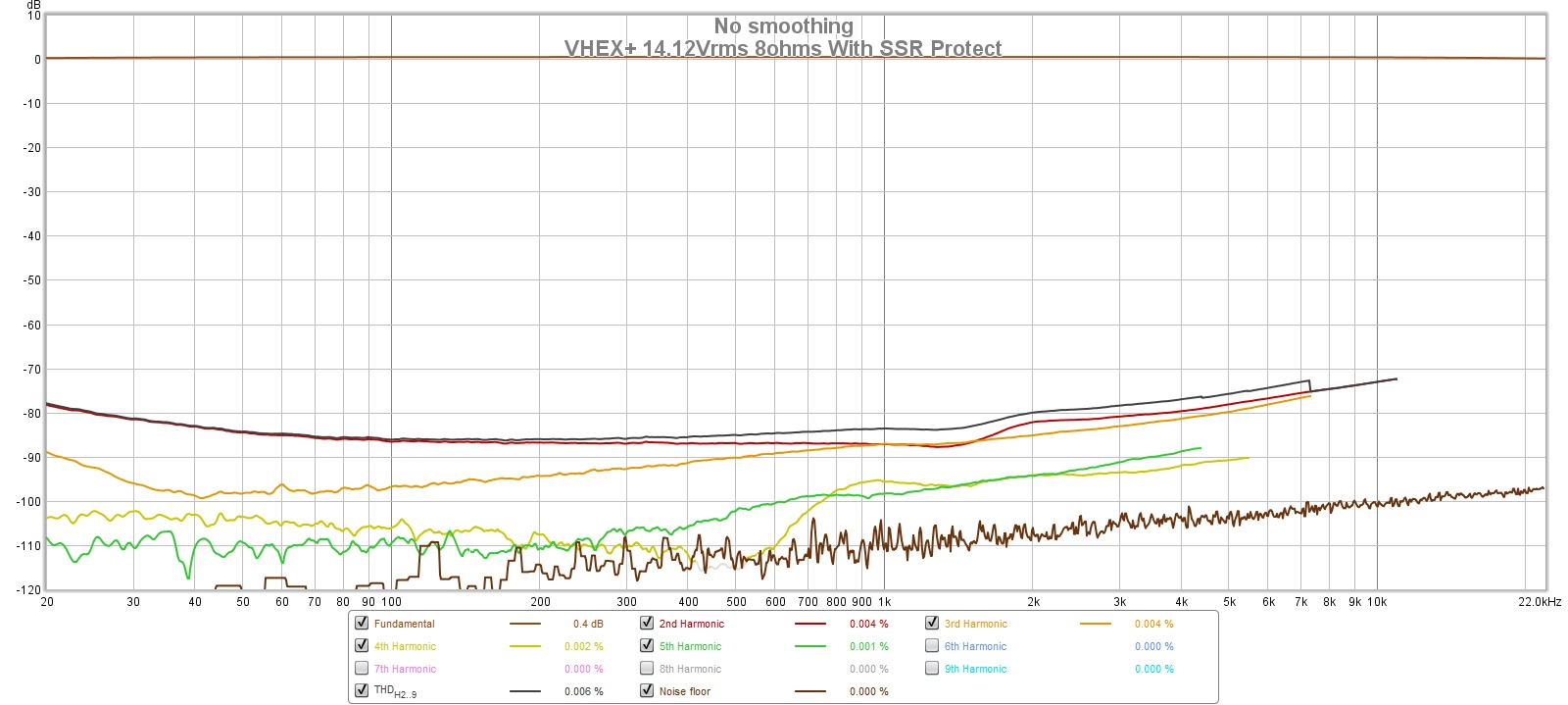

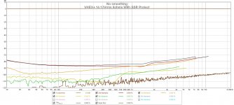

Good clean SMPS can work very well. Here is a VHEX+ Class AB amp powered with an Abletec +/-53v 450w PSU. It has a pair of CRC’s (one for each channel from common SMPS output) consisting of 4700uF // 0.47ohm // 4700uF between the SMPS and amp. A good SMPS will not have any mains (50/60Hz or their 2/3/4th harmonics) or the high frequency hash. The diode switch noise can be eliminated using an active bridge like LT4320.
This is 25wrms into 8ohms and passing through a SSR speaker protection circuit. The SSR added no distortion.
Distortion vs Frequency at 25wrms:
