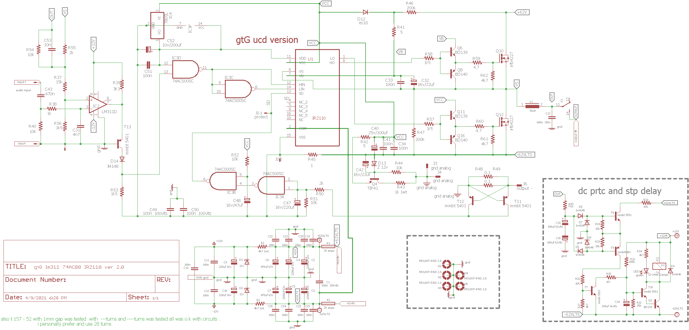

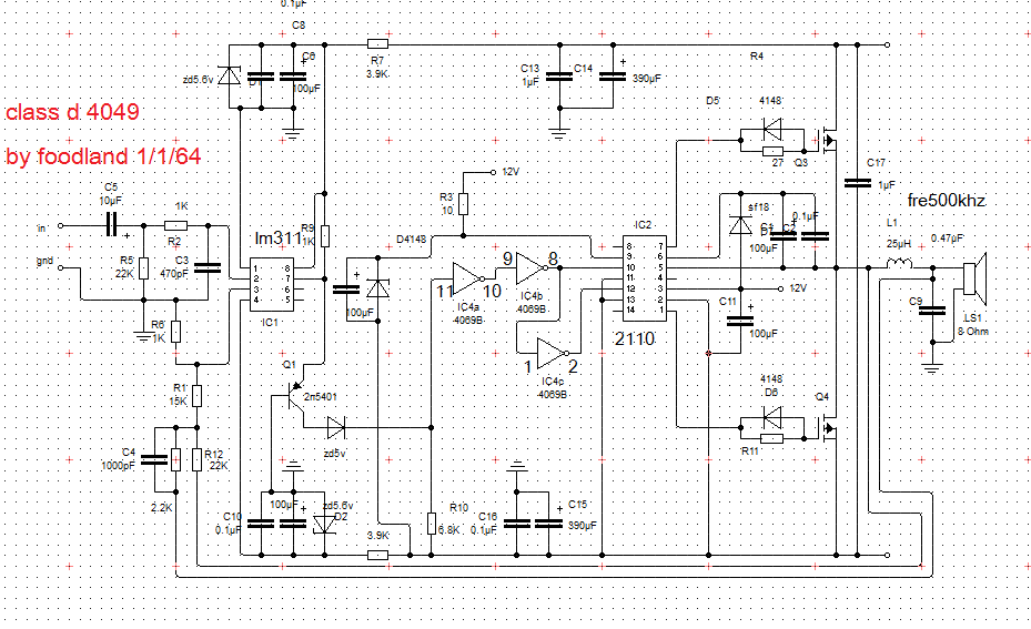

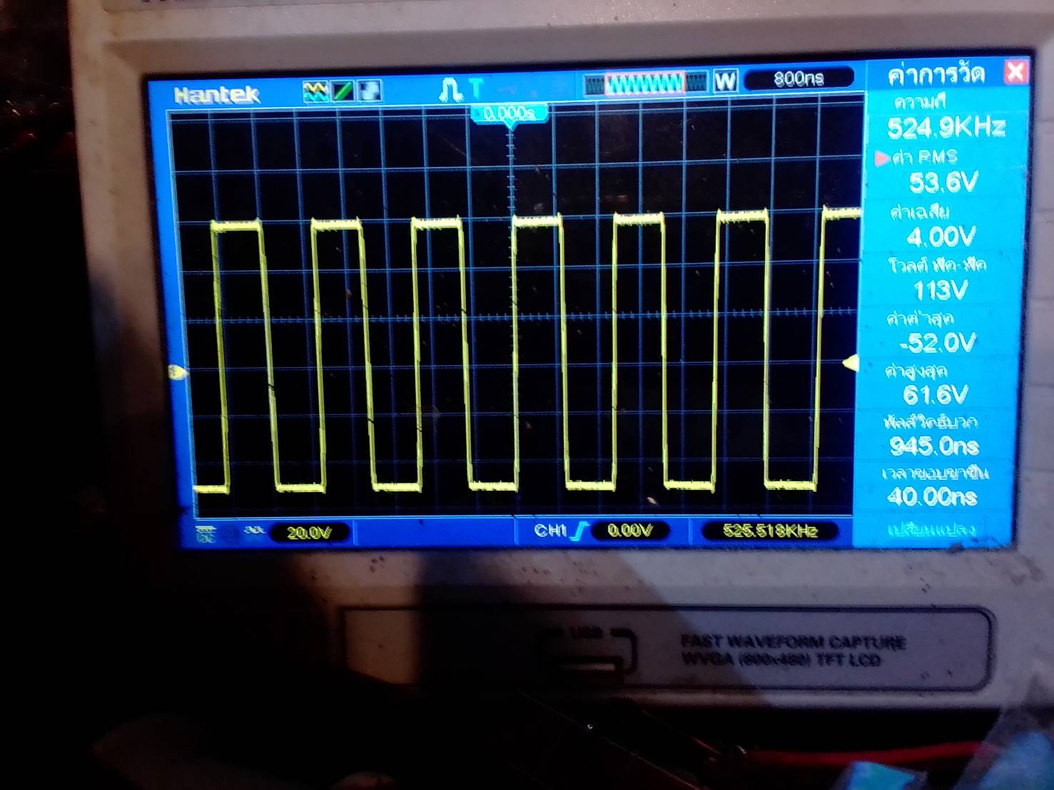

THIS circuit use not gate cd4049 +lm311+ir2110 fre cass d 520khz

which Mosfet do you use ?

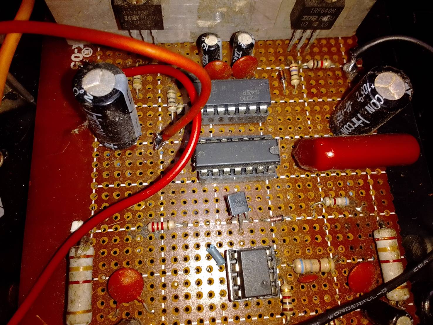

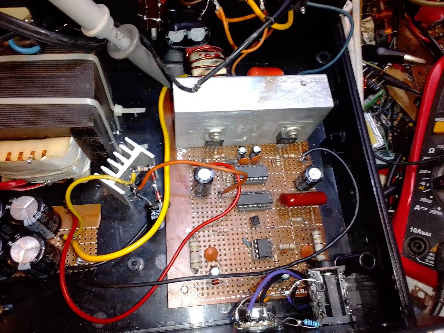

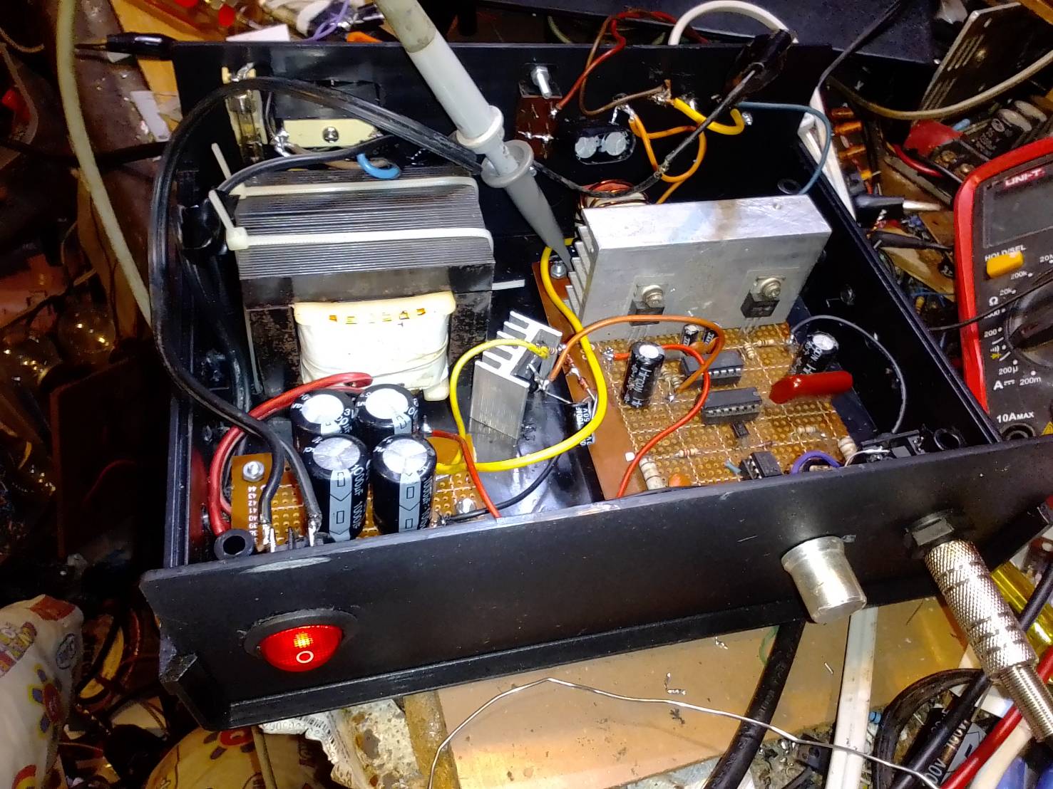

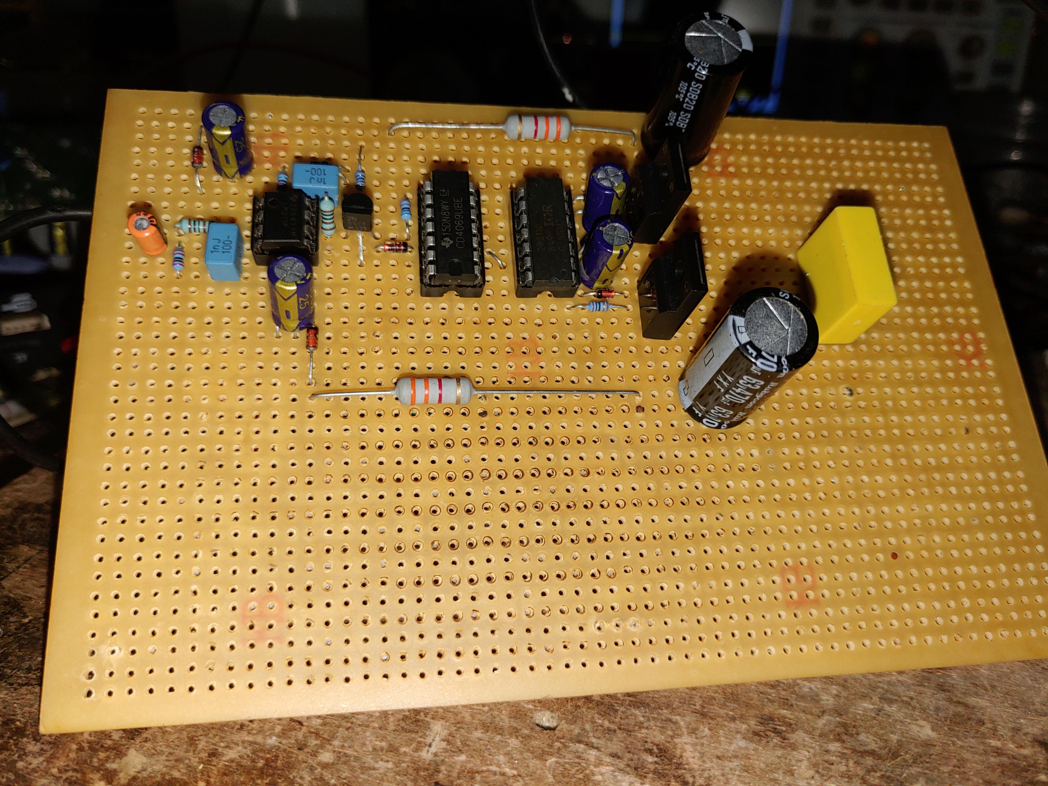

i am still doing the board layout , i have not yet made and tested it.
I tried your design. Did not turn on. Don't know what's the issue
Got it to work but fets heat up pretty high and very fast and frequency also not stable. Below 100khz.
Schematic as per your post.

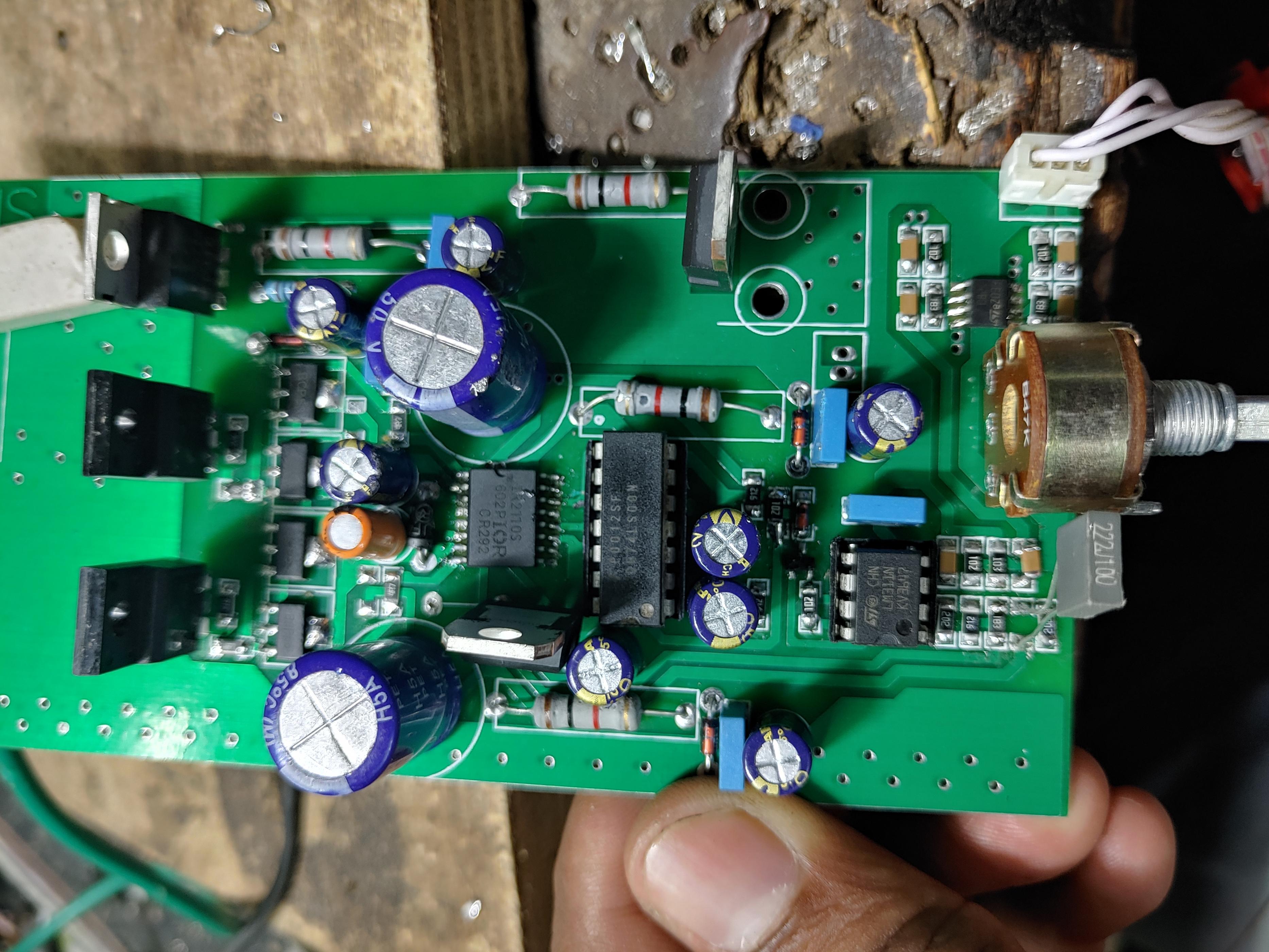

wow nice layout . what is the value of the drivers?
