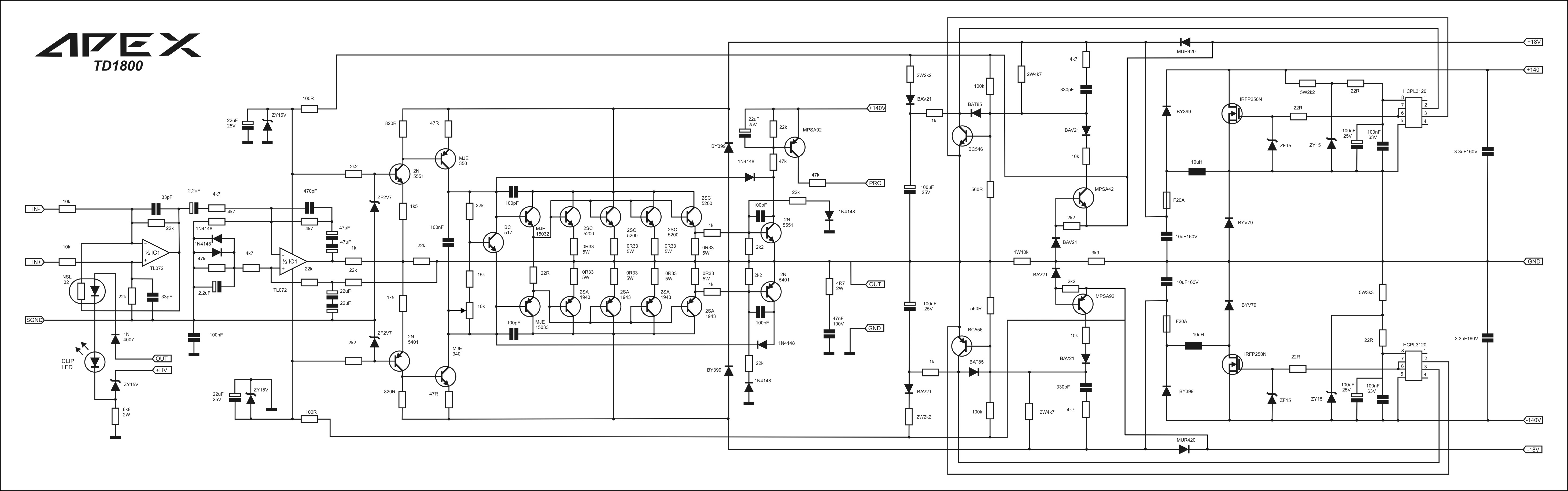

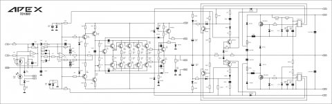

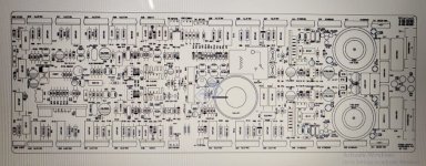

Folks,
I post class TD schematic. It is based on the only famous class TD.
This is not yet trial. Layout is not yet available. I bring new idea for gate supply, and more simple design suitable for DIY audio pro enthusiast, dreamer for big muscle amp.
Sorry small mistake, R126 is not 27K. but 18K
Kartino

Hello Kartino
greetings after long time almost 18 months after surgery i copied a very
reliable TD class but now i cannot get pcb from china anymore i will chat
on FB
warm regards
Andrew

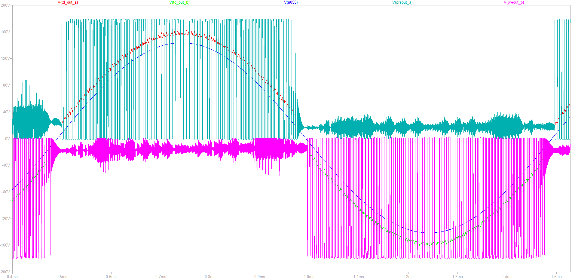

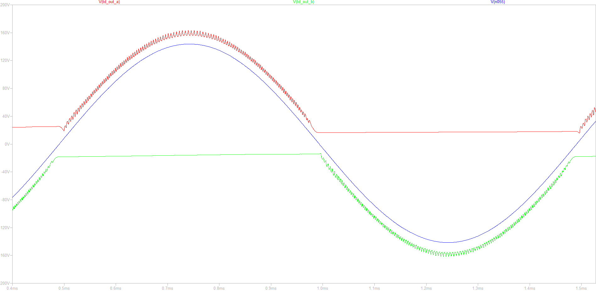

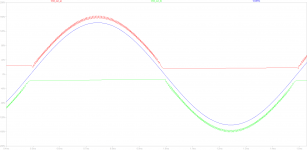

TD design decoded 😀
You will understand from the PWM card. See my PDF, I put converter in one page. It is a self oscillation in a LTP. Comparing the amp out and prefilter signal.

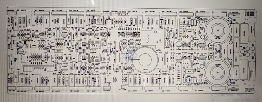

Hello Kartino
greetings do you have this layout schematic
warm regards
Andrew😉
Dear sir can you share this layout my email id is techhry@gmail.com
