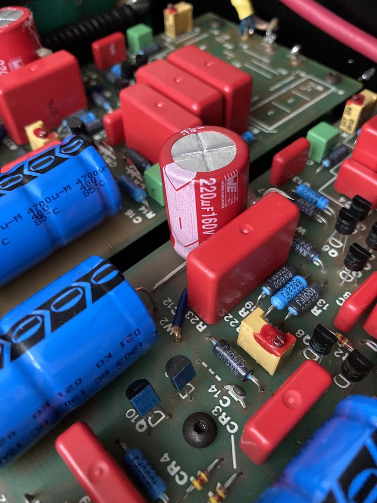

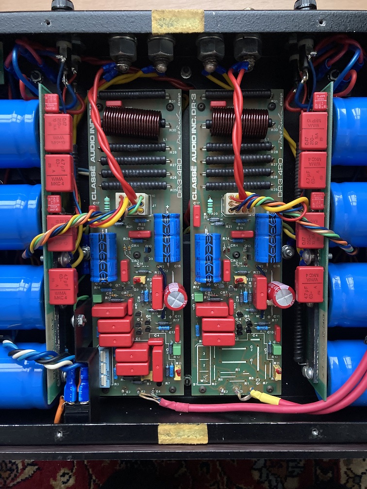

Just finished calibrating one of Dave Reich's classics the Classe A(udio) DR-3 power amplifier.
A technician had serviced this amplifier for a friend of mine because the railfuses kept blowing when the amp was turned on.
It took the technician quite a while to source new Darlington TO3's powertransistors and with a service manual I supplied to him with clear instructions which substitute axial caps he should use, which he didn't, because two of the caps (the red radial caps) he just took from his shelf it seems...
https://www.diyaudio.com/forums/attachment.php?attachmentid=993208&stc=1&d=1635346761
After months the amp came back and it sounded awful clinical and harsh. Eva Cassidy had a very unpleasant ringing to her sweet voice which gave me literally a headache. My revised McIntosh Mc-2205 which I swapped for the DR-3 was, although sounding somewhat dark and flat on the Y axis (less depth in the soundfield), much more tolerable than this DR-3.
The technician did not calibrate the amp, which is necessary after a repair where all the powertransistors are replaced. He just turned down the biastrimmers to a intake of 75 Watts making this amp effectively a Class B amp in most listening situations.
This amp was designed to compete with the Krells and Levinsons (ML-2) of its time and now it was reduced to just a mediocre performer.
With the elaborate service manual I managed to get the music "back"
I took hours to finetune it because of the two biastrimmers and two DCO trimmers.
Now the amp takes 2 amps AC from the wall and the energy meter on the Variac says I waist 480 Watts every hour...
